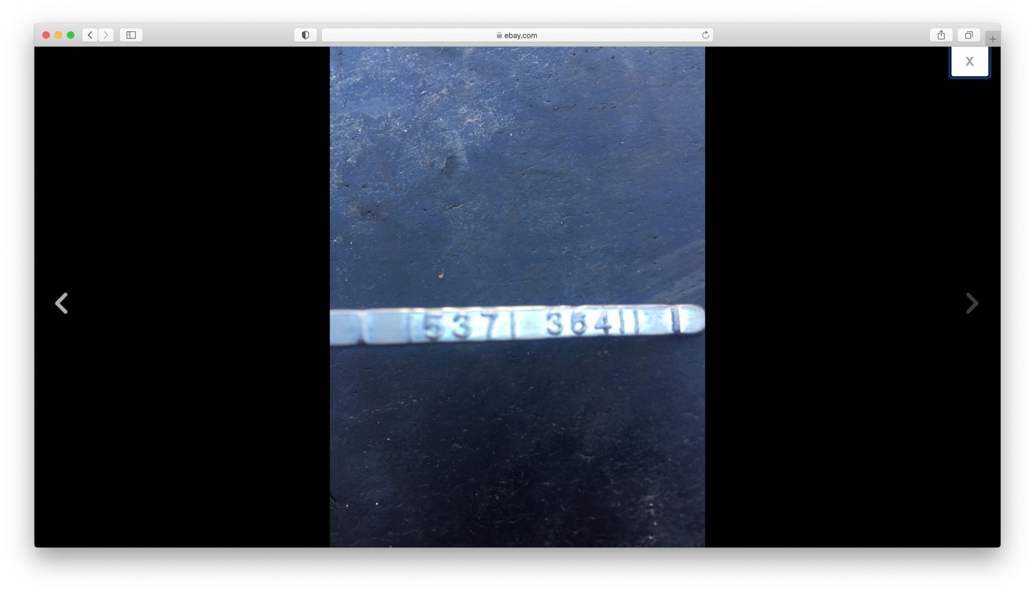

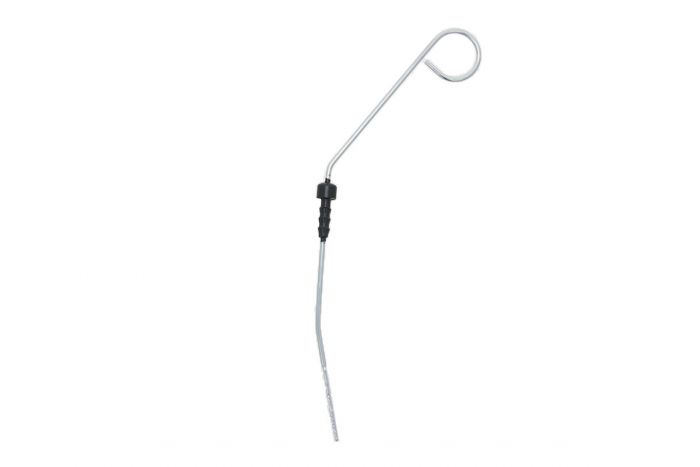

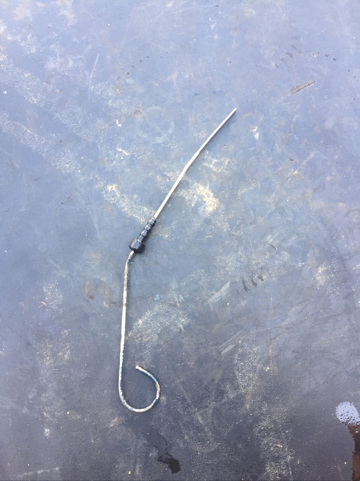

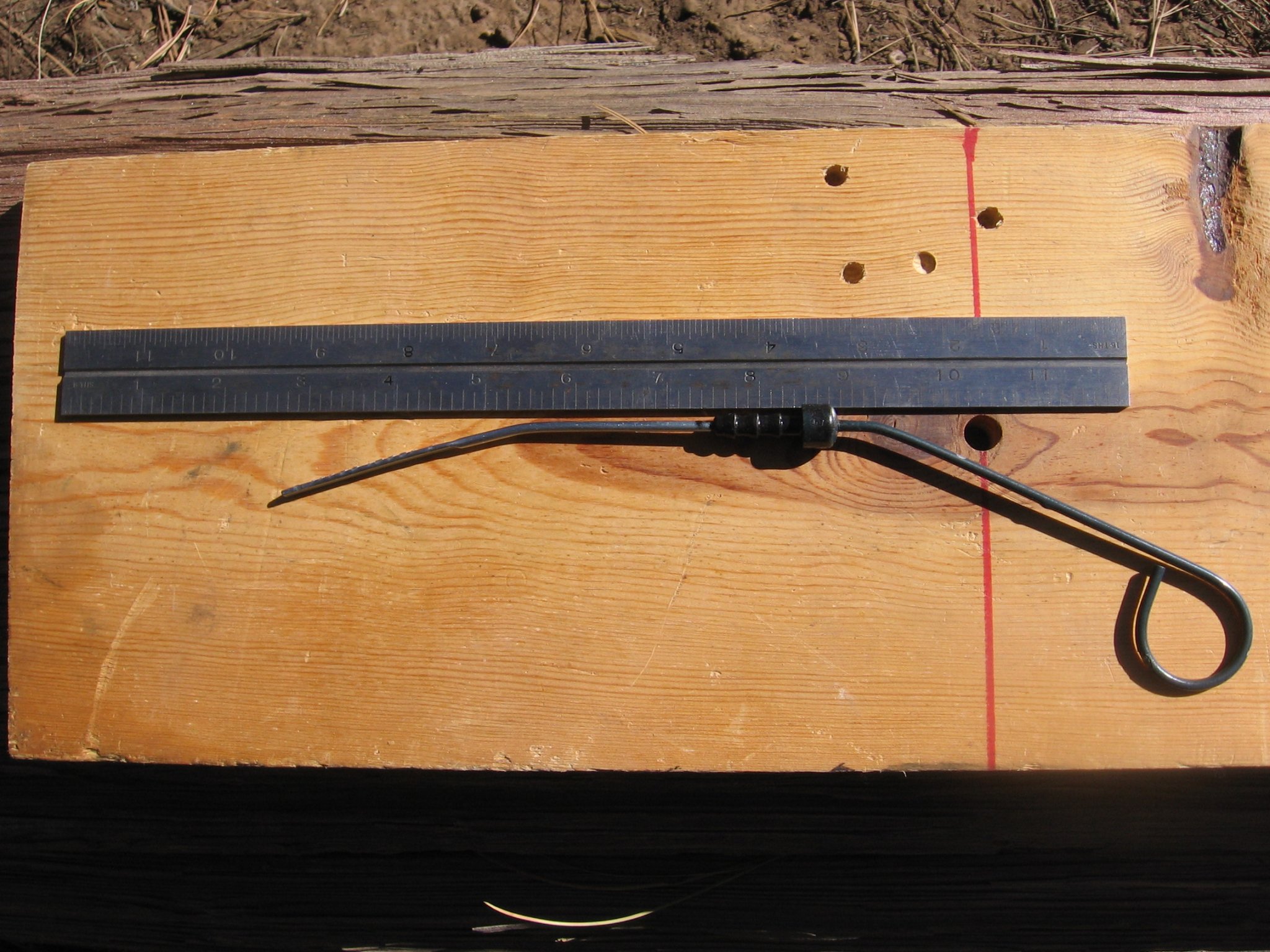

I was checking the engine oil in my B7100 when the previous owner stopped by to chew the fat. He saw the dipstick and said it should be straight, with no bends in it. I told him he must be mistaken, the stick had two bends in it since he sold it to me, 7-8 years ago. He insisted, so I did a search, and found he was mistaken. All images I found look like mine. So I'm posting in case anyone else has the same question. 1st pic is mine, part # 1537136411, other pics are off the net.

AS you can imagine the bent part will go down and be somewhat vertical to bottom of the pan.
The loop typically points away from the block thus making the bent part tuck back away from any moving parts.
