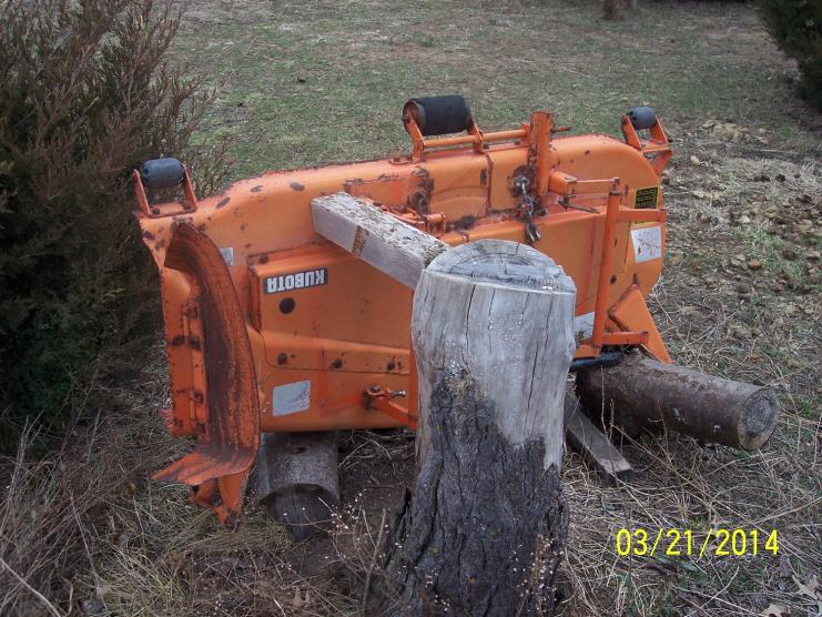

Here's a 60" mower off of a B8200 gear drive. I bought it in '85. Been mowing probably less then 100 hrs. Been in a shed for 20 years. Set it out here when I replaced the shed.
