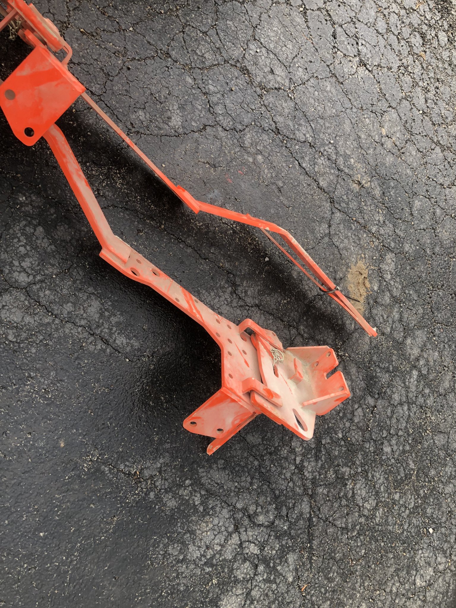

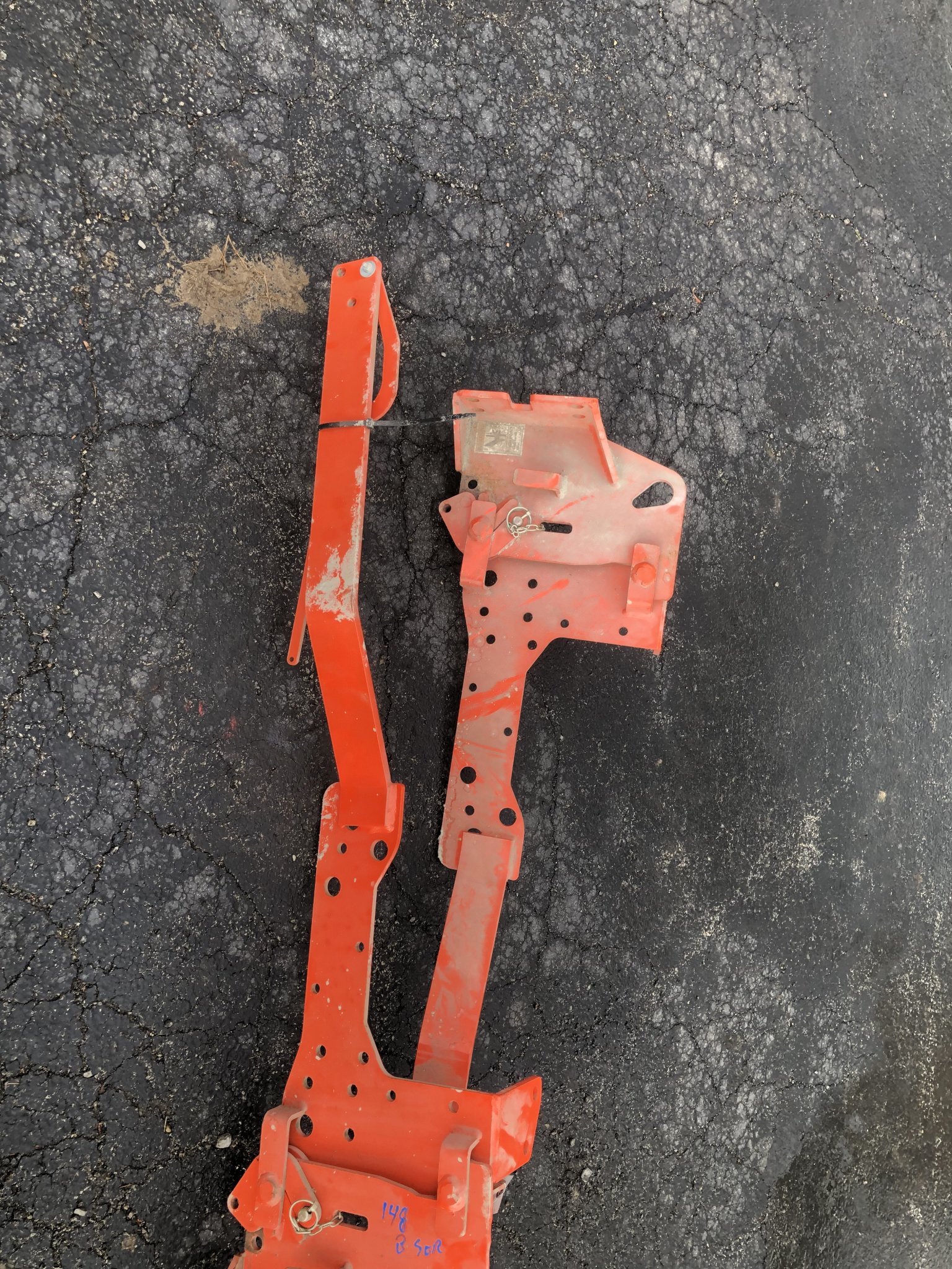

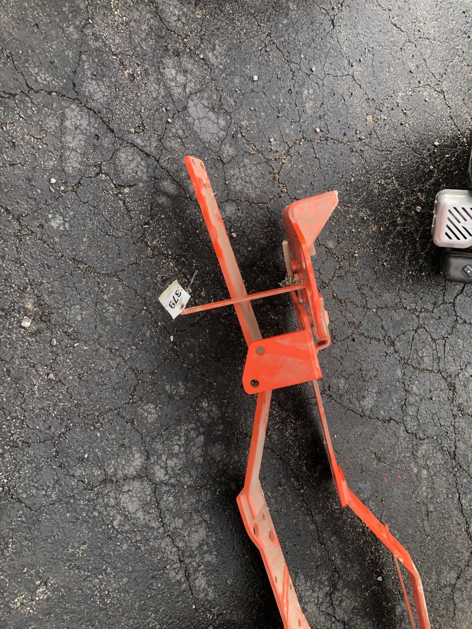

You may be right. The hoe came with a subframe from an L series which is wider than my b frame but at least I have metal to work with. Just gotta figure out the best way to narrow it and still keep the original mount points on the hoe. Thank you
