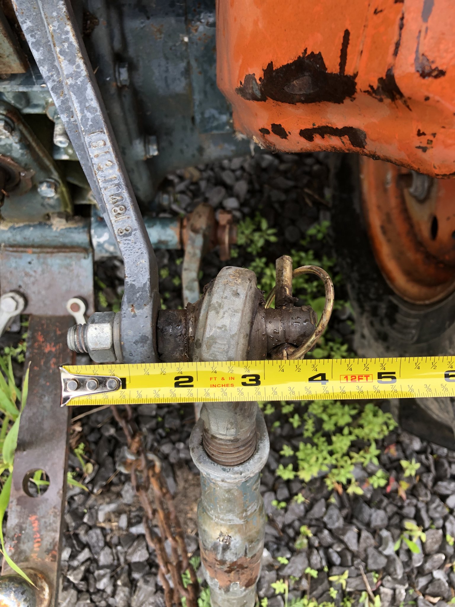

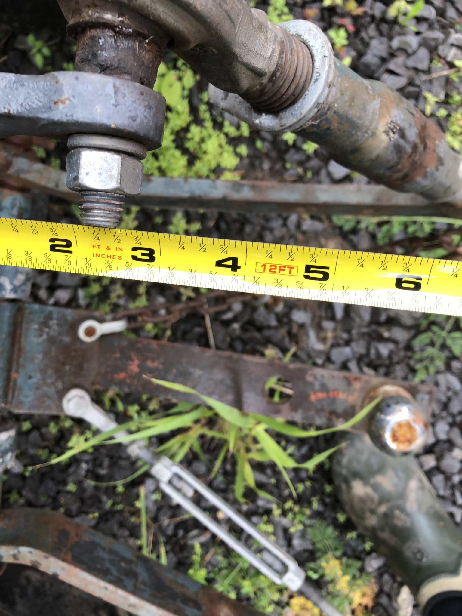

Thanks, Wolfman. Hopefully the steering parts I’ll need will this time are the same as B7100D’s.
BTW I’ve found that the upper TPH arm pins are also different between B7001 and B7100.
29,360
5,646
Picture?
