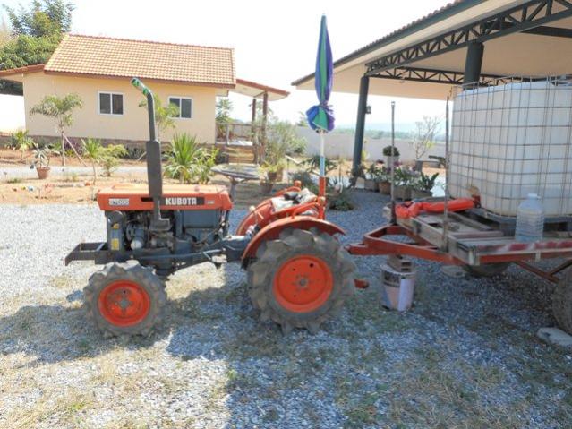

I was wondering what the tube was that was running up the back,:confused: Umbrella holder, it was odd to see,:p but oh well I guess if it works then great! :D
Zero cost shade from the Thailand sun. Wife found the umbrella in the barn. Blue pipe is to limit the rattling around. Works great.
Oh I get the shade thing I lived in the Arizona Desert for 21 years, no shade means dead!:D

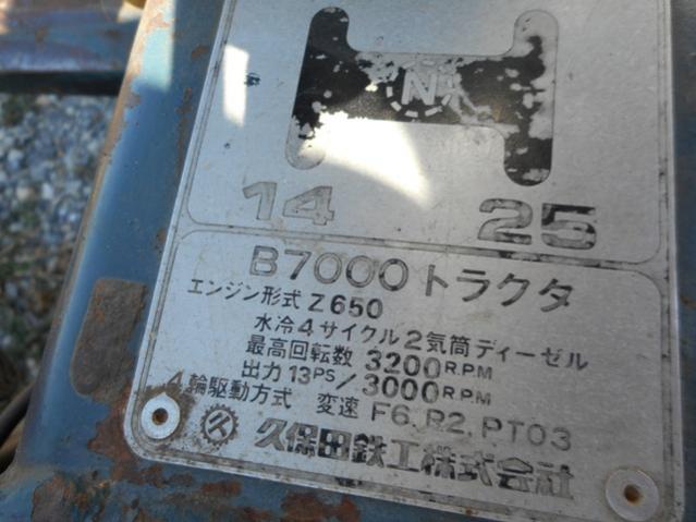

Info plate says - guessing here on the translation - 3200 RPM max? and 13 ps (HP?) @ 3000 RPM guessing again that is the PTO power? Main question is how do I know the RPM's w/o a tach?
