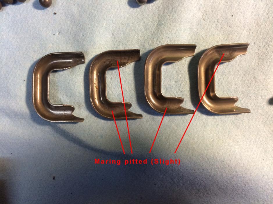

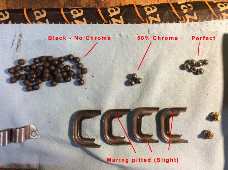

My problem is that I have issues on many of the parts with what I would call rust, marring, pitting.
There are 52 ball bearings (I thought there were supposed to be 54), and the majority (see attached picture) no longer have a chrome/smooth surface. In fact, they look black.

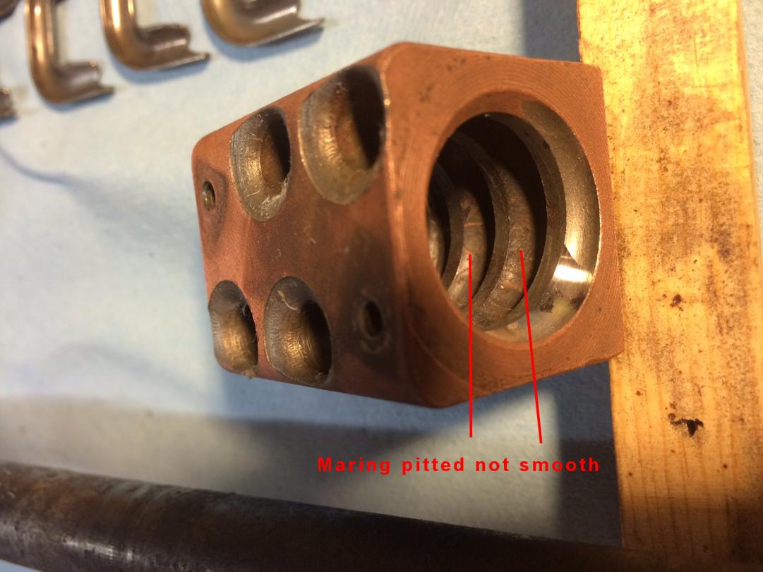

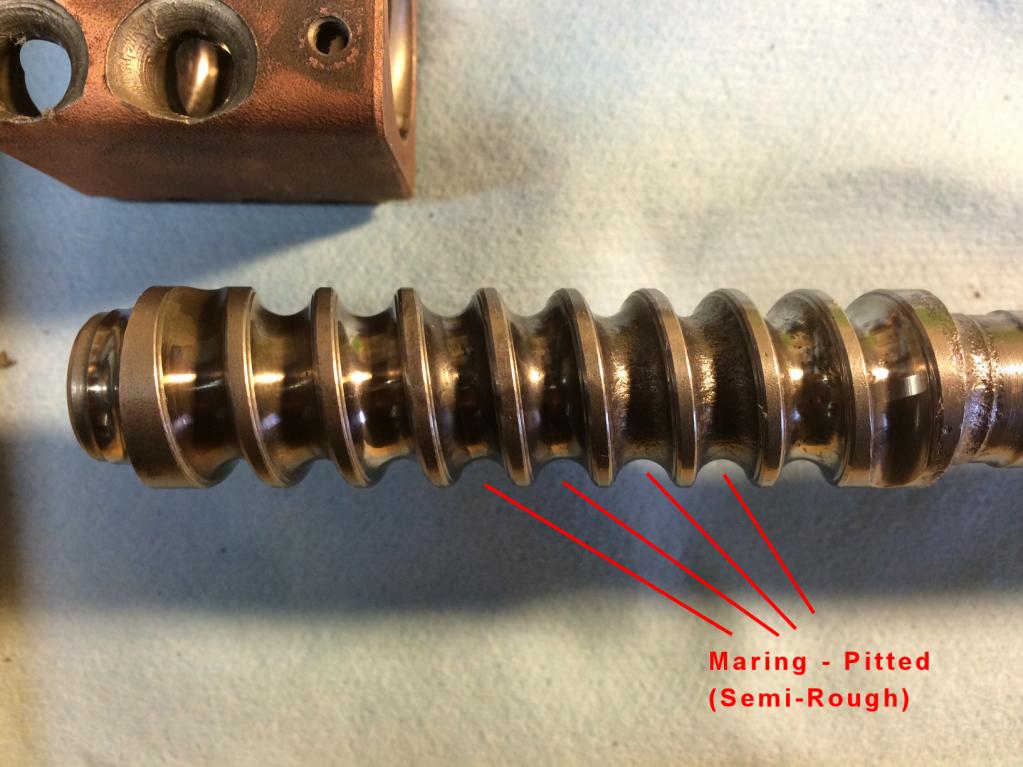

Also the steering nut has pitting inside, and the steering shaft does as well on the top bearing surface.
The simplest thing to do is get a new nut/shaft combo (I already have the rebuild kit for the box), but I was wondering if there are any stop gap measures that I could implement instead of a replacement.
The steering seemed fine before (even though it was mostly water in the box!), and I was wondering if I am in a place where it will last quite a while longer if I just assemble and lubricate.
Also....any ideas on polishing the upper bearing surface on the shaft?

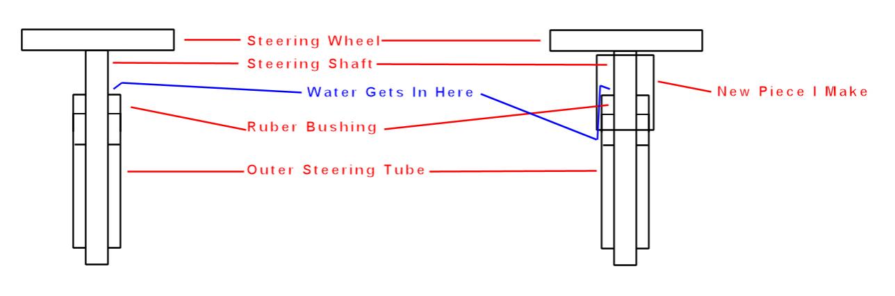

On my L1500 the previous owner removed the fill plug and inserted a large grease fitting. The entire box was filled with gun grease. I also made a bushing at the top of the column and a new seal there also.
Would something like that solve your problem?

looking at your parts, your not in need of a rebuild kit, your in need of parts!
The steering wheel shaft is shot and putting a rebuild kit in it will have short term benefits, in fact I've seen it wear new parts even quicker than the old original parts!
Buy a new shaft, block, and tubes, then put a rebuild kit in it. ;)

The shaft is supposed to be the same on the bottom, but is 1 3/8 inches longer overall. My shaft is 20", but it seems all the aftermarket shafts are either 18 3/4" or 21 3/8". So I ordered the 21 3/8 shaft, and I am going to use the extra space to add a kind of baffle to make it harder (see image).
