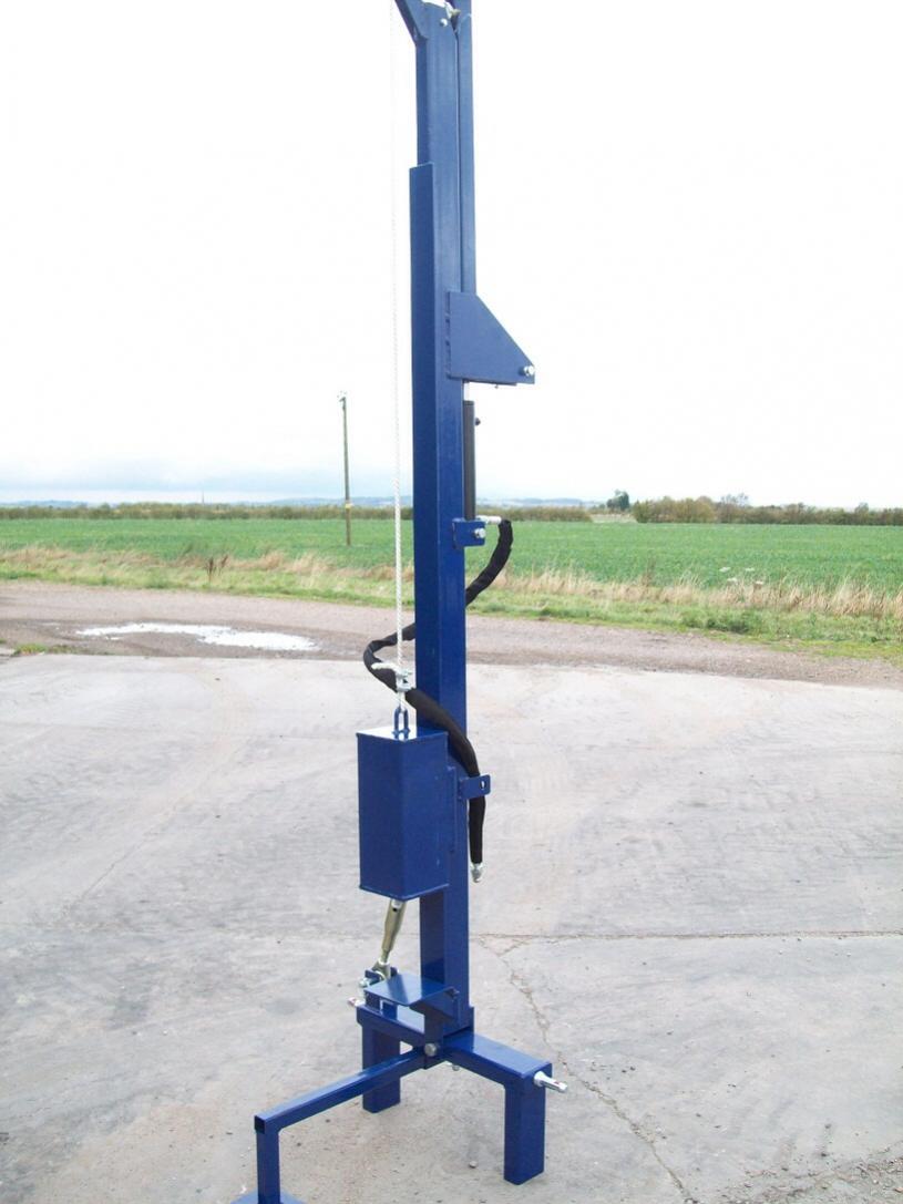

Picture attached of post knocker,do these tractors have a pressure relief valve at all , it as if it runs out of steam before reaching filling the ram properly .when I say it picks up ok I mean it will lift the knocker ok.the engine does labour as if it is really trying
28,726
5,134
Sounds like you have either the lack of proper flow or pressure.
I would need to know the specs of what the driver requires in order to answer that for you.
That is a fairly small tractor to run a post driver, most post drivers require a larger tractor.
How do you have it hooked to the hydraulics?
It could be just bypassing fluid through a pressure relief valve, tee a pressure gauge off of the feed line and see what pressure it's feeding it.

Nick, is this attachment new? The Oxdale Website says: "Suitable for smaller tractor." As NIW points out, your B may have less capacity than the knocker requires.
That being said, it occurs to me that it may be starving for fluid -- what did you do to purge the system of air?
