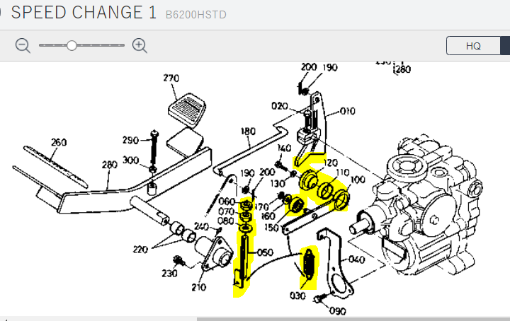

If the bearing (150) in the neutral adjust are out, will do it.
Also if the bushing (110) or other parts are worn, can do that.
A spring (030) missing or maladjusted tensioner (050) can do it.
Also if the Dampener is going bad can do it.

Thanks Wolfman,
With over 3000 hrs on this tractor one or all of those items may need replaced.
Looks like I've got some digging around to do.
The WSM will be a huge help.
