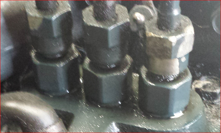

Recently acquired a b6100e, and when giving it throttle fast "pulling the lever or pushing foot pedal" it is slow to rev, when using high gear in 2nd or 3rd on the road on a slight incline it struggles to go faster and seems to bog and "roll coal" more. My cousin has a b7100 I think and the blip of the throttle it climbs rpms crisp and fast, seems they have the same engine. I notice one injector has a slight leak and I think the lines going to the injection pump 2 are leaking, would this be a possible cause?

I will be checking that sometime this week, thanks for the reply, when taking apart the injectors will there be a copper washer, or runner o ring in between as a seal?

You mean you want to take off the feed tubes that are on the top of the injector pump??
There is an O ring than can be replaced. - The middle one is the beauch!!!
7,167
2,597
On my L185 there is nothing to seal either en of the tube from the pump to the injectors. There is a taper that is clamped together to seal it.
If you remove the end at the injector pump you need to (must) hold the larger, lower nut so it doesn’t rotate. If it is leaking under that larger nut then you might want to get more advice on removing that nut from someone that can give you gold advice (which is not me)

Well, was able to find a fuel filter from tractor supply (can't believe they had one) picked it up went home and proceeded to install but as mention before the housing was "sunk" in, filter wouldn't fit back in. Grabbed my heat gun and slowly warmed up the plastic housing and slowly pushed the filter in. Bam! Put the filter assembly back on, cracked the bleeder screw as mentioned above, removed all air and tractor didnt hesitate to fire up, and wouldn't you know it no more sluggishness! Thanks for all the replies fellas, one more question as far as the line on the injection pump the bottom fitting is leaking pretty good, anything special I should know before removing it?
