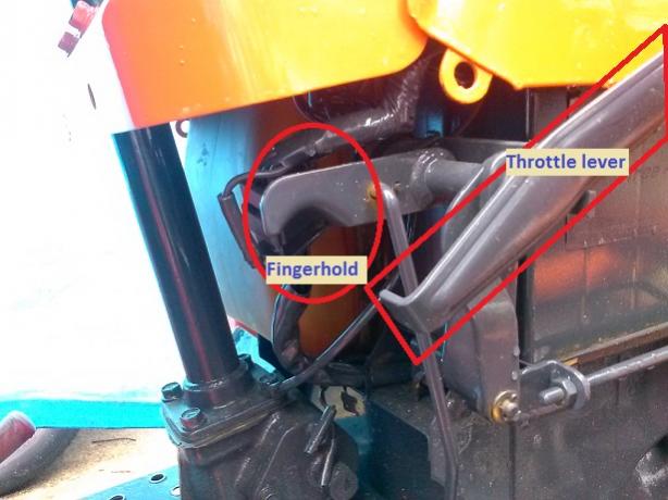

Chuckleins, all good advice, and in particular, D2Cat's. I wish to call your attention to his comment regarding fuel shut-off and point out the device Kubota provides. The pic (in the thumbnail below) shows a fingerhold at the end of the throttle linkage, just above the operator-end of the throttle lever. Reach down with your right hand and feel for it, just below the right side of the dash; lift up on it and hold it while your Kubby stumbles and dies. (Be merciless! :D Shutting down this way prevents damage to valves and piston-tops.)

I've got a B6100 that I'm rebuilding but I'm kind of new at this and wanting to learn. Which method of shut down damages valves and piston tops? And why does this happen?

Pulling the compression release (if equipped) to shut it down is bad for the engine! ;)
It allows cold air to be sucked over hot parts! :eek:
