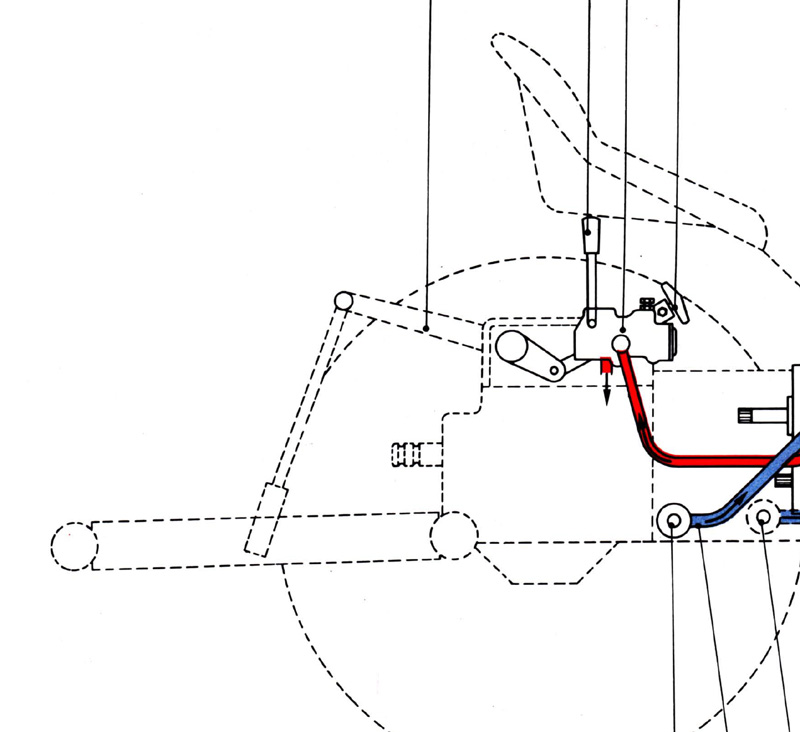

The shaft rotates two arms that lift the 3ph up when you pull the lever back, holds in place when the lever is centred and allow gravity to return when the lever is pushed forward.
PROVIDED: the valve under the seat is turned so the lever operates the 3ph and not turned to operate an accessory connected to the plugged outlet.

Pictures of how they connected the valve for the plow and it's piping would help iron it out. ;)
