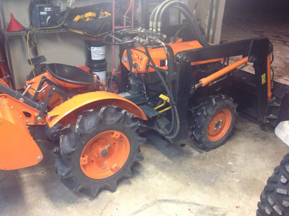

Update: The new radiator cap finally arrived today so I immediately swapped it out when I got home from work ( I have not drained and flushed the radiator yet, but still plan to do so soon). I let her run for a good 30 minutes and not a single drop out of the tube. :) Appears that was the issue after all, thanks to everyone for your input and suggestions. One of the best parts of this tractor adventure is the fact I get to learn a little more everyday. Thanks again.
I have ( attempted to at least) uploaded a pic as promised, pardon the poor quality of the pic.

Hope that's all it takes to fix it. That sure is a clean looking little fella. Brings back memmories of my 7100.
