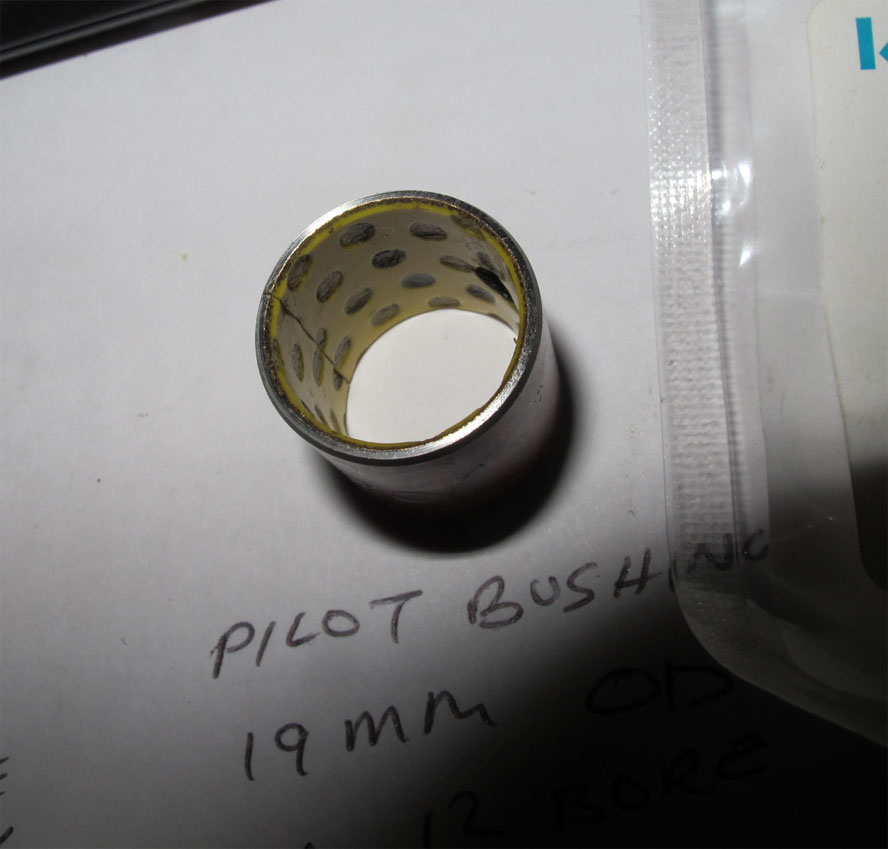

Just get a stock bearing / bushing for them to use as a reference to repair it. ;)
In other words get the correct bushing from the dealer and have the machine shop bore the shaft bushing to fit the outside of your new stock bushing.

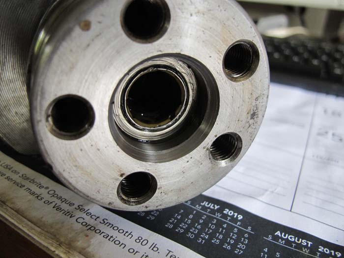

Hey guy, can you send me a picture of the pilot hole for the crank? I need one to show the machine shop what it is supposed to be. Mine has been bored out to almost 1 1/2 in.

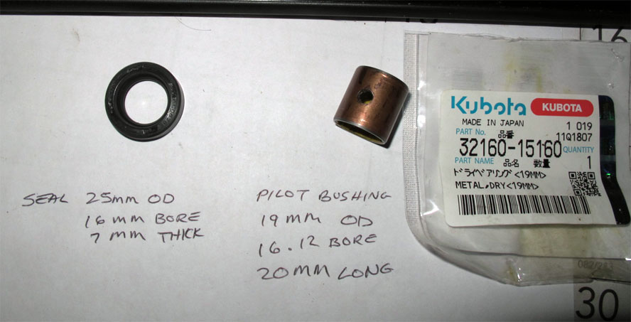

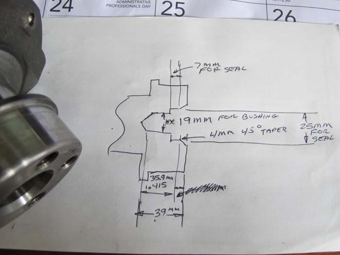

So here's what's supposed to be in there. A thin wall sleeve pilot with a teflon bore and an oil seal.
NOTE: Measure the diameter of the input shaft to make sure it's the same as the bearing in the pic. There is some discrepancy as to the correct one as two sizes are listed. The discrepancy in the parts list is shown as 18 or 19mm which I'll assume is the bore in the crank for the bushing. Therefore I may assume that the input shaft will have a correspondingly smaller or larger diameter.
Once you machine a press in plug to get back to stock dimensions this bushing will work for you assuming the bore suits your input shaft. The hole in the flywheel is smaller than the seal OD and that will keep the insert you'll make and the seal from popping out if the press fit isn't too tight.. Push a little moly grease in the pilot hole.

Don't you just love it when they think you have all the time in the world to get your project done! I bet they'd scream like hell if it's done to them. Send pics when you can, does the crank have a lip where the pilot seal goes? This one is so messed up you can't tell anything. They didn't even put the cam plug in it . What a mess it made!! No pin to hold main shaft in either so it slides back and forth . Well got a lot of work to do on it. Thanks again , Bruce

I'm wondering in your case if you just can't get another aftermarket bushing like you have and machine it to the diameter of the pilot on the input shaft + about .005" for clearance. Bear in mind that the bushing should be about 9mm recessed into the crank so you don't bottom it out on the trans shaft thus binding up the works.
