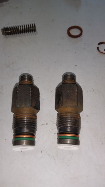

Here is b7100 seals, they consist of a copper washer and O-ring:
The seals for the delivery valves and pumps on a B6000 are a composite of brass and rubber and they are obsolete, I use a Nitrile O-ring and a copper seal to fix them.
You will note: There is no O-ring at the top of the Delivery valve holder on the B6000.
If you do not have to, do not attempt to remove the seals as doing so will destroy them.

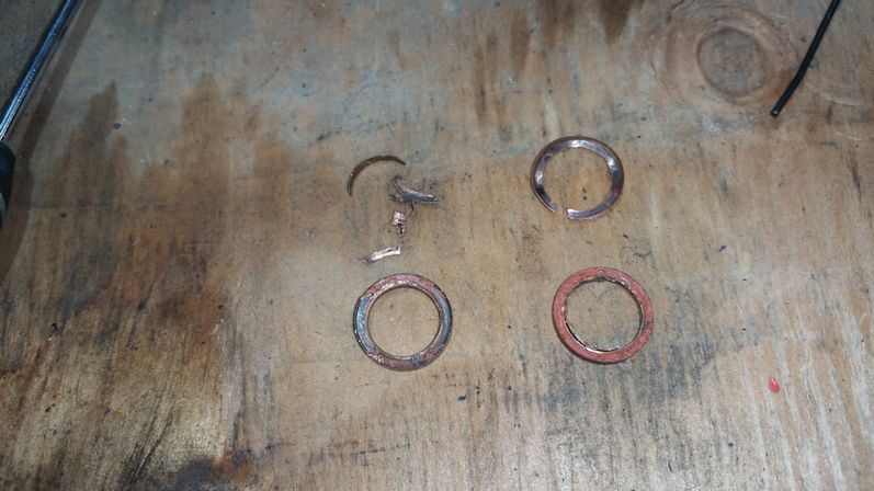

Here is the seals from a b6000 pump, yes it's destroyed.
Old seals:

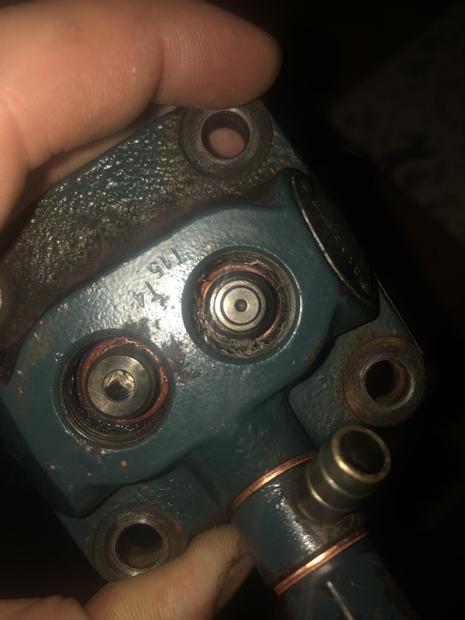

The pump layout:
My new home made seal:

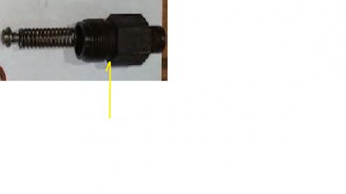

@ North Idaho Wolfman
Thanks for the detailed pics. Now for some clarification.
The first pic, Is this all that will come out when I unscrew the part? I wasn't planning on taking the entire injection pump out.
The second pic, the leak is coming from the shoulder at yellow arrow. Is there no gasket or oring here?

Wondering why the leak comes up threads, when the machine finish isn't sealing?
Now that you show me this. there was a small chunk in the orifice when I took off the injection line. Probably part of the failing oring/gasket inside.

Timing is only changed when the shim under the IP flange is changed. You don't need to remove the pump. You're working on the delivery valves on the top.

When you unscrew the delivery valve holder (part that the injection line screws to), only the spring and delivery valve will come out.
First thing to do is when you loosen the fuel injector lines check to make sure that the delivery valve holder is tight to the injection pump, if it was loose, tighten it up and reattach the fuel injection lines and recheck for a leak.
If it was tight and leaking, then remove the delivery valve holder, remove the spring and the delivery valve.
Inspect the seal under it, it should be a nice and shiny brass seal if it's damaged it's going to need to be rebuilt, (not super easy on that model and not easy to explain as there are several adjustment made to the pump to make it work right.
Send me a PM and I can help with the rebuild.
If the seal is not damaged then you can add a .01 thick copper washer to it it get the delivery holder to seal.
Timing of these pumps is done internally and via shims under the pump.
There is no gasket or seal at the top shoulder of the deliver valve holder of this pump, it all seals at the bottom seal, and no you can not just add an O-ring to get it to seal. ;)
