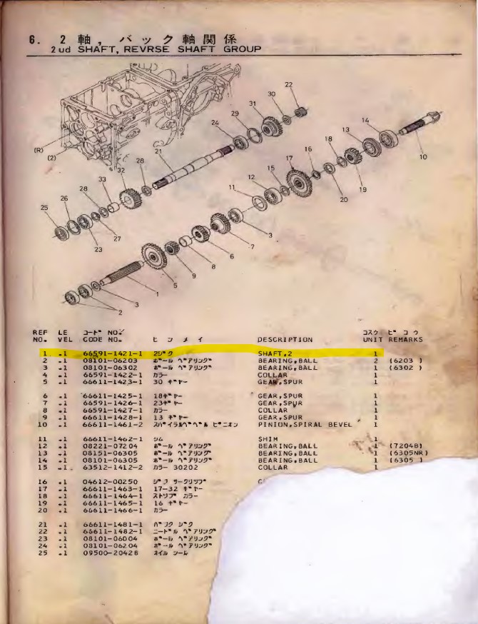

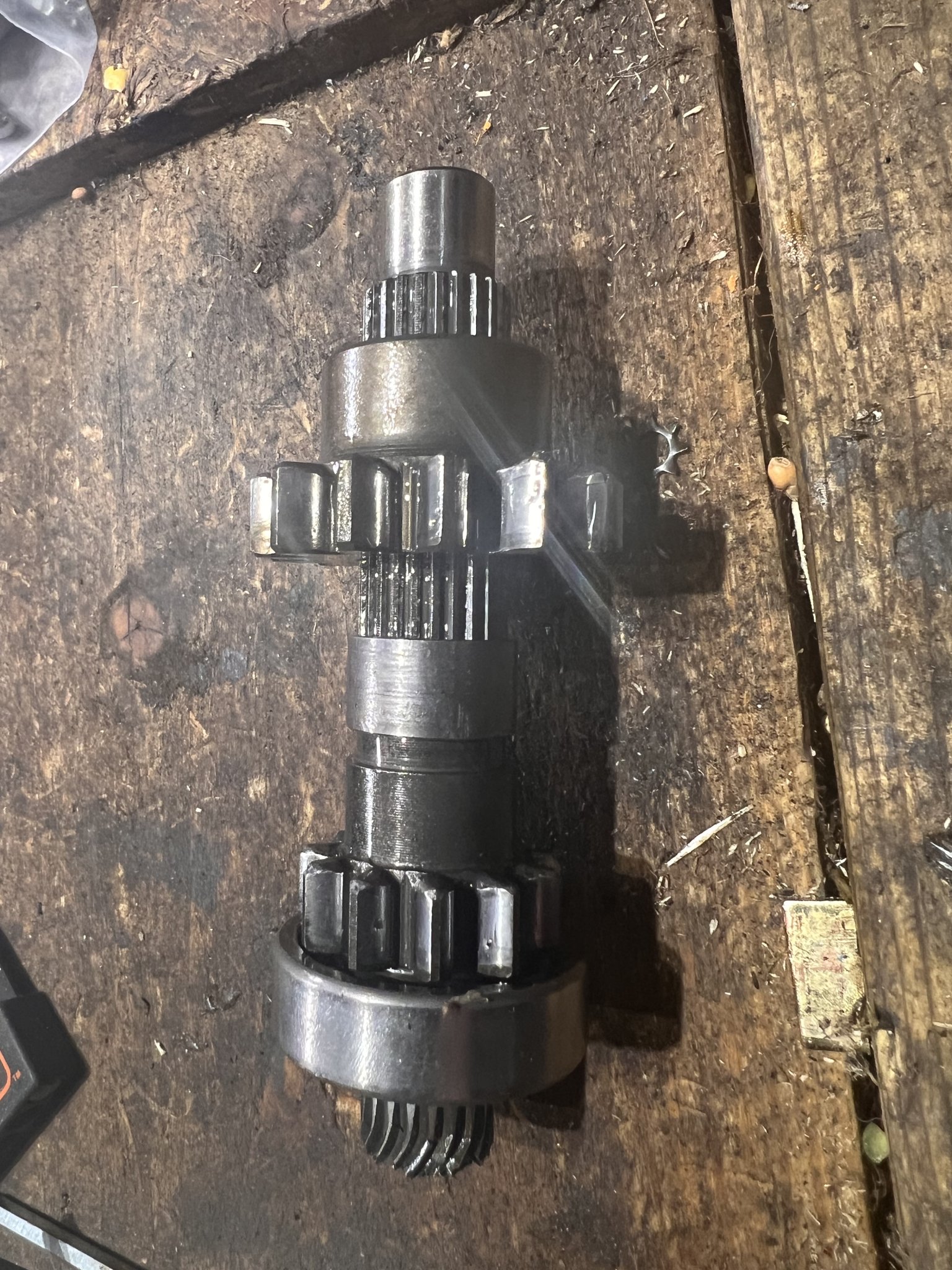

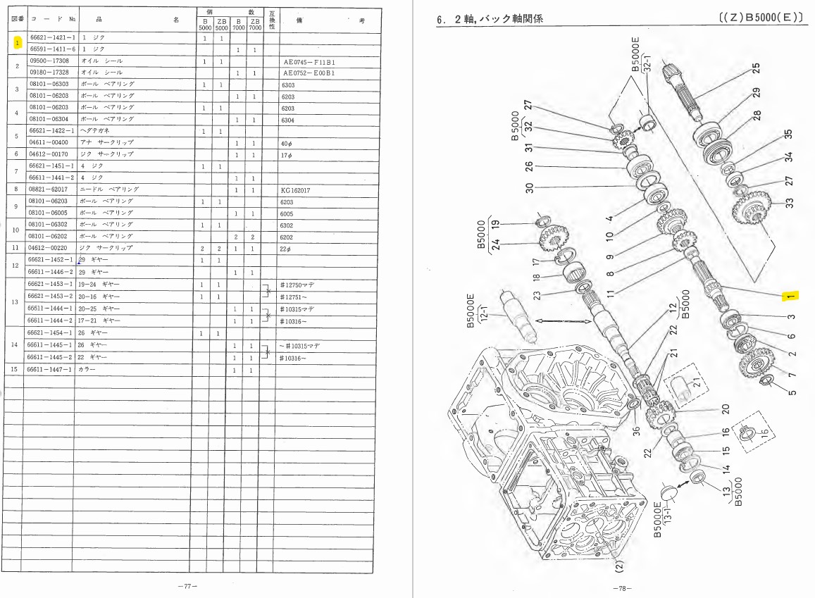

So I have split the tractor at the gearbox end! here's what I have discovered.
Now What next? I don't even know what to call the shaft that's broken.Any help greatly appreciated.
Neither is from an exact manual for your tractor, but similar.....
From a B7000 Parts Manual
From a B5000, B7000 Parts Manual
Hope this helps a little.

Ouch, that's some serious damage!
It's very possible that something else is jammed up or broken to make it twist a shaft like that.
