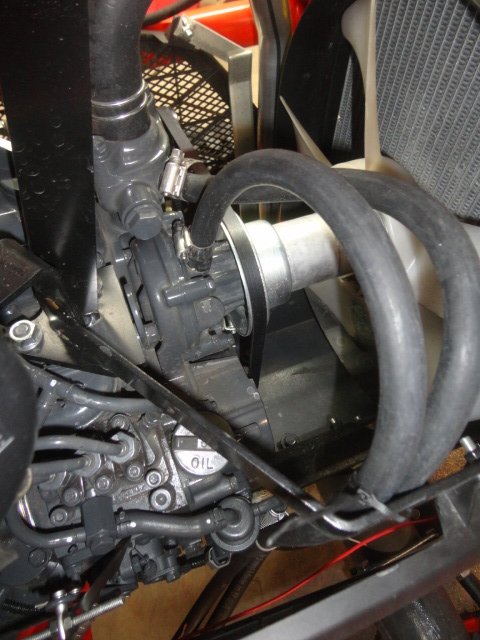

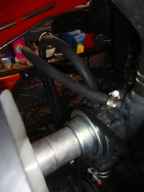

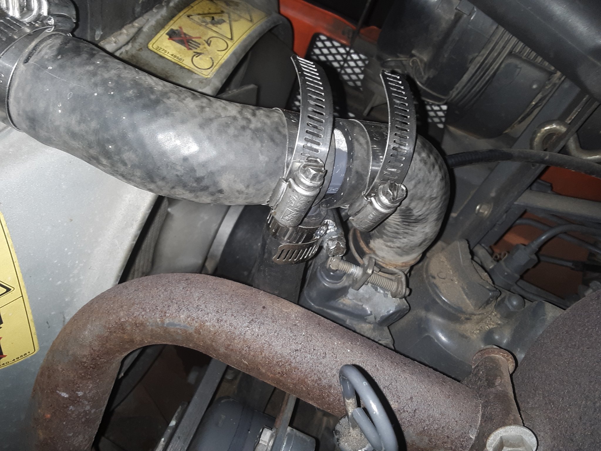

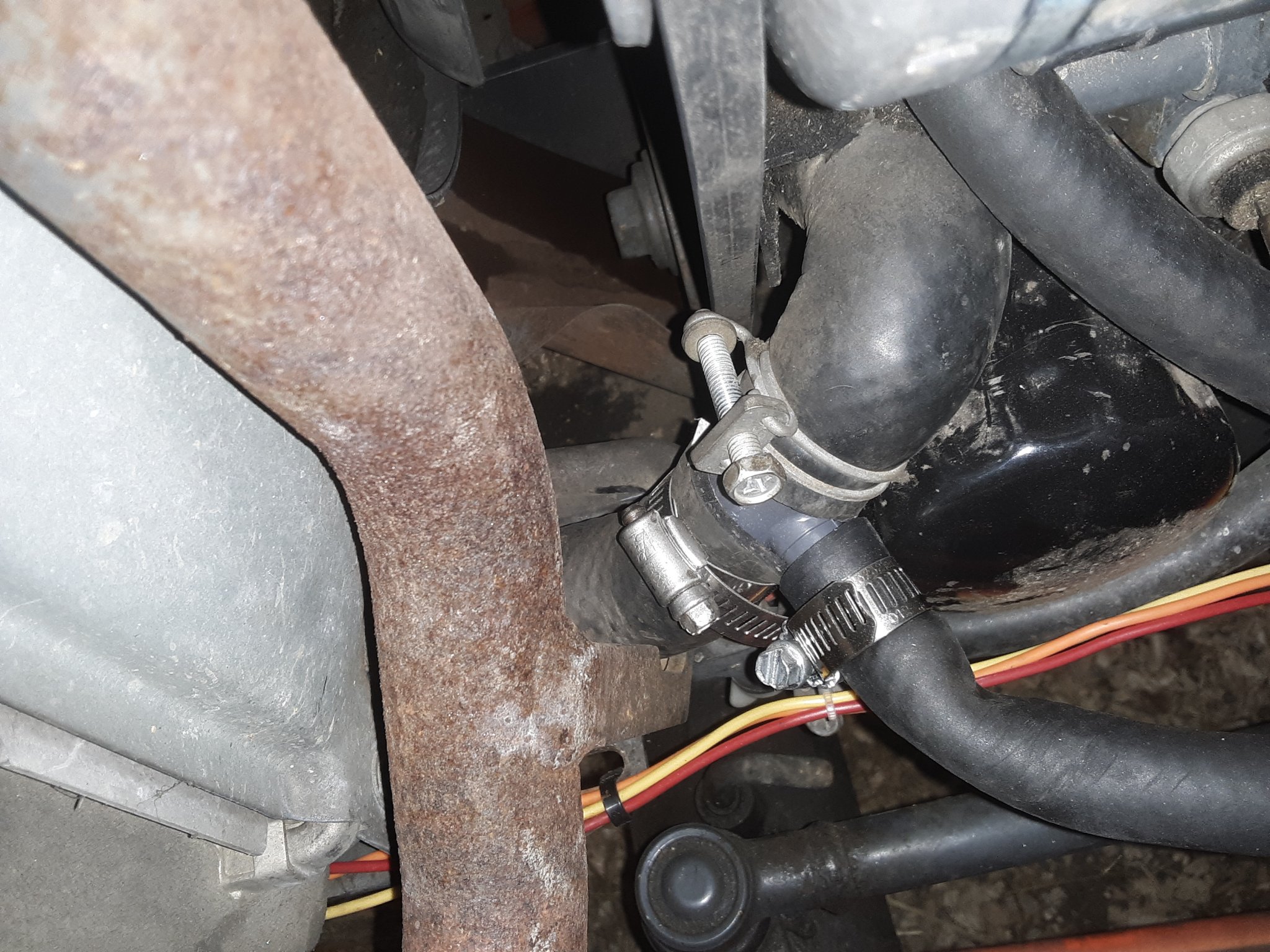

I found these pics in some files that should show you how my hookups were made. They aren't very explicit, but I can take some better ones for you if you'd like.
In the pics you'll see two hoses installed. The small, short and curved "water pump bypass" hose has been removed from those two fittings. I believe those fittings were just 3/8" barb fittings. One on the water pump housing and the other on the thermostat housing. Once that bypass hose was removed it was replaced with the two hoses shown that run down and out over to the cab heater.
My Jegs heater hose fittings were made for 5/8" hose. I ran short stubs of 5/8" heater hose to the outside of my cab and then with barb reducers continued on with the 3/8" hose. The smaller hose was much easier to rout and hookup to the bypass location. And there's been plenty of flow to supply the heater.
When I install the cab each fall: I drain some coolant off the radiator via the drain plug. Remove the bypass hose. Before I hook up the heater hoses, I'll fill the heater core up with coolant by using a small funnel in one hose. Holding both ends up higher than the heater while filling until the coolant shows in the open hose. It takes very little coolant to fill the heater core. Plug one hose end while quickly attaching the other. Remove the plug and attach the final hose. Only a few drops get spilled. It maybe isn't necessary to do it that way but it seems to work.
Hope these pics help, On your tractor, look for a short curved hose on top of your water pump that's only 5" long +/-. That'd be your bypass hose.
Let me know if I can take better pics for you.

Alright I may have put in wrong but this was per jeggs installation I'm confused but gonna figure this out one way or another lol but still cold.
ruger1980
L4310 w/La682, L225
Oct 25, 2020
358
125
CNY

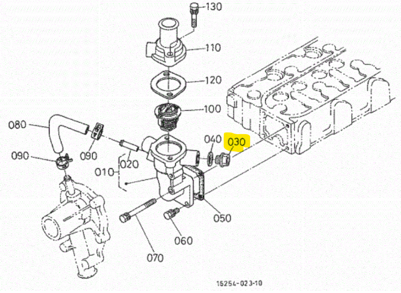

The hose to the lower radiator hose will be fine. The hose to the top hose should be moved to the thermostat housing.
I would remove the plug shown as item 030 below and find a nipple that will fit into the opening.
Ikc1990
Kubota m125x, m9000, b2710, and other equiptment
Dec 2, 2020
292
130
Vermont
Great thanks for the help everyone I'm going to try that, and replace thermostat at same time to be safe, and then see where to next. Hoping to get it fixed looks like some seat time with storm coming In and a foot of snow or more, wind blowing like crazy tonight.

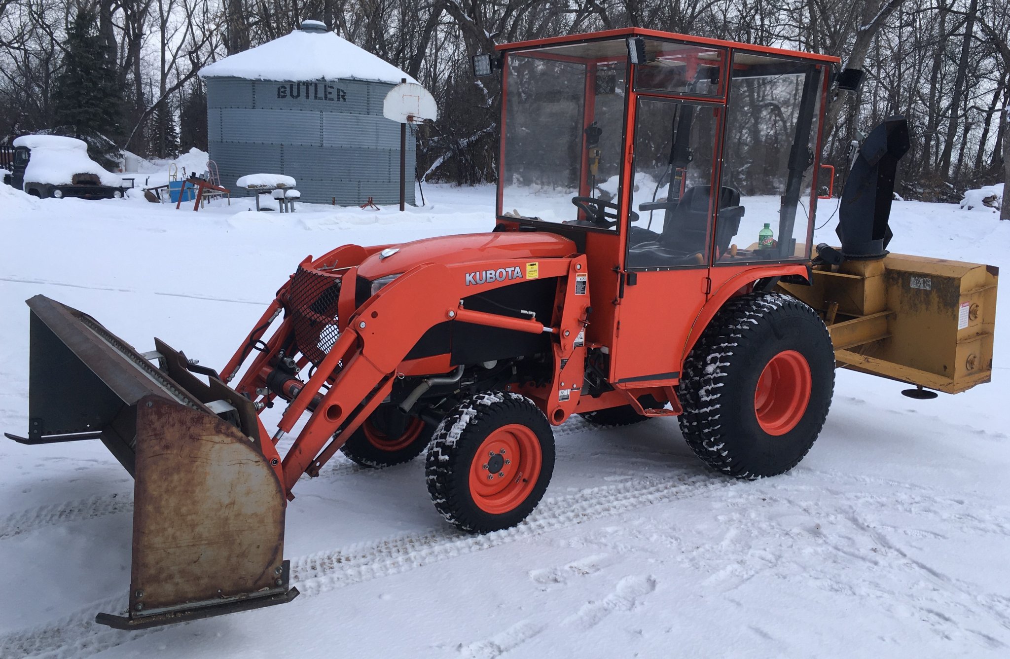

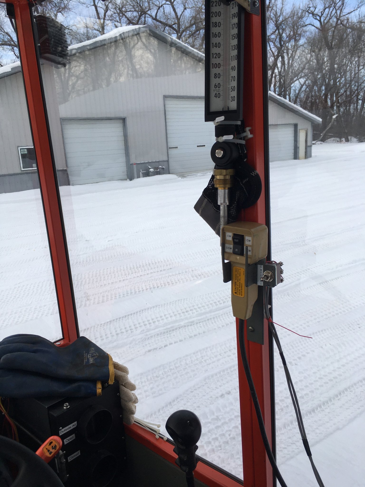

I just finished moving some snow with the rear blower and thought I'd post some info and pics from today regarding the same:
Outside temp was +10° F today.
All three of my winterfront covers were on (front + two sides)

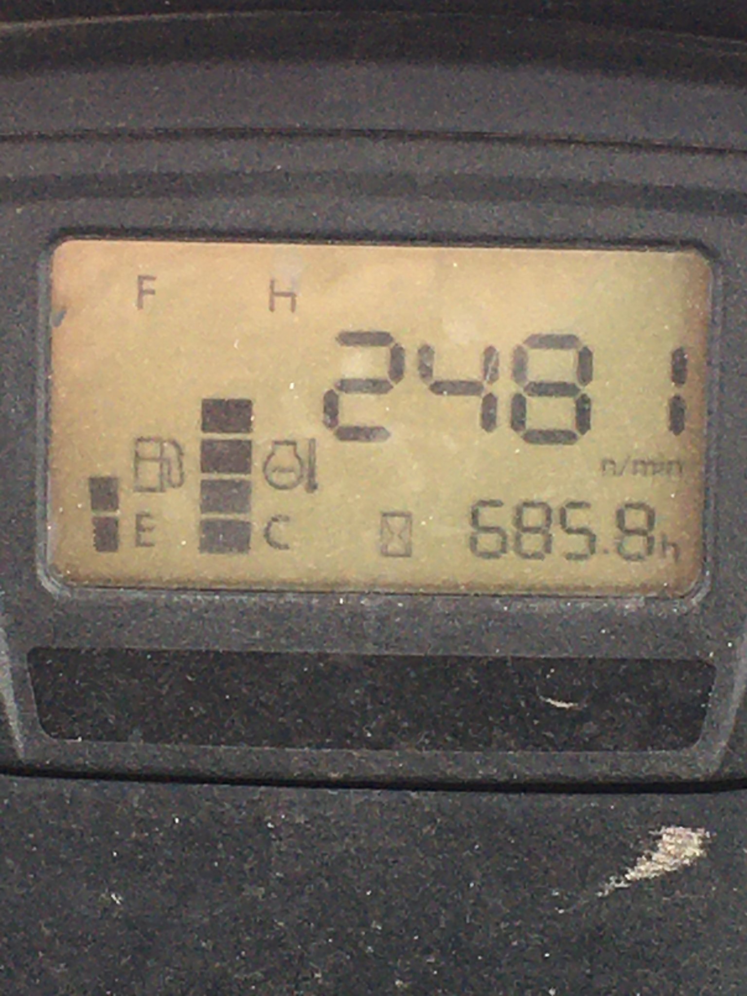

Tractor's temp gauge held steady at 4 bars displayed through the hour's snow blowing.

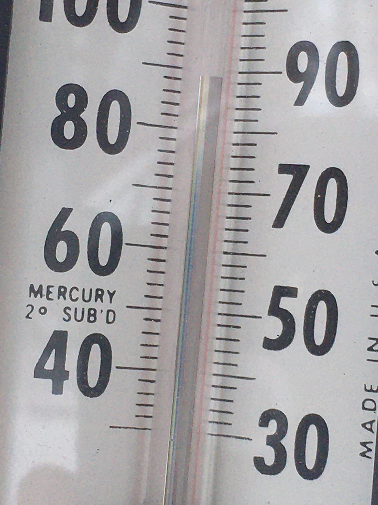

I tywrapped an accurate thermometer inside the cab at head height on the side framework.
(I didn't expect the cabin heat to exceed the range, but it's the only thermometer i could find.) :ROFLMAO:
Here's some pics of the setup, tractor's display and thermometer showing cabin's inside temp.
Select for expanded view:
Todays Gauge Readings.JPG Improvised Cab Thermometer.jpg Interior Cab Temp.JPG
As you can see, it was way too warm in the cab for comfort with the heater's blower speed on high. But this shows that even 3/8" heater hose hooked up to the water pump bypass circuit can supply sufficient coolant and heat to the cab heater. And the whole cab was at that temperature as you can see the heat probe was well away from the blower output and even located next to the window. The thermometer reads +90° F. I didn't have the heat gun to see what the heater core temp was. But from before, at 4 bars displayed on the gauge it was in that 170° F range. The engine oil temp would've been somewhere in the 190°/195°F range. The gauge never displayed 5 bars.
Normally, I'd either turn the heater off when comfortable, or cycle it to maintain a comfortable temp. Or adjust the covers with the cab heater going if the coolant temp started to rise above 4 to 5 bars displayed. That doesn't happen suddenly so there's plenty of time for adjustments.
The homemade cab that I install for winter is also quite roomy. the heater keeps it as toasty as you'd like. No snow sticking to the windows. It melts and runs straight down so no wipers needed.
Plenty of room for the jacket and gloves stuffed behind the seat!!
View attachment 74526 View attachment 74525 View attachment 74527
Nice so I finally got time today and I fixed heat I removed the t in top radiator hose, found the plug in thermostat housing removed it and hooked my inlet hose to heater to the spot I removed plug and had heat almost instantly pushed snowbanks back for about 3 hrs this afternoon with wind chills about -5 in a sleeveless shirt. Also got a hydrolic leak fixed and chains in rear tires.

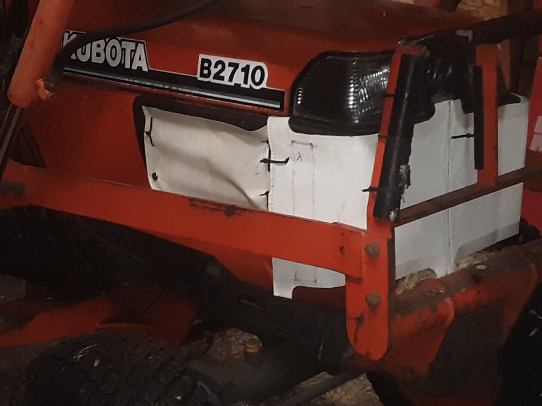

Actually these are old bus grill covers I sewed and made fit with velcro, but I zip tied to grill for transport but shouldn't have to so they are thick. How do urs attach? Snaps? If so I'd look at buying a set from u that would be even better wut made due with what I had here

There's nothing wrong with covers that do the job!! :) I used old carpet remnants over the grill of my old JD750 years ago. I just couldn't do that to the nice new Kubota. LOL! so I came up with these. They're held in place with strong magnets sewn within the hem along the outer edges. No tools or alterations to the tractor to apply or remove. Here's a link to the B2601 or '01 series to better show what they look like:
