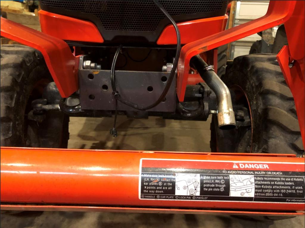

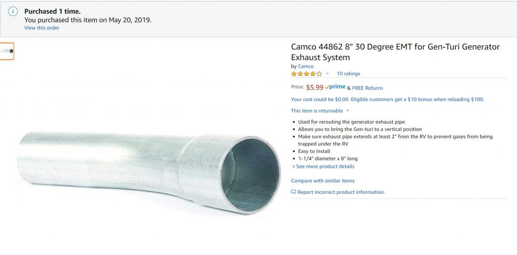

Bought this on Amazon, silicone adapter for a turbo. About $8.00 US.
Used stainless screws, top and bottom.

I installed one of these and it works like a charm. For $6, you simply can't go wrong. Highly recommended.:D
Thanks for posting that, dirtydeed! That's what I've been looking for.

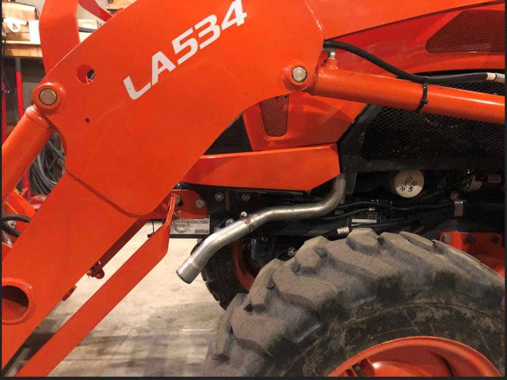

Sure thing. I wound up throwing a hose clamp on mine, but they fit pretty tightly. I haven't had to clean the loader arm or bucket since...
Here's a couple of pics of what it looks like installed...
