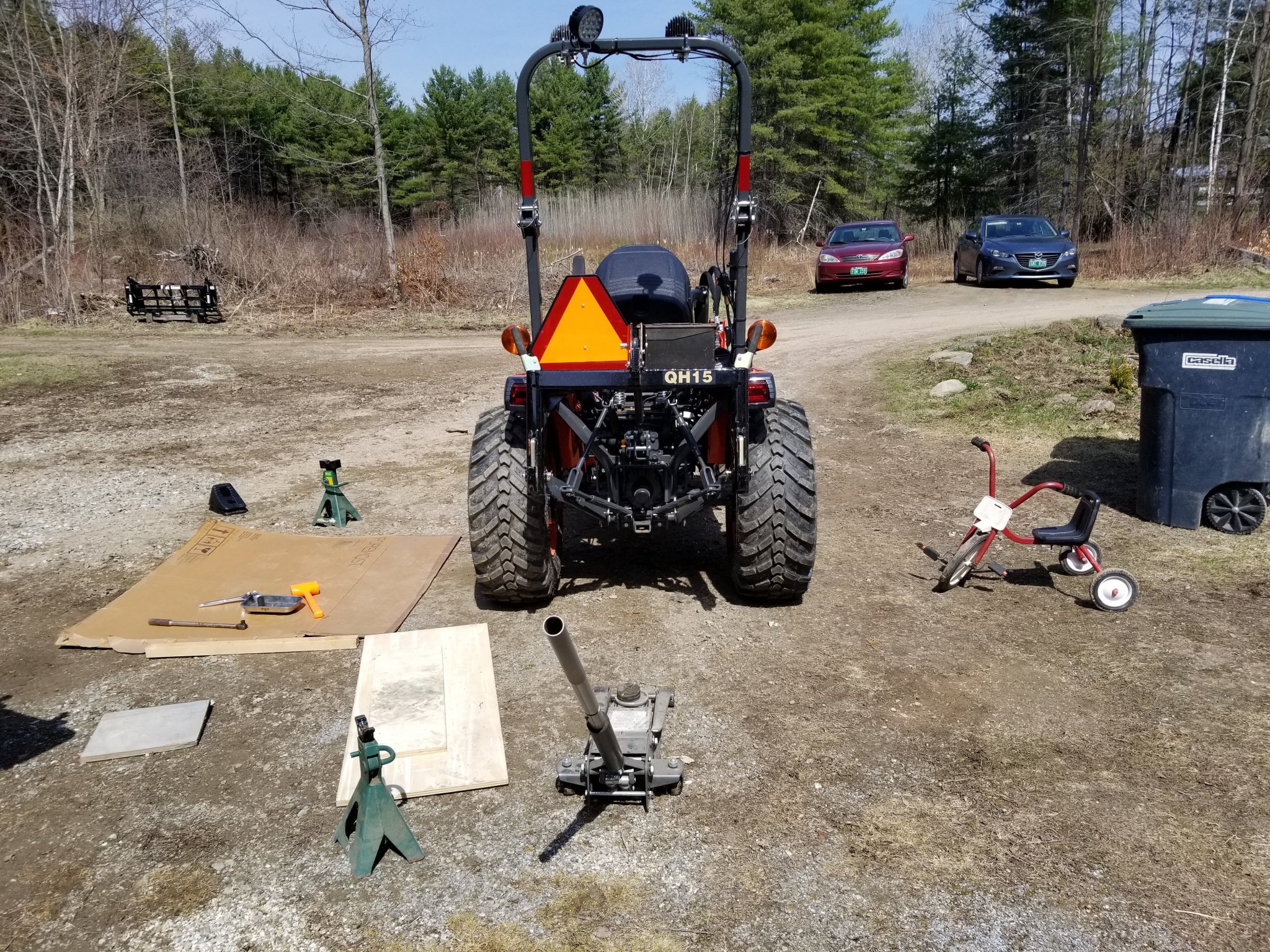

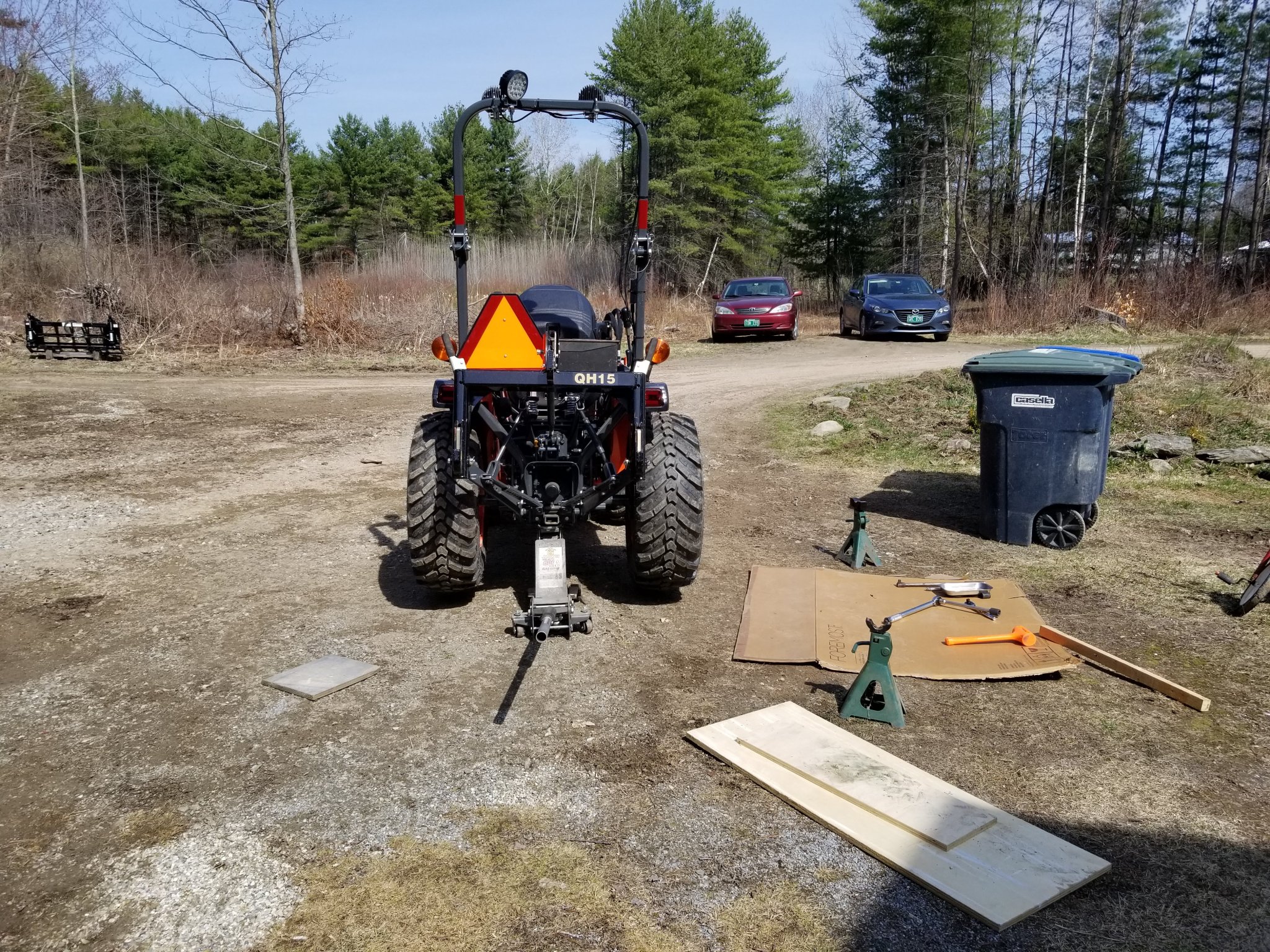

Wheel spacers make a major difference and is the best upgrade/modification I have made for my 2601. Only consideration for mounting them/caveat I can think of is that Mid-Mount Mowers might have clearance issues with the spacers, but thats about it. If you aren't mounting a mid-mount mower then I'd also consider ordering a step too (you can order a B2650 step and it fits).
Here are shots of my mount up with 2" spacers.
Half through the install; left tire is stock, right has the spacer:
Tractor back on the ground, spacers mounted
