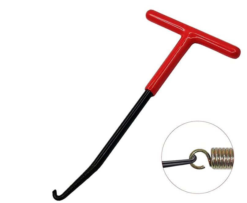

Hi guys - thanks for this thread, helped me figure out the stiff peddle on my brand new 2022 2601.
To give back to the forum I thought I would post up what I found with my tractor: although not obvious the three springs all work in parallel, acting on the same mechanical linkage. I simply removed two of the three, now the peddle works very smooth and easy! I removed the one by the interlock switch, and the one just ahead of it - so one spring remaining. Btw, the interlock still works! I used a motorcycle spring hook tool to get them off, was very easy.

Exactly! Paracord or wire works. I used a tool like this - its sold for removing exhaust springs from motorcycles.
