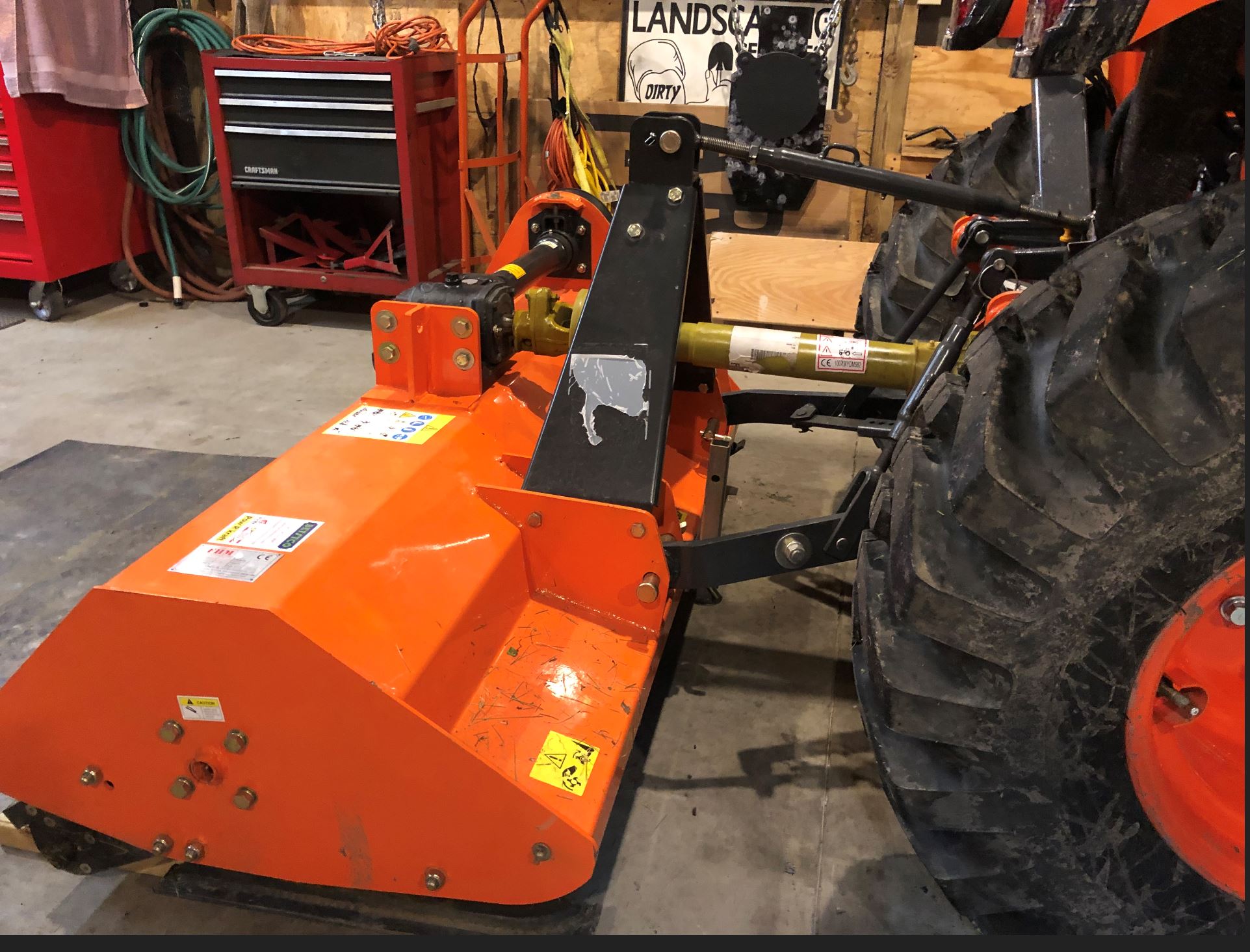

I have not figured out how to offset it yet, i was scratching my head on that one. Do you change the lift arm position?
Kevin,
Looking at your picture you're already in the offset position. If you wanted to center it, you'd move the mower frame uprights (for lack of a better term) over to the right side. Look where the gray brackets that connect the top link are bolted to the mower deck. I'm using the rightmost mounting bracket. See here:

ah ha, that makes more sense, picture really helps, thanks Steve
It looks like you forewent the cover over the input, I might just leave it off. Did you raise the skids and roller? im about to put them on the tallest setting

Steve thanks for pointing all that out. The thing was cocked because I was using the wrong lower hook ups while the top frame was offset. Once I got it sorted, its offset just a little to the right. I checked the cutting height and as shipped, was a little under 2 inches, I raised everything to the max and got it to about 3.25", which should work out good for around here. I also installed the input cover. Ready to take it in the woods now.

Kevin,
It looks like the position of your right lower 3pt hitch arm is still incorrect. I think the 3 pt hitch arm should be located between the two pin brackets (like on your left side). Maybe I'm mistaken.
I have mine set up to cut at the highest position (lowered roller) and raised the skid shoes as well.
Yes, the put cover was a PITA and split at a bolt hole.

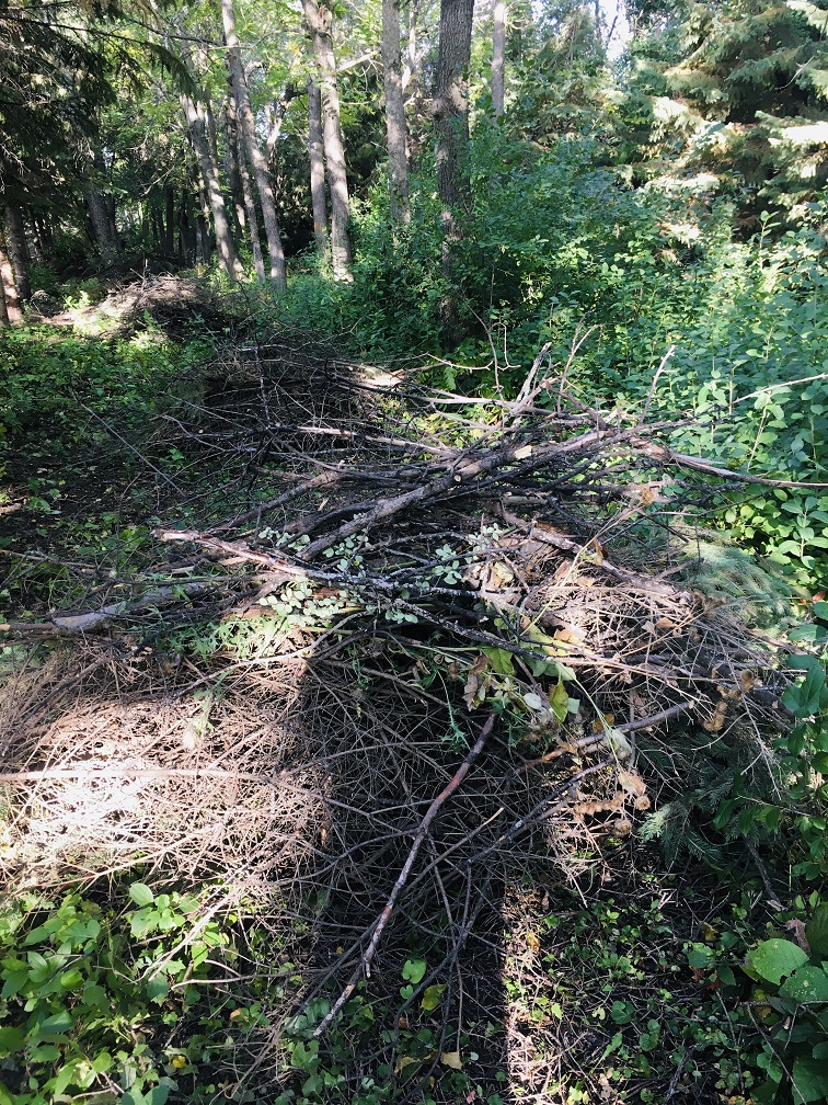

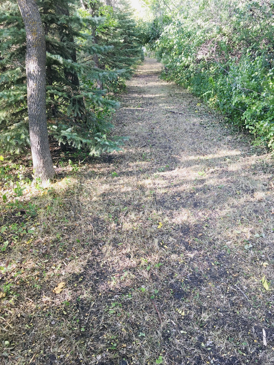

I ran it through some new saplings in the woods, didnt bat an eye. Then ran it through thick grass. I am really happy with how this handles grass. The cut isn't a finish cut, but its 200x better than the brush hog. It could almost pass as finish mower with dull blades. It did not create huge plumes of dust either. I could maneuver it tighter to trees with the offset. The way it rides on its back roller is really great for cutting on uneven ground. The tractor feels good without the big brush hog hanging off the back. I'm really happy so far, looking forward to more seat time, and putting it to the test at the other property with thicker brush.

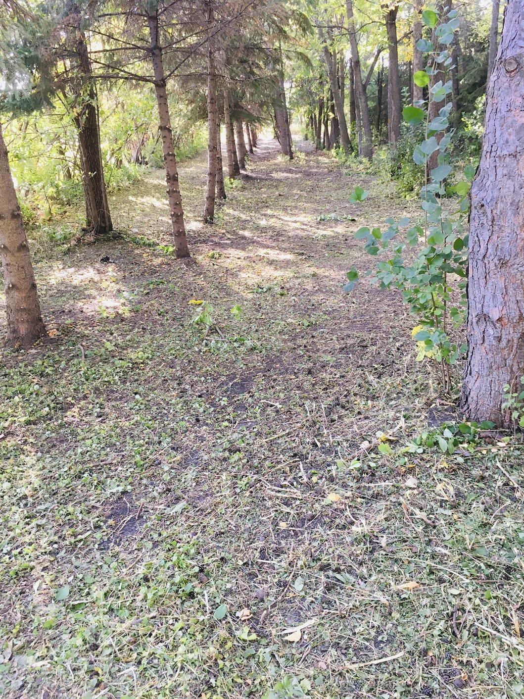

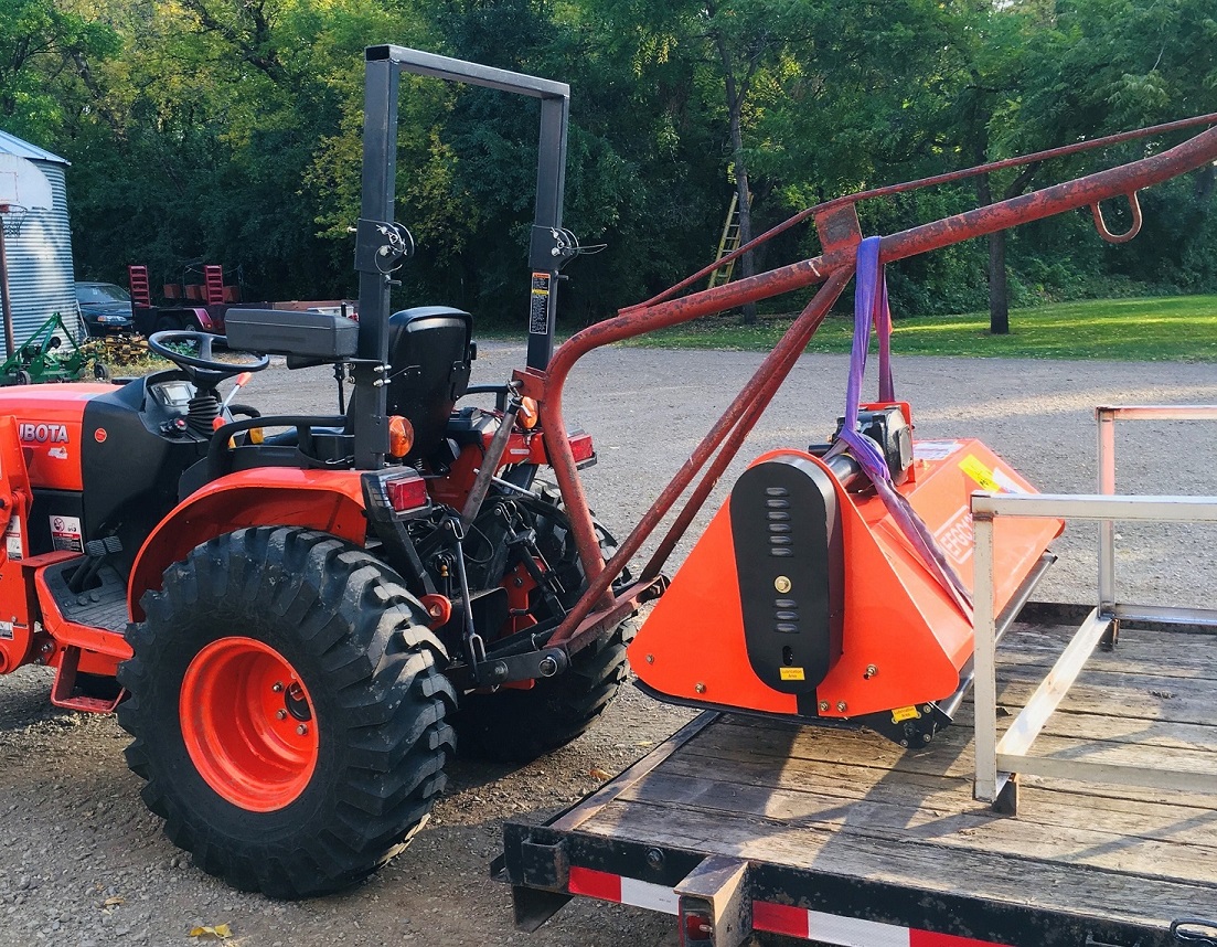

A couple of weeks ago the wife and female relatives decided to have a girl’s only get together at a cabin in the Minnesota north woods. They all headed out that Sunday morning. The very next day I get a call to pick up a package at the FedEx depot and this is what showed up. I’m not sure how the timing turned
out like this. Honestly!! :ROFLMAO:
This is the Betstco, 48 inch heavy duty flail mower to go behind my Kubota B2650. With it mounted in the offset position the cut width covers the right tire tracks and the belt drive housing cover is just within the left side tire tracks. For mowing brush in close quarters behind the B2650 it works great. Here’s a few pics of its first use. I had trimmed the low hanging dead pine tree branches off and removed them to allow close cutting next to the tree trunks. The rest of the wooded area was covered in small brush thick and thin. The flail mower waltzed through it quite easily. Hearing protection definitely required. Here’s some pics of the cut quality with the heavy duty hammers.
My thoughts are its a quality built mower. delivery and service from Betstco was excellent. I first signed up to get their email promotions and received an $80 coupon for the first purchase. So $80 off the website price on top of the included shipping sure worked for me!
