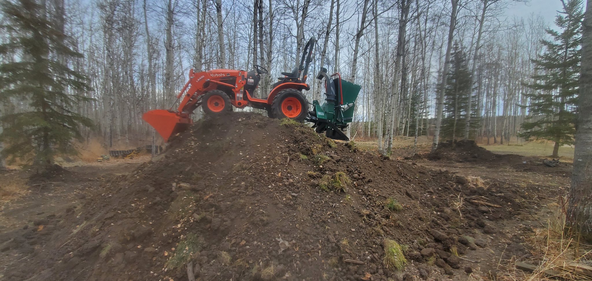

I have a 60" because that's what was on it. They said they sold all the 2601's that way. If I'm scooping something heavy I just get A 3/4 bucket and away I go. Less spilling on a bumpy road is a bonus and the build quality is perfectly fine. I ordered the R14's but they took months to get so i used the R4's for a winter. The R14's are far superior in snow removal, I don't spin the rears as much compared to the R4's. R4's will wear better in the long term, though.
