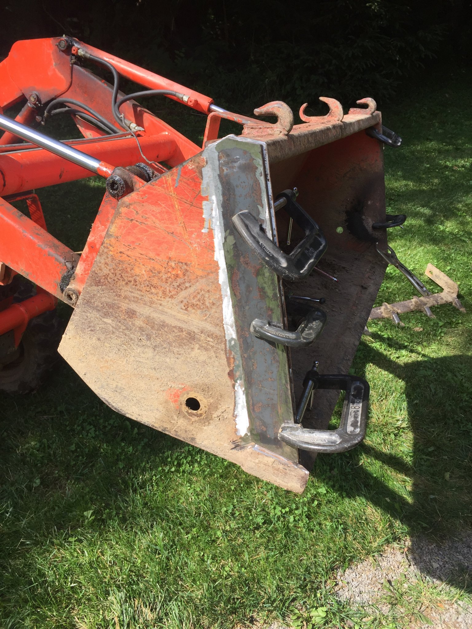

I bent the side of my 54" bucket somehow a couple years ago. Previously I had welded angle across the top for Chain hooks, and my heavy duty tooth bar stiffens up the bottom really well.
I welded pieces of flat bar on the side edges, after heating and straightening the bent side. Now I finally have what one might call a heavy duty bucket for a B series
