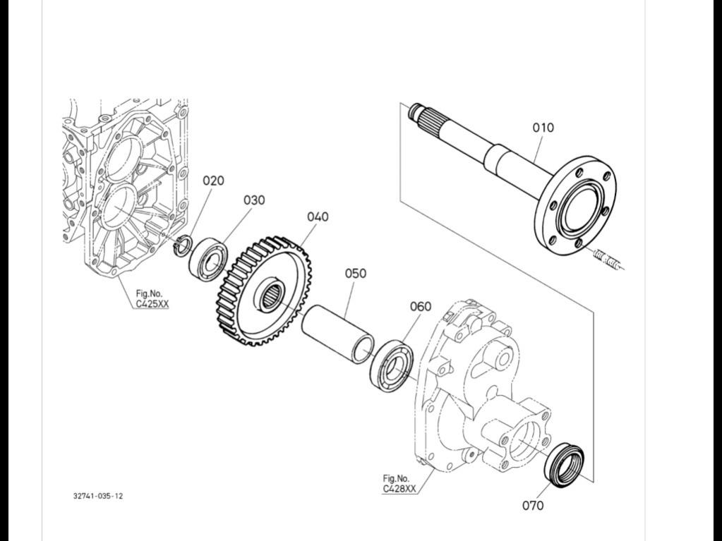

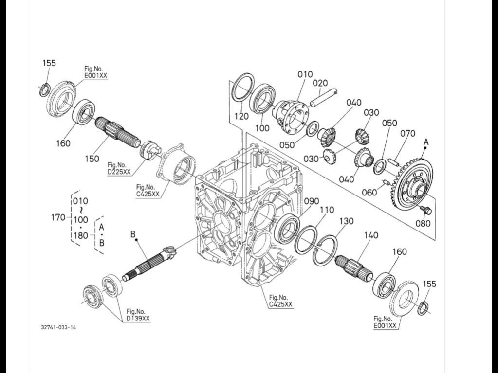

Mine is a 2009 with just under 650 hrs. and fortunately I have never had any drive train issues. Can't see how use of 4wd matters in this part of the drive train and you said you don't use diff lock (which still shouldn't matter unless you drove it in circles on pavement a lot with the lock on). A bad gear or gears should have been ruled out after the first replacement (unless you managed to luck into the same bad manufacturing run as the first set). Shaft alignment and/or play between RH shaft differential gear and main axle gear would seem to be a prime candidate. Short of bad machining of the right axle case, the main case, or the differential holder, that leaves the right side axle bearings and differential bearings. You mentioned you weren't sure if any bearings were replaced - I can't imagine the mechanic didn't inspect all of the right side drive train components carefully but it would be good to know specifically what was done besides replacing gears. You also didn't mention the age and total hours on your machine as to how quickly the first failure occurred in the tractor's life? If the machine had many good hours then two rapid failures, a bearing gone bad that wasn't replaced the first time sounds more likely.

It's not very common for any kubota to have the issues your having, so something has to be amiss
I would be changing all the associated bearings inner and outer, I would change both the bull gear and the gear shaft that drives it.

CurtisC My apologies for not mentioning the hours. It had approximately 1250 hours on it when the first issue happen, and now it's about 1300 hours. I ordered all new bearings and gears associated with the right rear. I'll be sure and post something after I get it up and running. Thanks

so for 1200 hrs, fine, then poof, fix it, 40 hrs later, POOF..again...
as others have said ,replace BOTH bullgear AND pinion(the little gear).
While you're replacing all this stuff, 'relive the day' and figure out what YOU were doing.'Something' changed, in recent history. Maybe you added ballast? Were moving a heavy load and rammed into reverse?
Since you have a backhoe, you have a front bucket ?...did you ram into a pile of fill to load up,stopped real fast ? 'shock load' will do that kind of damage.
Not trying to be mean, but you need to figure out what 'operations' YOU were doing. It lasted 1200hrs( 6yrs ?) then TWO failures in close sucession.
It's unlikely a 'mfr defect', odds are great the gears came from different batches,maybe years apart.
