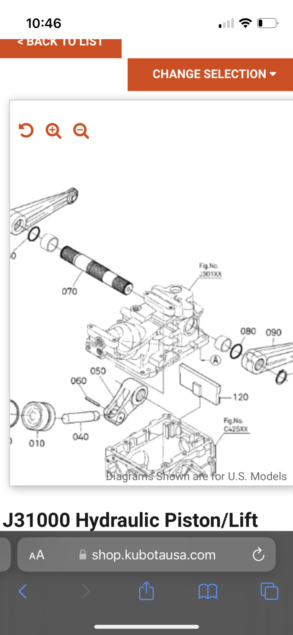

Based on this image, I can imagine that it could be as simple as the pin 060 having broken, or the part 050 having broken.
here is the link in case anyone else wants to see the diagram.

hmmmm.. from the OP...
I’m looking at either a blown seal in the lift arm cylinder, or more likely, a broken part on the lift arm assembly inside the transmission since there is no
(I mean ZERO) resistance up or down.
I suspect either '060' that connects '040' to '050' may be broken. mechanically it's the only thing I see that disconnects the lift arms from the ram, thus causing 'ZERO resistance up and down'.
