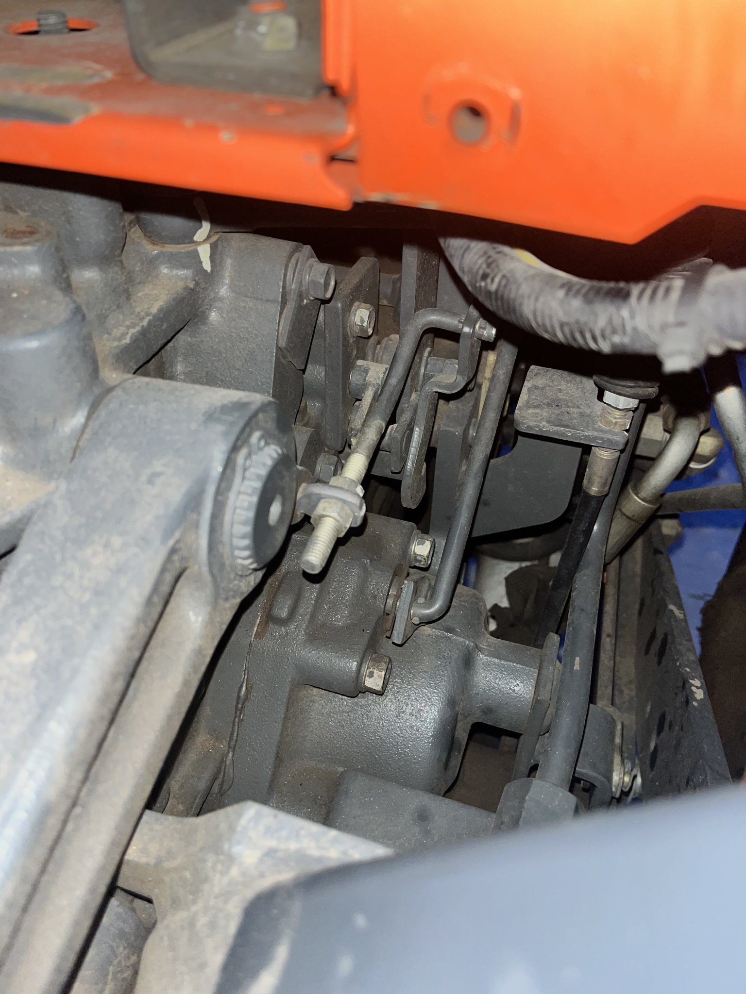

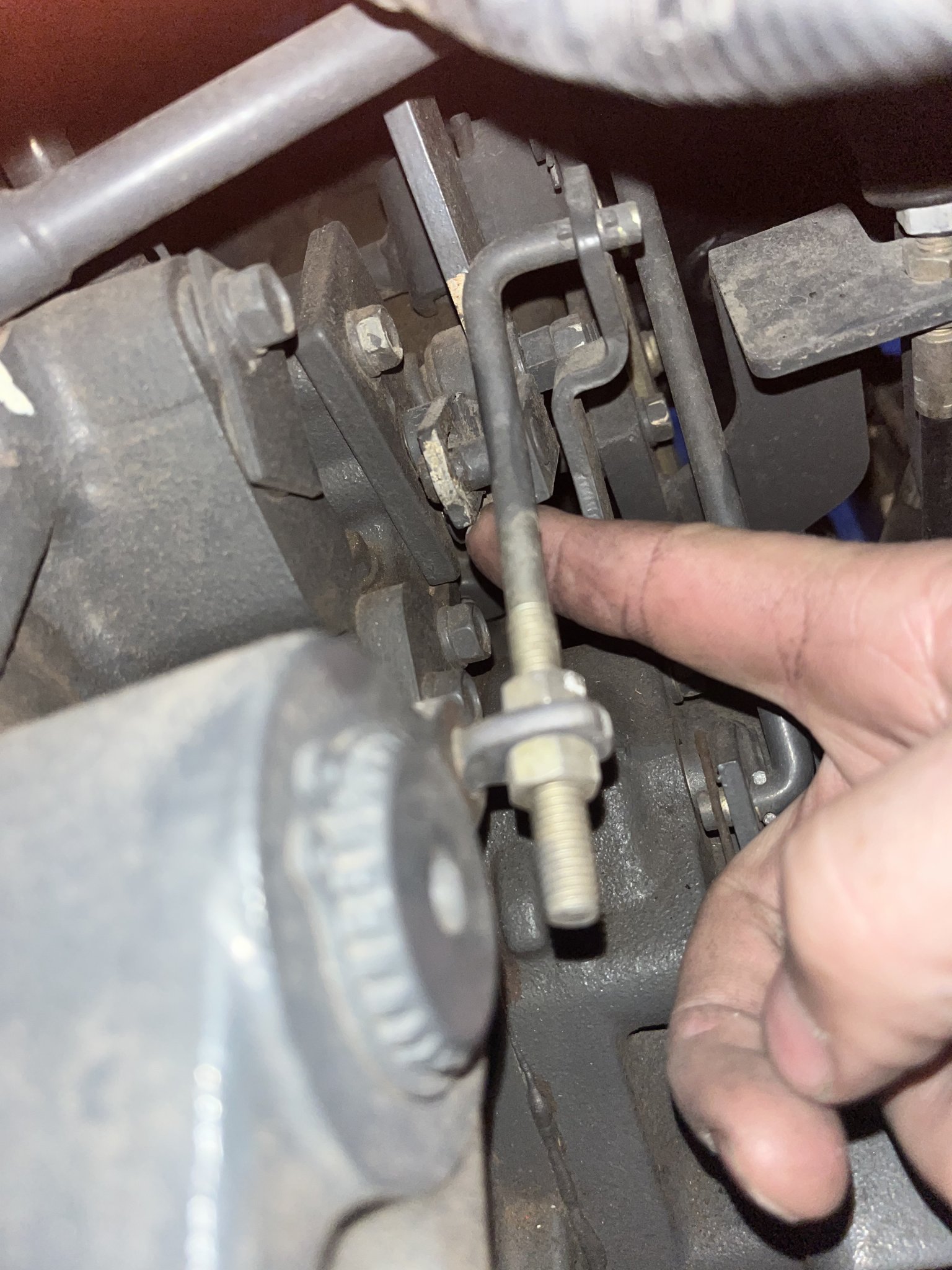

So, I got a chance to look again. Still nothing jumps out at me. No obvious valve that disables the three point, topped off fluid with about 2 qts of kubota hyd fluid, and linkages look good. I also disconnected the loop while running and tractor bogged down, so I immediately shut it off. But this tells me that fluid is circulating through the loop. Another thing that I didn’t mention though, when raising and lowering the lift arms by hand, there is a clunking sound… anyway, here’s some pictures. Maybe you guys will catch something that I don’t! In one of the pictures, I am pointing to the exact part of the linkage that the position control lever moves
36,535
11,292
That looks and sounds good.
The "cluck" is normal, the connecting rod is not fixed to the piston, and there is a keeper that keeps it from falling to far out of place.
How about the front knob?
And it's not unheard of for the piston to get "stuck" from long times of non use.
Put the three point position lever in the up position and do some other tasks, WORK it good, at good RPMS you might get lucky and have it break loose.
Otherwise your looking at a little teardown to get it working.

I think that’s where we’re at. I can see parts inside the case moving with the linkage, so that really verifies that the linkage is working properly. Opened and closed the drop valve a bunch with the tractor running, no change. So stuck sounds about right. Also, as I mentioned in my first post, From what I can tell, this thing lived with a backhoe on it, so I don’t think the three point has been raised almost for the entire life of the tractor. Any other tips for freeing up the cylinder? Could jarring the lift Arms downward with a dead blow hammer be an option? I can’t imagine that would damage anything. Also, am I correct I. Thinking that a blown seal would likely still produce upward force, just slowly?
