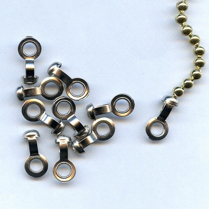

Can you attach the plug to the tractor with a chain so if it falls out it will be hanging on by the chain? Is there a tab to drill a hole through?
this kind of chain is what I mean…
