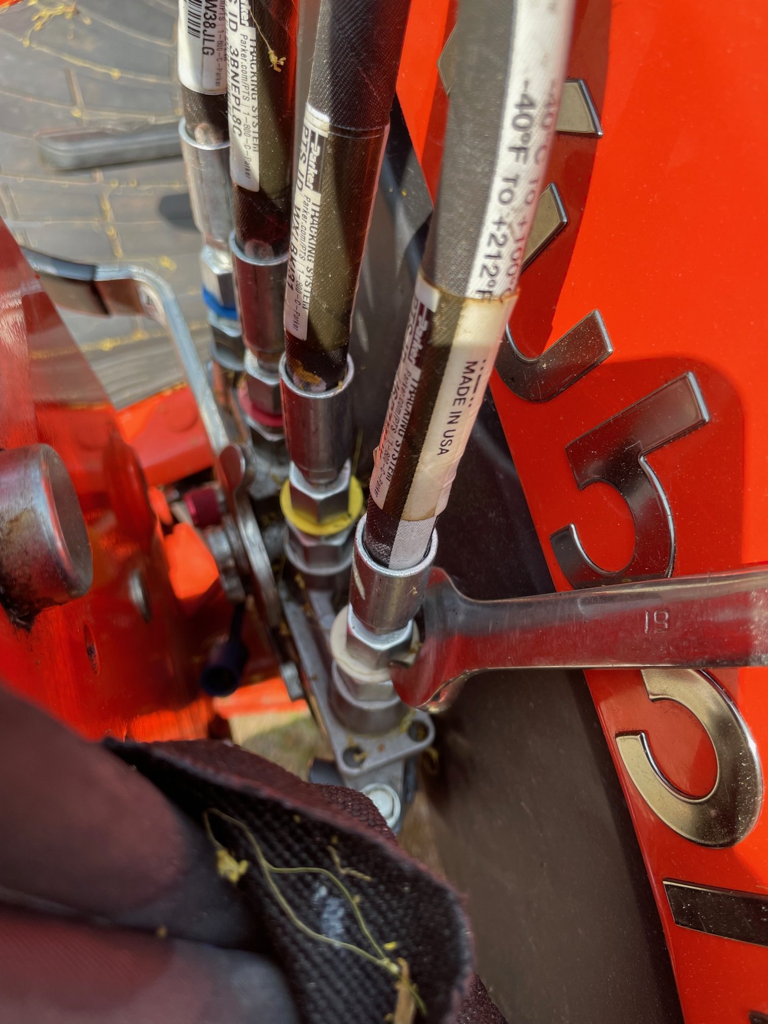

OK so I finally had a chance to check this out. I asked about simply unscrewing the hydraulic hose from the rod end at the fitting because in doing so, it leaves the other end (where the hose attaches to the swift tach fitting) open-ended. I was thinking it being open would suck air in when I tried the loader.
I disconnected the line and put it in a bucket. Started the tractor and raised the bucket which went up smoothly appearing as intended. When it got up high above the tractor hydraulic fluid sprayed everywhere like a geyser from the open swift tach fitting all over me and tractor, LOL. Much to my son's amusement. So I then attached a regular hose with hose clamp from the open end and put both in a bucket and tried again. Loader goes up. So yes, appears there is blockage either in the fitting or after? After the fitting it goes to hard lines to valve. It does sound to me like hydraulics are laboring like there is a blockage.

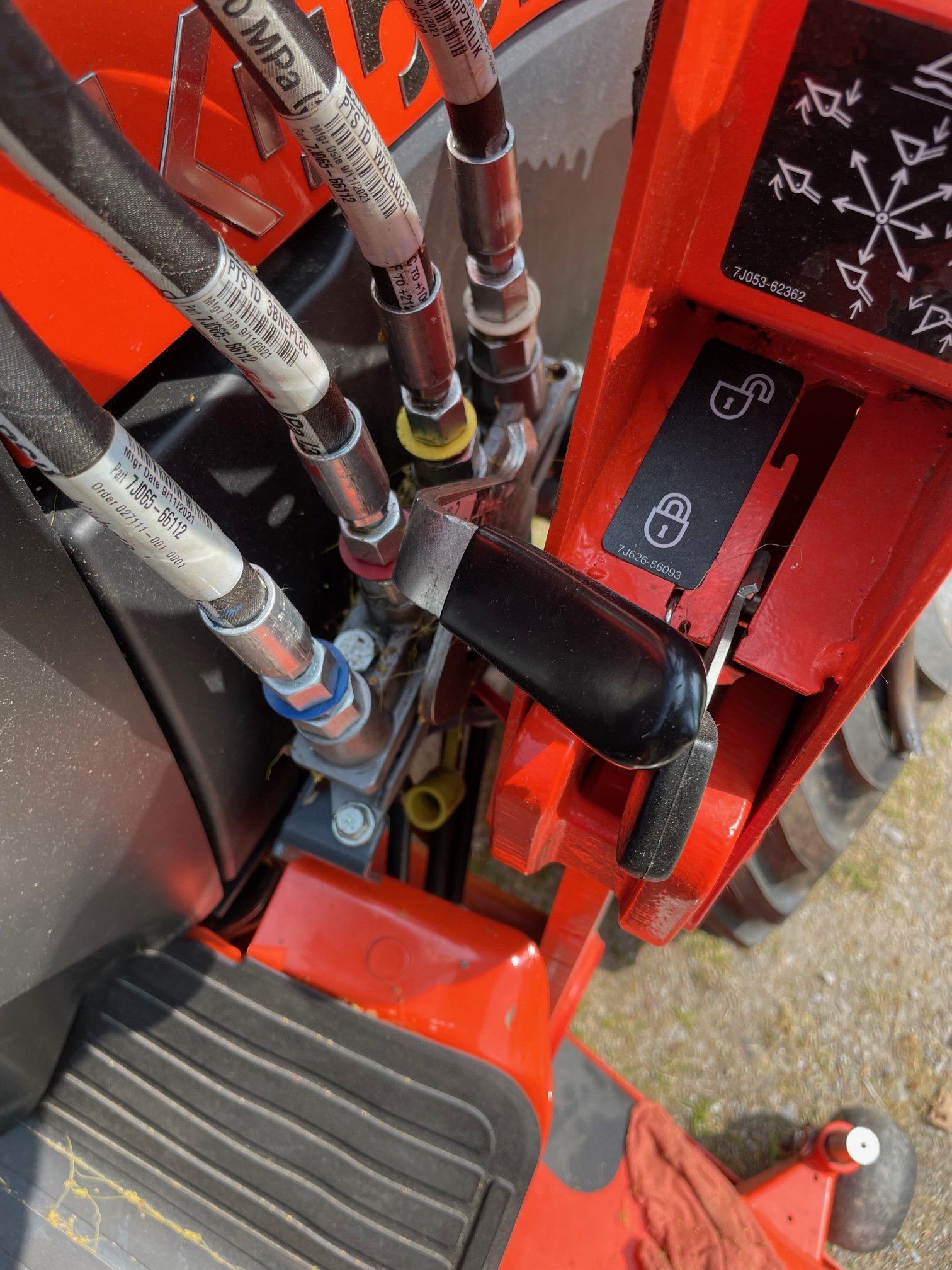

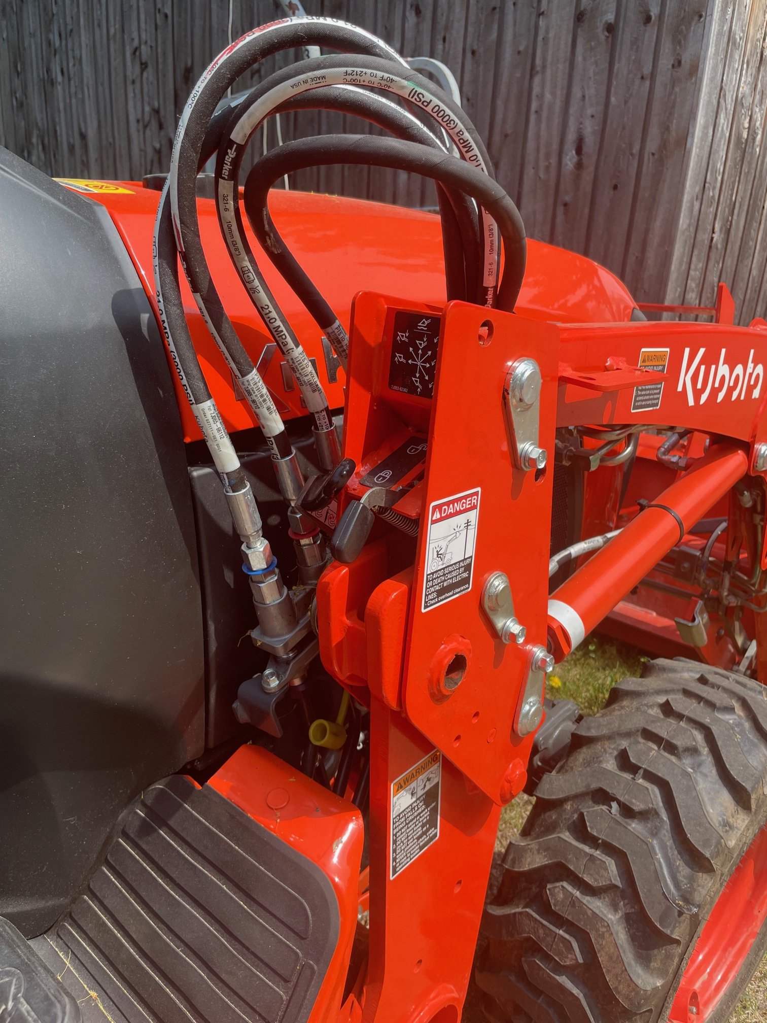

The swift tach fitting seems oddly placed to me. The fitting has a lock tab that pulls out then the there is an arm that opens releasing the fitting (see my pic above). When I lift the release arm, it can't open all the way without hitting the loader which prevents the fitting from releasing. I assume it only is able to be opened if the tractor is lifted by the bucket during the process for removal? @jkrubi12 @GrizBota is this the same on your tractor?

@TheOldHokie my wrench is pointing to where removed.
This image shows how the release handle runs into the loader and doesn't allow fitting to release (handle is as far forward as it will go here). Maybe the handle itself is bent? Pretty heavy steel, not sure.

I have a couple images that I have easy access to at the moment as to how the quick connect hydraulic gang connection for the FEL mounts on my B2601. I can’t attach them as they are too large, 4.5 MB. I don’t recall it being restricted or hitting anything relative to preventing the connection from being pulled off when the cam lock is undone.
After watching a video on removal, looks like the swift tach handle can only be opened after the loader is detached and tractor is backed away from it a bit...

As far as the swift-tach hydraulic connection, that is the last item to be disconnected when removing the loader assembly; at that point the part of the loader that is blocking the swift-tach lever is out of the way of the hydraulic connector, allowing it's complete unfettered removal. It may be worthwhile to find a YouTube video showing loader removal which would likely explain it better.

Regarding the cam lock handle, yours is a bit bent, mine is a perfect 90 bend. But I do agree, you have to back away from the loader just a bit to fully disengage the cam lock and remove the gang plug.

Thanks. I wasn't thinking real clearly when I told you to disconnect there. I failed to account for the fact that it also opens the workport to open air. Get a cap for the coupler side before ttying again.
In truth I think we already know the coupler is passing flow and is not blocking the exhaust flow from the cylinders. Since that port is dumping into the power beyond circuit it suggests somethin in the PB circuit is blocking flow.....
