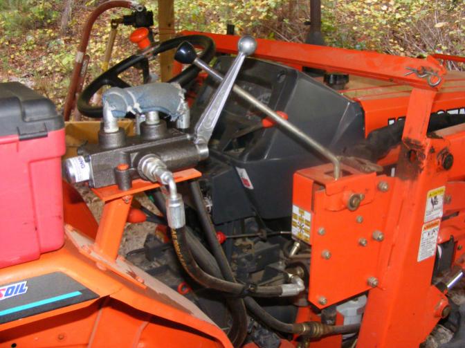

Also, another question of "what is this". I notice on the top of the FEL frame there are pins on both sides for mounting something. What would that be. Pins are shown on this reposted pic from earlier. They are the slightly rusty pins at right center.
The bars you are missing actually go in the slots on the outside of your bucket. The pins / bolts at the bottom of your grill that hold the front of the loader stick thru from the outside and screw into the lugs on the top of the bucket. They secure the bars in place when you remove the loader. You may or may not have noticed the pins on the lower portion of the loader arms where it hooks to the sub frame. Obviously these have to come out to remove the loader. With these pins removed and the bars on the bars mounted to the bucket you would roll the bucket back and it would lift the loader arms out of the sub-frame. After this step the small square bars on the left side of the loader will fit in the rear loader arms and they support the back of the loader while it's off the tractor.
I'll attach a picture of the bars on my loader. These should be just like what you are missing. I don't have a great pic but you will get the general idea.

The Pins that would hold the bars also support the loader frame from getting tweaked out of shape, they are normally on any loader that is a quick removal type.
