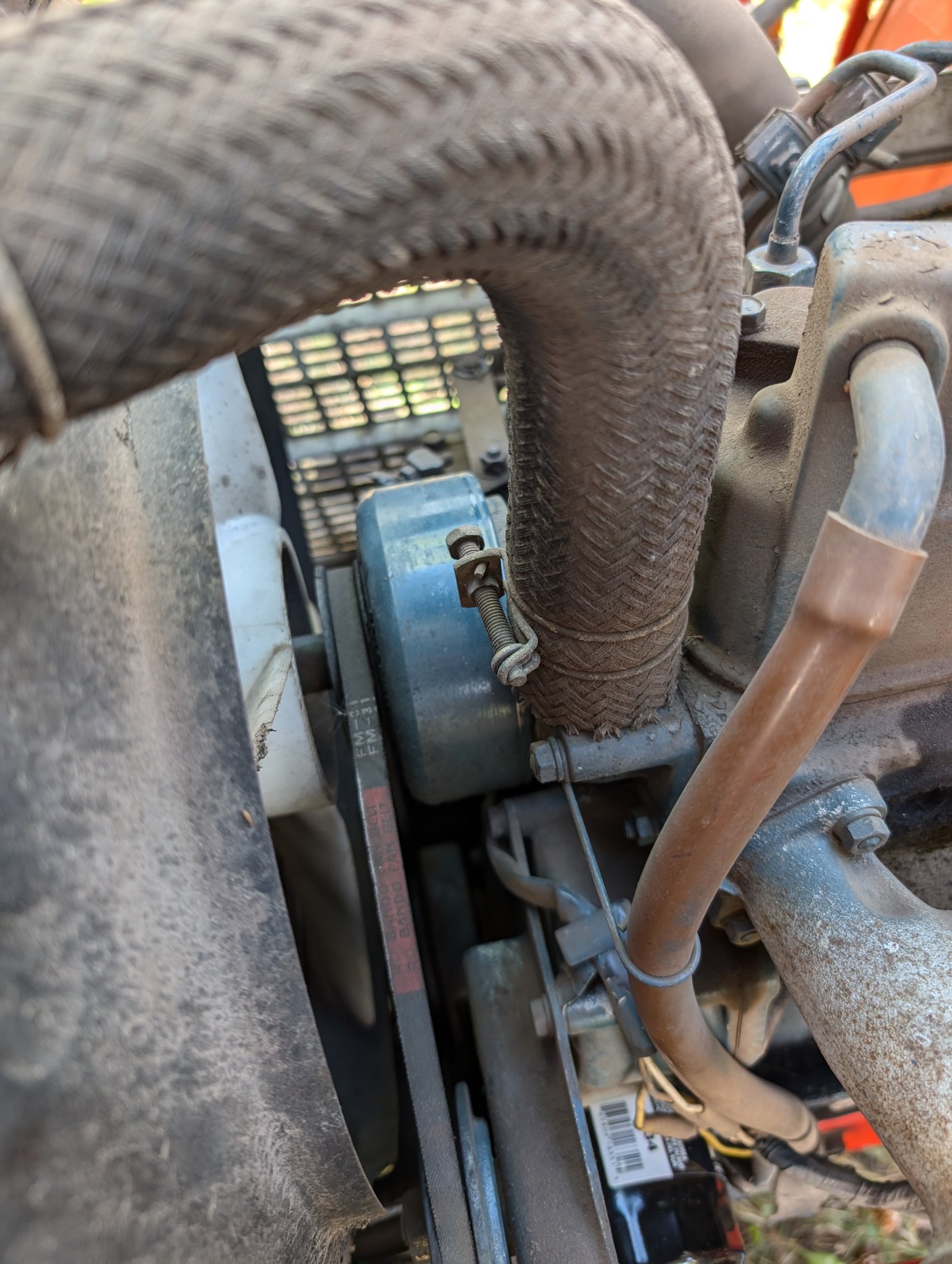

If you post some pictures of the engine it may help. I don’t see a similar US version of the B1500.

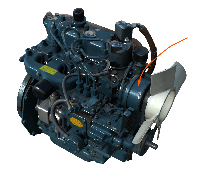

DYNO is located here - see if there are 2 wires that come out of this - use a volt meter and set it to AC and test those two leads ........... yes - engine needs to be running and be careful doing it!!!
If you have 25+ volts AC then the dyno is working ( 3/4 or better throttle)
Dynos rarely go bad - the bearings go bad but most live the life of the tractor.

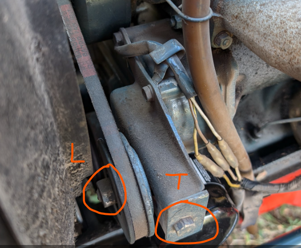

Yes, that looks like mine. Looks like there's three wires coming out of mine and then tapping into another cable which I don't know which leads me to two other directions so I will have to trace it out. I would also like to replace the belt but not sure how the tensioner actually works. I don't know if you have to first loosen a bolt through the center of the pulley and then use that little adjusting bolt on the side?

Loosen the one marked "L" and then back off the one marked "T"

Hey that's great. I'm going to replace the belt with maybe one size smaller as the tensioning is maxed out right now and maybe that'll do the trick for it. Maybe is slipping on the Dynamo.

Got lucky for once. I took your advice on how to adjust the tension from your picture and it all makes sense once you do it once and there was still room to tension so it took maybe not even a quarter of a turn of tensioning and the alternator light or charge light extinguished. I always overthink everything and make think it's going to be so complicated from a new Dynamo or at worst case get another belt which I think should be easy to get on and off on this model. But thanks to you it was a breeze. Thank you very much.
