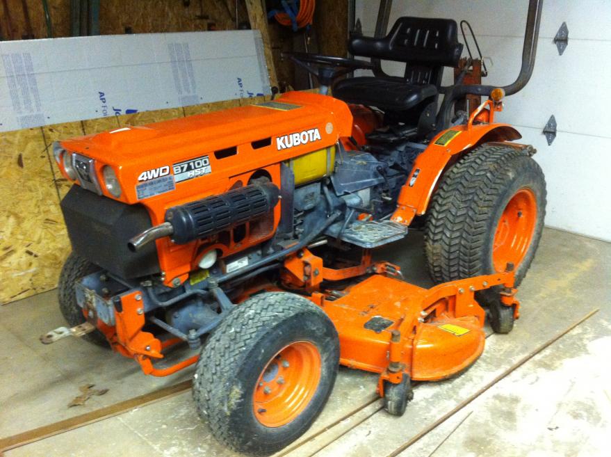

I hear mention of the decompression lever on B-7100. Is this lever activated by pulling throttle lever towards rear to kill the engine? SHould it be used when starting to spin engine to build oil pressure prior to starting? We have an old Cat highlift that starts that way. When should it be used? Thanks

Assume the knob is on the dash. Do all B 7100's have this? I don't recall seeing one on mine, but I will have to go back and look again.

Depending on age it may not be fitted, I've 2 B7100's and the older one is fitted with the knob whereas the newer one doesn't have it.

I don't think your model will have it, the 6 lug front wheels and HST tells me you have a newer model, and like Sylvester said newer models didn't have it.
