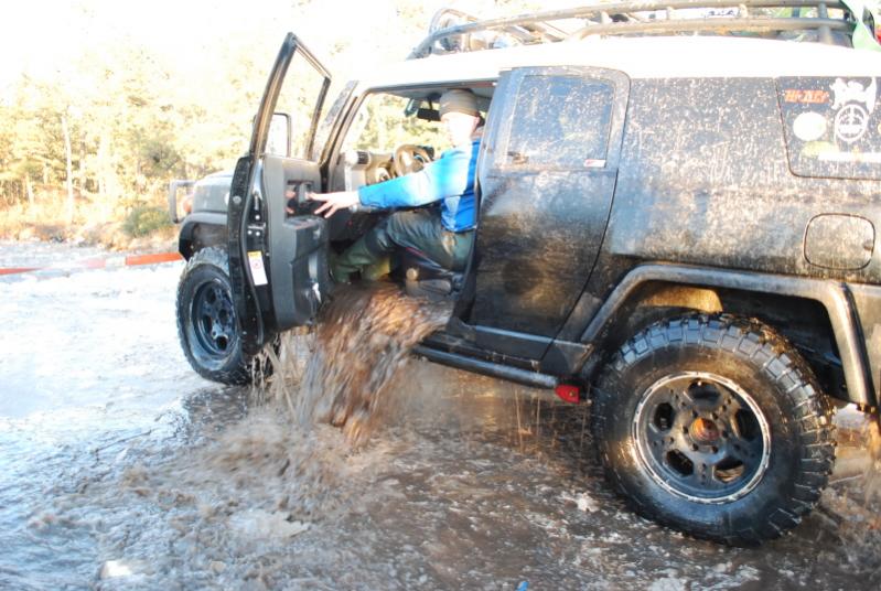

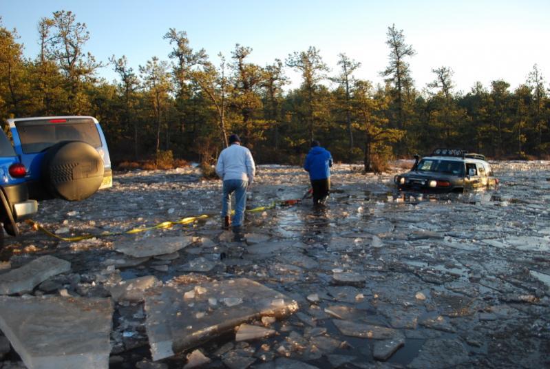

Years ago when I used to offroad with some friends. Snorkels don't always do the job!
