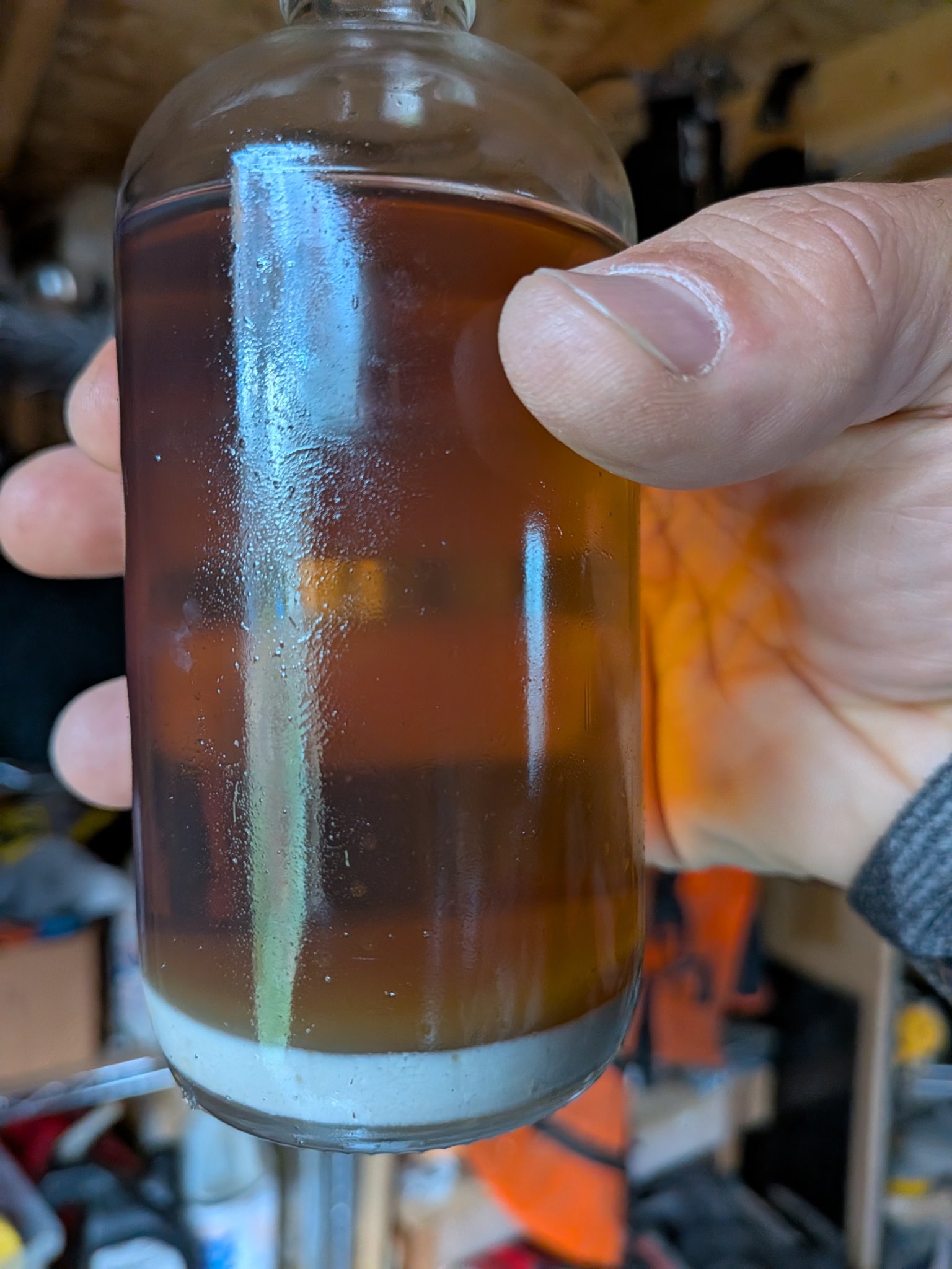

After many weeks of settling this is what it looked like (what I drained). I don't actually see water but what would we classify the white sediment at the bottom as? Is there another issue here?

Well donet!!! Emulsion and/or additive dropout. Something you dont want.

No. I am just learning about all this. Water causes the additives to precipitate out. Got it. Thank you
Water can cause additives to precipitate out but the formation of emulsions and free water are the main concern. Think loss of lubrication and increased corrosion.
