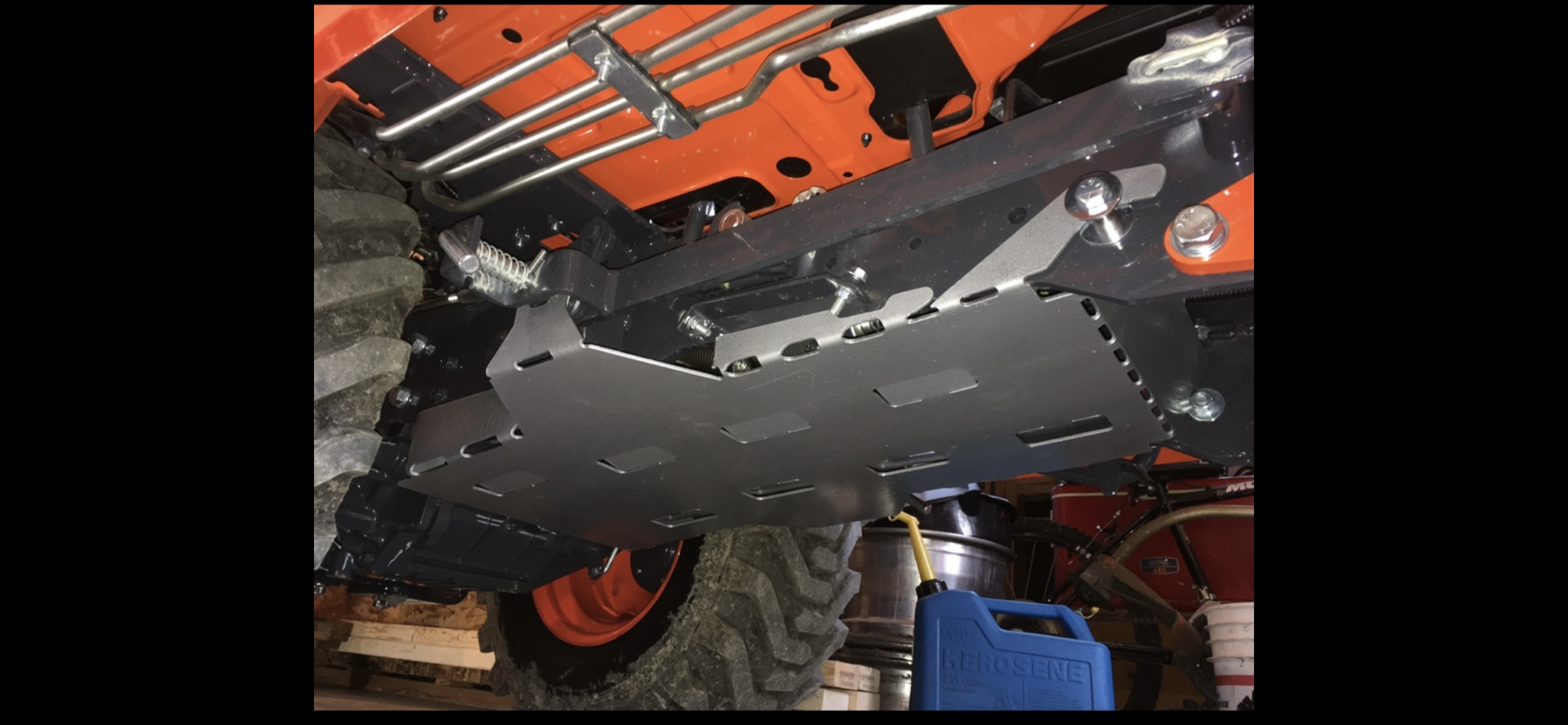

I am considering purchasing a used BXpanded underarmor for my BX23S, and it is originally used on a BX2380. Will this fit my BX23S tractor? I couldn't find the answer on the BXpanded website, so I thought I would check here first and if no one knows, I will call BXpanded in the morning.

I'm not sure since you have extra Steel going on down there with it being beefed up for the BH.
Pic of mine mounted dunno if it helps any but I'll be going out there in a minute if you need measurements or more pics.

I was going to do one of these as well but I think I found out it interferes with the Mid pto driveshaft for the snowblower.

1-2 minute removal with your eyes closed!😁

When my snowblower is on the BX, I don't worry about sticks poking the cooling fan blades.

Helpful hint #456: The spacers on the front supporting bolts are terribly thin conduit and fail easy. I took mine to the local Lowes and in the hardware section,. I found solid steel spacers, the same OD and with an ID that fit the BXExpanded bolts.

I can answer this. Yes it fits. I had to move two hoses that went to my third function. I had it installed in about ten minutes. Now I can have it off and on by just dropping the mower all the way down unhook the two pins and off it goes. It installs the same way.
