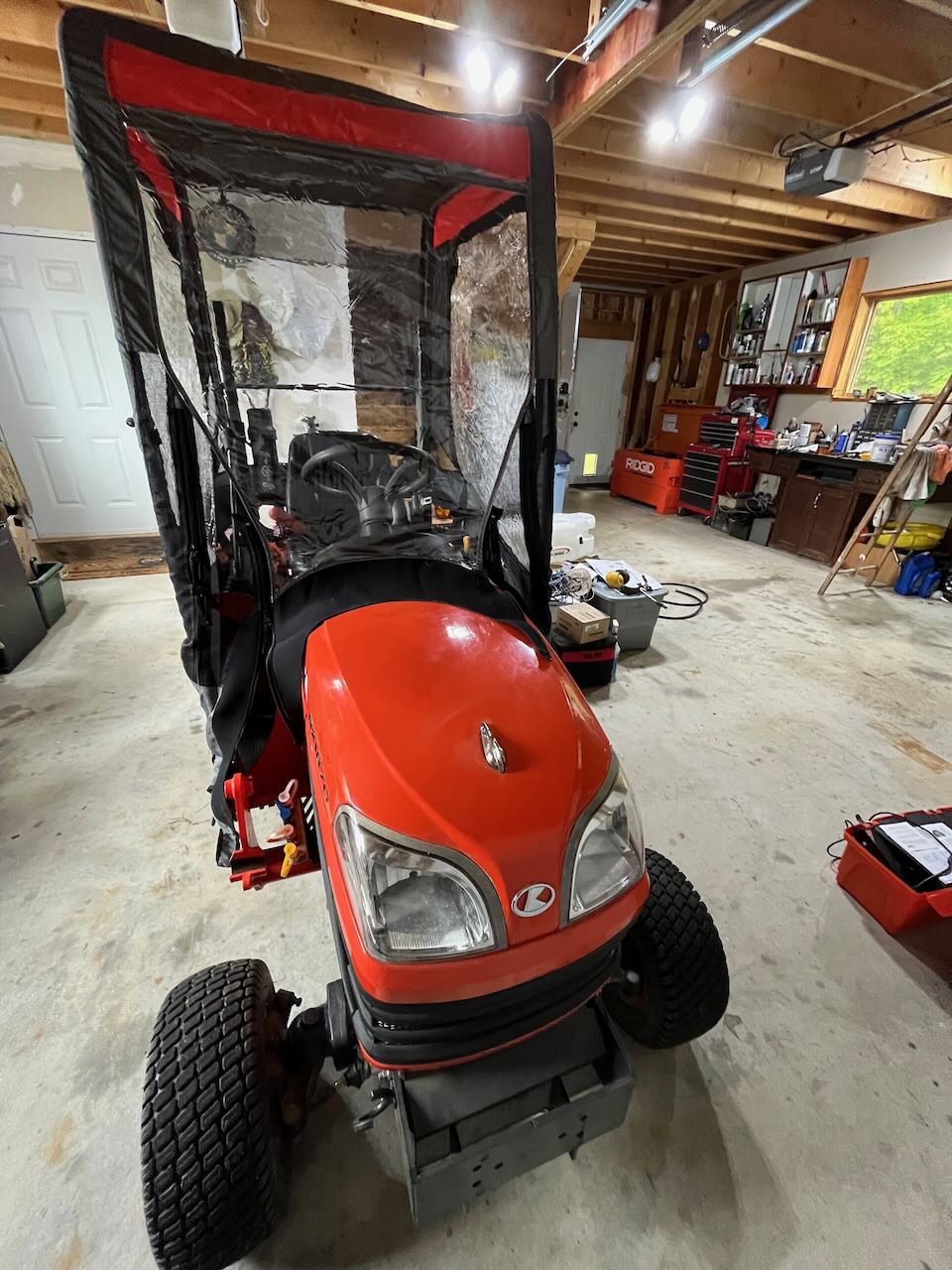

I see Husqvarna raised the price on their lawm tractor snow cab about $100. I looked and found a source at last year’s price and ordered one before the new price set in. It arrived a couple days ago. I just got a chance to open it up and test fit it. The overall size is good but the mounting system will need customizing. The frame is extremely well made and assembles without tools. The cover seems nicely made too. I had to remove the top section of the ROPS but in winter I will just be on my relatively smooth paved driveway so rollover seems unlikely or nonexistent. Too bad someone doesn’t make a shorty replacement for the top.
I now need to cut the mounting brackets to get 2 tubes to mount on the tail lights and 2 for the foot boards at their extreme front. Not a big deal but a little welding will be needed. The fabric around the rear corners will need to be slit to allow the top to fit around the rear light mounting bolts too. I think a hot knife should do that and avoid fraying.
I’ll post up again when that is done.

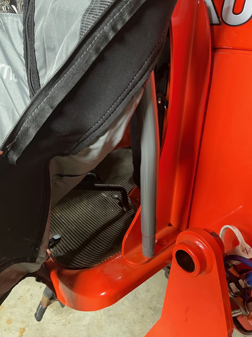

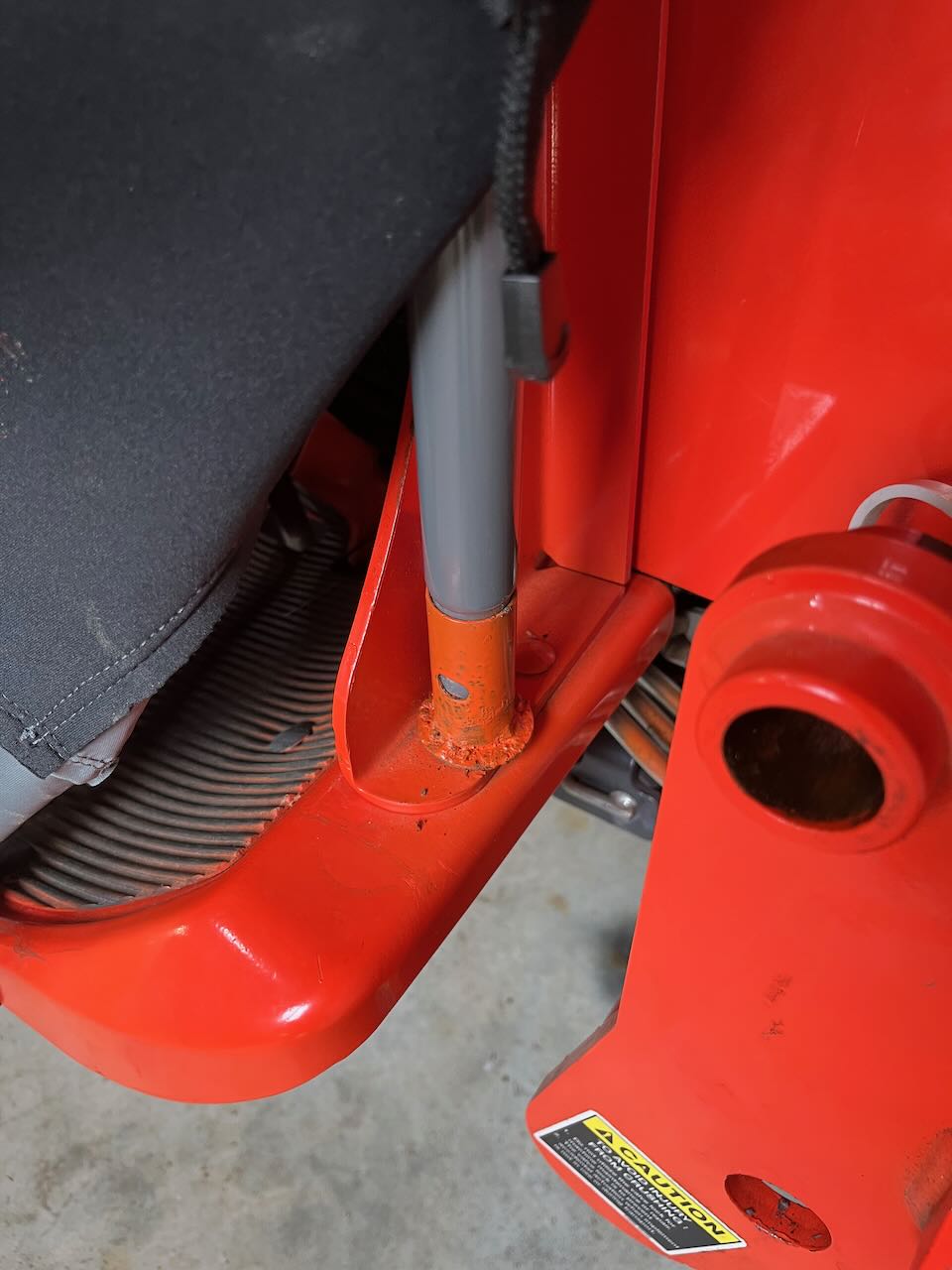

I got the instal nearly done today by constructing brackets for the frame posts to fit into. In the front I welded a washer to the bottom of a salvaged piece of the frame I didn’t use for each side. I’ll drill a hole through for a cotter pin to keep the wind from lifting the cab there.

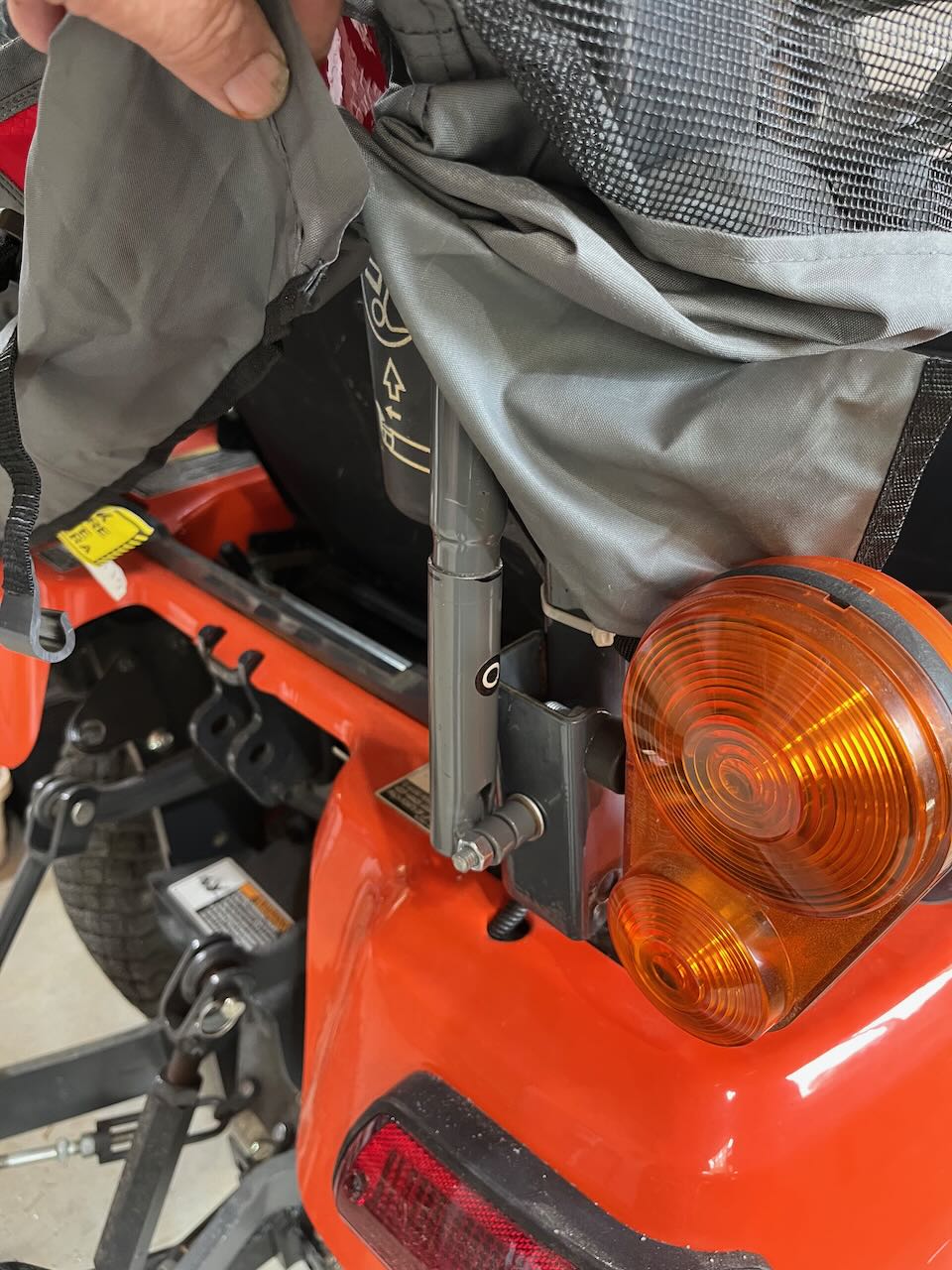

At the back I cut a section of the other end of the same leftover piece which had a bracket that I used to bolt through into the rear light brackets.
Then I cut a slot in the rear corners to fit around the light mounting bolts.

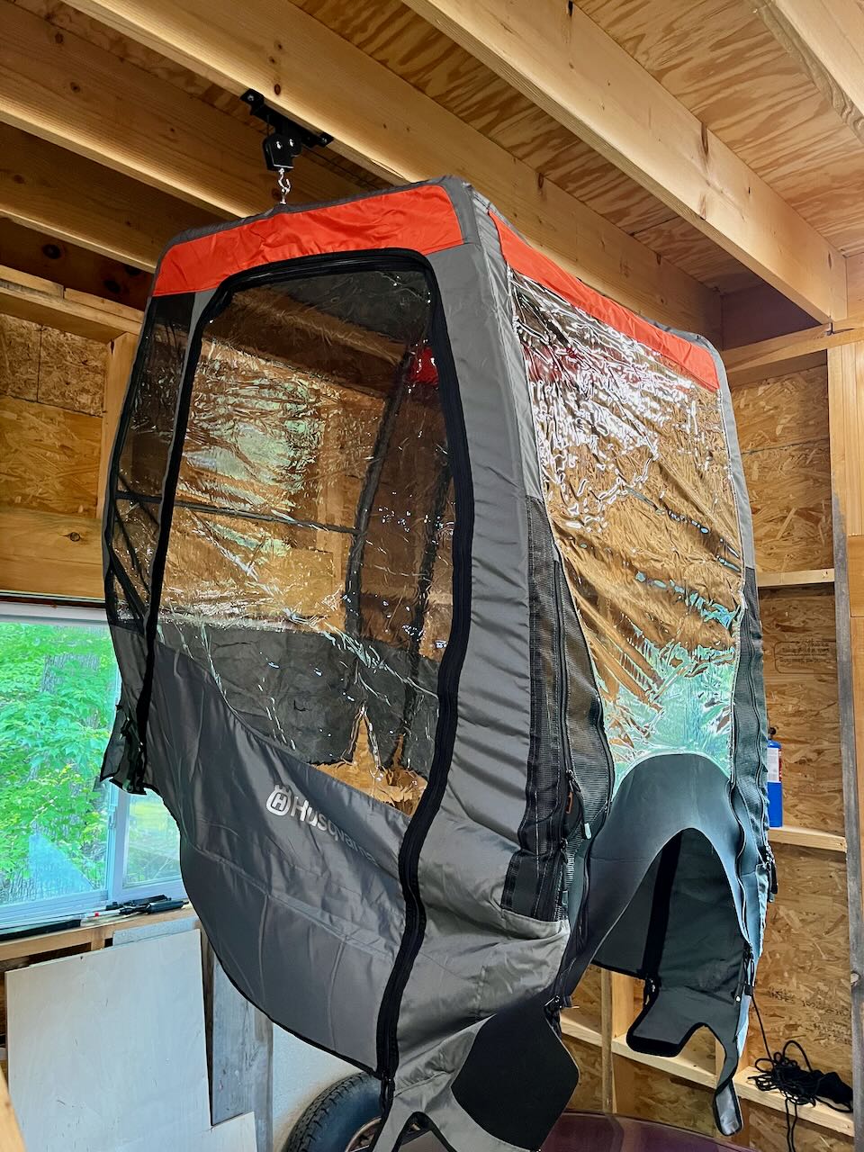

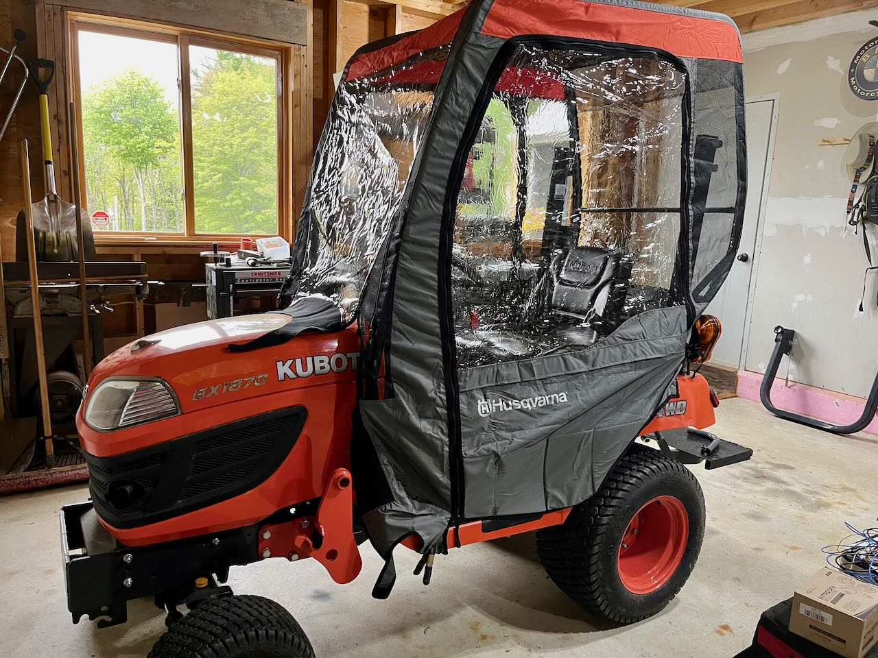

That will get some trim and a strip of Velcro to hold it closed. The fabric has tabs to keep it attached to the frame so I plan to store it in my barn. I’ll get two brackets to clamp on the pipe at the top center and use a coupleof pulleys and rope to raise it above my other junck stored there. I should be able to lower it near the tractor and fit the frame posts into the brackets. I have to say it seems good to have this done in the spring instead of in November working in the cold, rain, or snow! Total cost $349, total time 5 hours.

Thanks, Yes it fits OK and the modifications allow it to be taken off in 10 minutes with no tools. It’s hung up in the barn ready for snow. I hate to spend money but I also hate being cold and covered with blown snow. The total cost was $360 and probably 2 hours of head scratching to come up with the mounts plus two hours of fabrication and two trips to the hardware store. I like that it is orange and the frame of the kit is really well made. The plastic and fabric are good as well. Time will tell.
