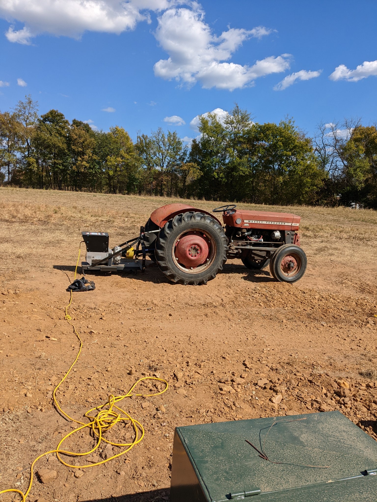

I have a 16kW IMD AVR that I hook up to my 60 year old Massey 135 diesel. I only put a load of about 20 amps on it and the tractor and gen handled it fine.
I have a 4#4 cord with 60 amp plugs on both ends. I took a 50 amp RV plug and replaced it with a 60 amp plugs and screwed it to the side of my Kohler transfer switch. I also have a manual transfer switch to wire it in directly.
They import the generator head from Italy, they showed me the tracking of the ship. They assemble, test, and add the outlets.
I bought the 3 point carrier and pto shaft from IMD but you could make your own if you have a permanent location.
