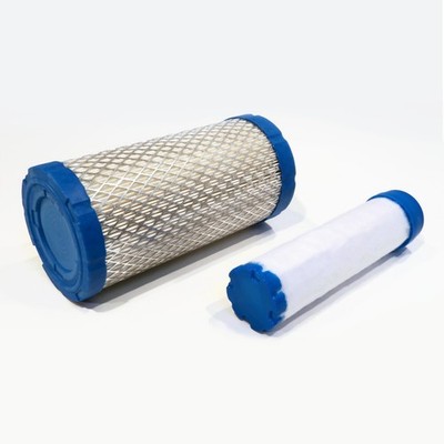

anybody running a "secondary air filter" on their BX?

I just installed the secondary filter on my BX1880..it is a Factory filter from Messicks..There is a video on their web page showing the filter and installation which took no time at all. Blew out my primary filter per the service instructions, could not believe the dust that came out of it after two mows..

i also saw that video, and have already ordered the safety air filter. Good maintenance is a lot
cheaper that repair maintenance.

I have one on hold at my dealership and will be picking it up this week. Of course, I've already done the dusty work this summer, and now it's raining, but at least it will be installed by the time next summer rolls around.
[EDIT]I picked up the secondary air filter today, and a couple of primaries while I was there ... it gets dusty in the summer so I might as well have a couple in my inventory.

Running my BX in the desert and pick up loads of "dust" every day. First time I bumped the filter clean I noticed no secondary. First thought was "No factory secondary?" It's on my list to add now.

SGT13, I could not believe the amount of crap that came out of the filter after a cut of the lawn. Now every time I use the machine I clean the air filters. The secondary filter is cheap insurance to keep the engine running clean.

I got mine at the local dealership but haven't installed it yet. The parts guy suggested changing it every other change of the primary, but I think that's overkill. My plan is to leave it in place and basically never touch it. If the primary isn't damaged, the secondary is just a backup to prevent anything that might be dislodged when changing the primary. Unlike an oil filter with a bypass valve, it seems to me that a clogged air filter doesn't start leaking, it just doesn't flow, so the secondary should stay almost pristine.
I'm open to a contrary opinion.

This summer I started to clean the air filter but I came to the conclusion that if the filter was so clogged that it was affecting flow, I should just probably just replace it. I didn't have the secondary filter, so any dirt that would get inside the filter during that process would go right into the engine. With a secondary filter in place, I can see myself possibly knocking the dust off, but my bias is to just replace the filter.

My interest in getting the secondary filter is to prevent dirt from entering the engine while maintaining the primary filter. So, if you're replacing the primary filter, and some dirt or dust gets dislodged and lands on inside of where the primary filter is, the secondary will prevent it from being sucked into the engine.
Also, Does the washable sock filter to the same size as the secondary filter? 10 microns seems to be pretty common.
