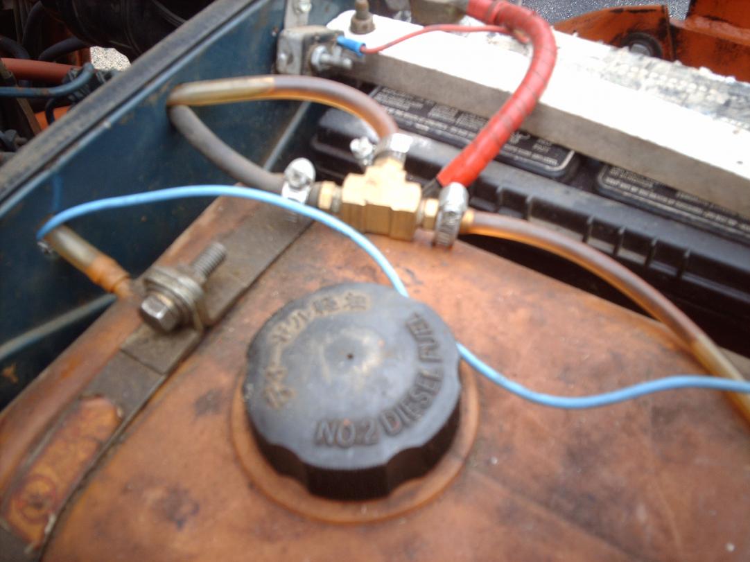

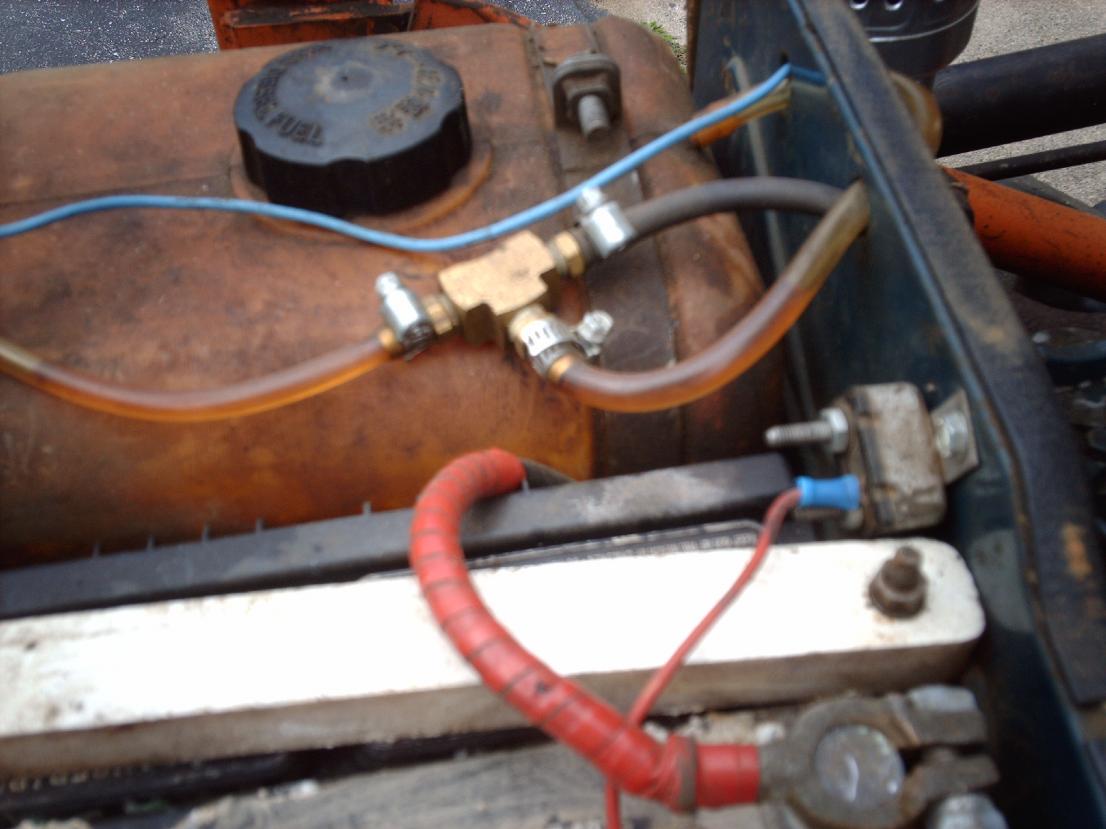

On my B7100s I put a sight guage. Install a T fitting just before the fuel filter. Put another T at the top of the tank on the return line. Run a piece of clear fuel line between. Now you can see at an instant the level of fuel in the tank.

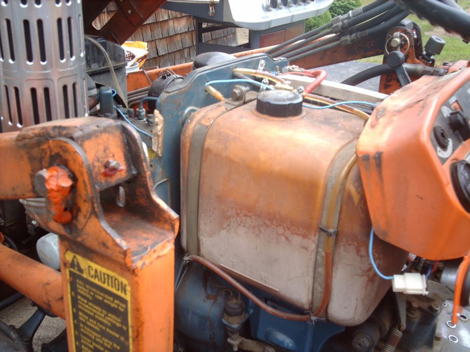

Here are some pictures of my set up for fuel gauge. Low Tech but it works good. You can see the fuel level easiest when I have off road fuel with the red dye. Sorry the first picture is of the T before the fuel filter, however is not very clear.

Kubotasam, thank you very much for the pics!! I completely understand now. Yes, I need something like that. Simple but very effective.

The photos of the fuel tank "Kubotasam" posted is the same tank as mine and many others.
