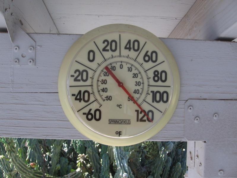

This is from a couple years ago, it's on my covered patio off the back door, NOT in direct sunlight, white roofing, shaded by a tree. It's actually hotter than that, but the needle is against the peg.
10,111
6,938
Holy smokes Bill, that puppy is pegged! :eek:
Ugghhhh….
I've always heard "but it's a dry heat", but geez, I don't even cook my steaks that hot...about 115 or so ....:p
