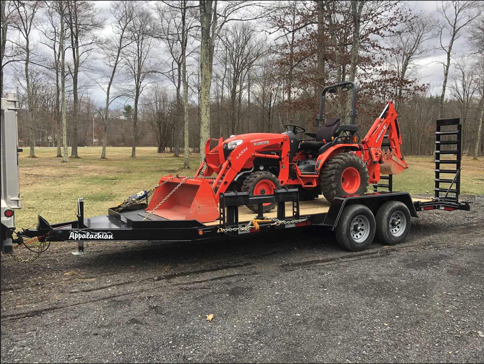

Unless I missed something in you description, why would you be considering a 14K gvwr trailer for an LX tractor? That's waaay overkill. Is the 14K required for the tilt deck?
I'd also suggest that you look for at least a 20 footer. Your LX with a sizeable rear implement (like brush cutter or landscape rake with gauge wheels) will use the entire 20 foot deck length.
Since you're in PA, I would encourage you to take a peek at Appalachian Trailers. See them here: https://www.appalachiantrailers.com/
Appalachian also has tilt deck trailers...for much less that what you were quoted. Give them a call.
I got a 20' 10KGVWR contractor grade trailer with ramps, spare tire and pallet fork pockets for $5,700. It's been a great trailer thus far.
PS - the rating on this trailer is 10K, so you could tow up to 8,500# with a sizeable load (1,500#) on the hitch.

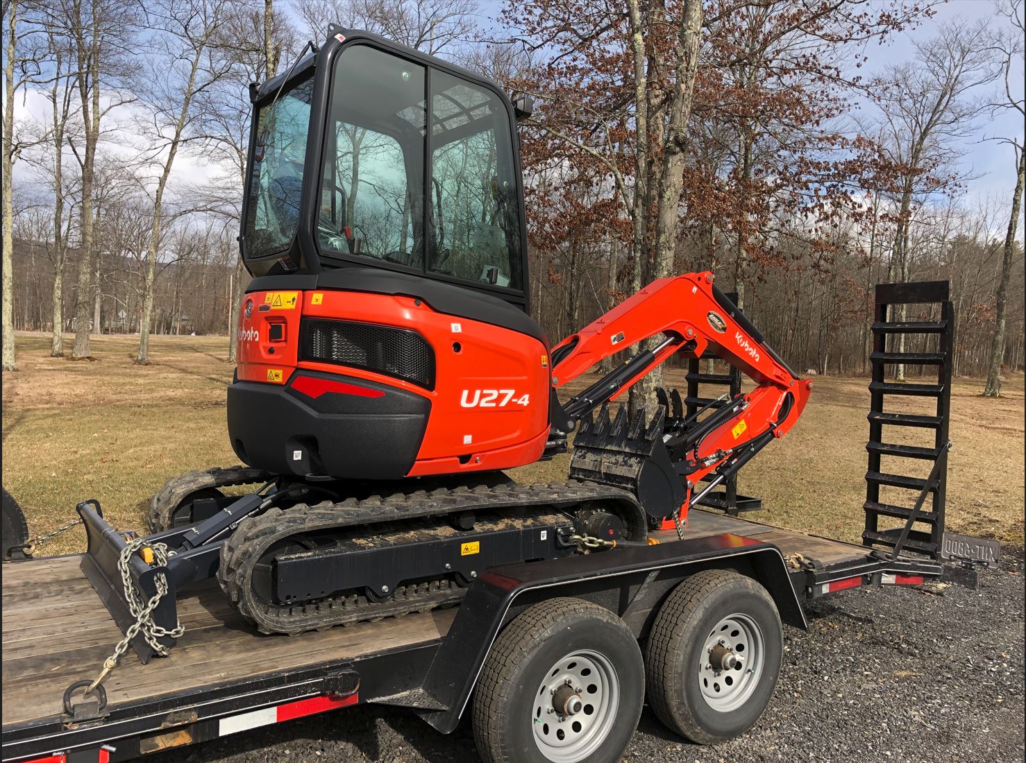

same trailer with a bit heavier machine....towed like a dream
