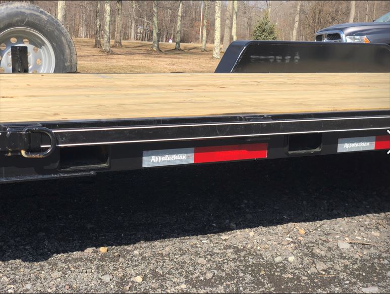

Ok. Let me clarify. They are fork carriers/holder. They cut a slot thru the frame and install tubular steel so you can keep your forks on the trailer....see the two slots in the first pic below.
edit: honestly, now that I think about it I'm not sure if they can do that with a tilt trailer????
I do wonder how that would work with the lift cylinder.
Ah, I see. That would be nice. I'm not sure how it would work, but found a video of guy welding on some to a tilt trailer, so I guess it can be done.
, Although it looks like this is a split deck and the forks are over on the stationary side.
I don't have a need to lug pallet forks around, and if I did they'd be on the tractor, but I like this trailer upgrade for the cool factor if nothing else. It's a very easy upgrade too if you have the ability to cut and weld steel.

Interesting... there are all kinds of stake pocket accessories. I guess they are good for more than just for adding sides to the flat bed.
I bought six stake pocket D-rings that work very well. I got them from the trailer dealer where I've bought three trailers. They were $9 a piece a couple of years ago.

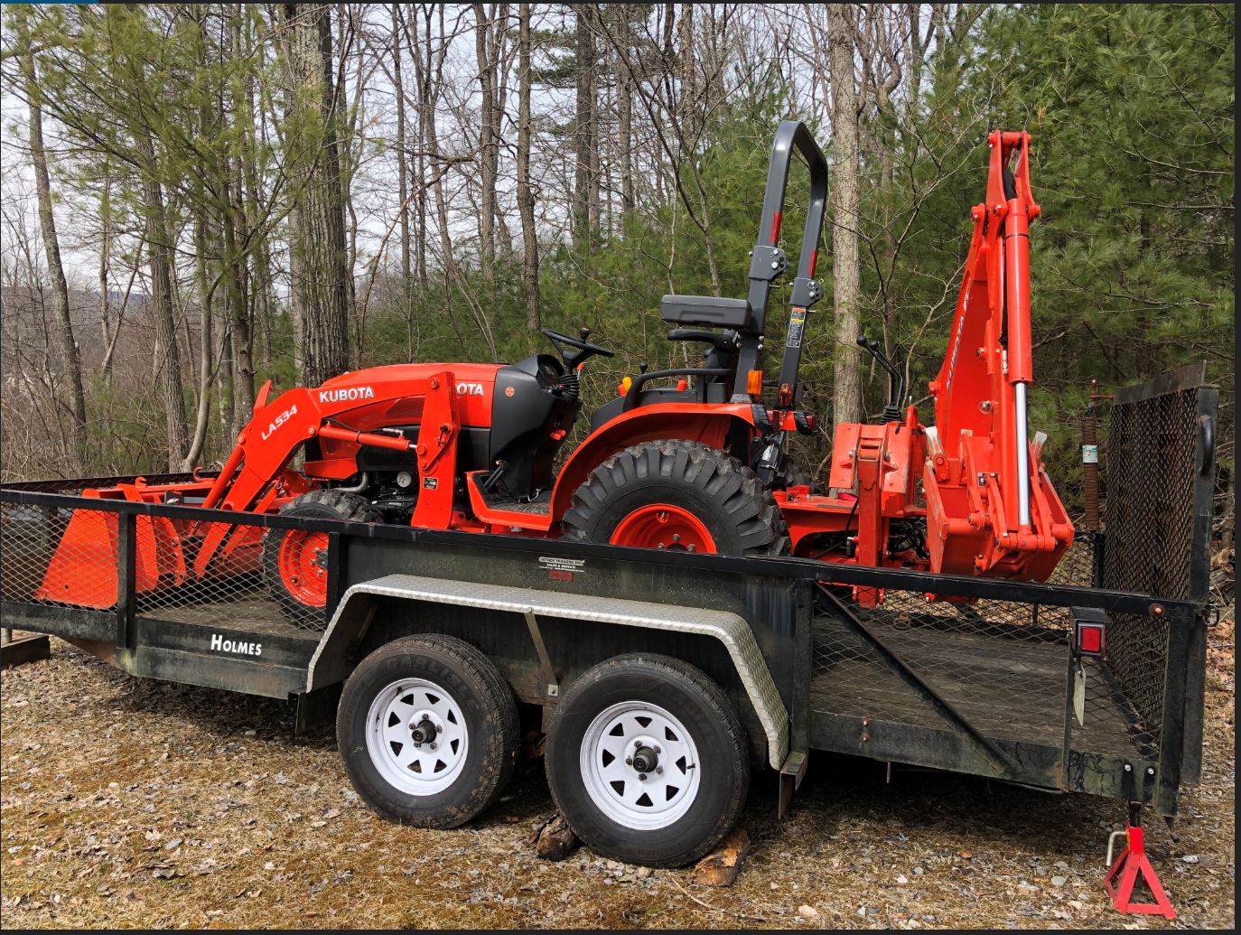

Regarding trailer. Get the 20' 10K with fold down ramps (should weigh in approx 2,500 lbs) Then add a spare and some chains etc and you're up to almost 2,800. The 20 footer is necessary for any long rear implements. I can just barely fit my tractor with landscape rake and gauge wheels on my 20 foot deck. The longer deck also gives you some wiggle room to position your equipment on the trailer with the right amount of hitch weight that you may want.
I can get my machine (same as yours) on my 16 footer with the hoe turned sideways or with a box blade on it. There's no way the landscape rake would fit.
B2650 with hoe on 16 foot 7K landscape trailer...

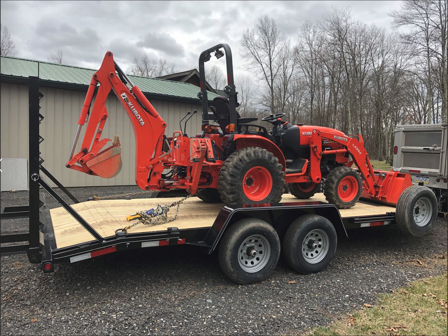

same machine on a 10K 20 footer...
I'd suggest passing on the slide in ramps or you will need to use jacks or blocks to keep the ass end of your truck from lifting.
max weight on my trailer would be 8,500 with 1,500 on the hitch (my dump can handle that without issue).
IMHO that trailering setup would really be better with the hoe bucket sitting on the trailer deck.

In Ontario ,both buckets must be 'secured' with strap or chain...
Maybe so in your neck of the woods. But, that's why the manufacturer makes them with transport locks.
YMMV

Well the bucket isn't locked... it is possible(yeah snowball's chance in Hell ) that all the pins securing the bucket to the BH will ALL fail at the same time and the bucket could fall off the trailer.
A strap would prevent bucket from falling off the trailer....

Jay, let me try to shed a little bit of light on this for you. The backhoe is equipped with a transport lock for exactly this reason. You do not need to chain the backhoe (hoe) to the trailer deck if the boom lock is engaged. It's in the regs. Not sure about you all above the 49th? But here, boom lock, no chains.
However, the reason that you see larger backhoes being trailered with the boom lashed to the deck (not using the boom lock), is because they can't utilize the boom lock due to height restrictions. The boom to dipper joint is well above the cab/canopy on larger machines. They'd be whacking underpasses and taking out those lovely roof structures at fill up stations.
e.g. it has a boom lock but would likely be too high sitting on top of a trailer.
I would agree that if possible, you're best to lower it and chain it. However, I've found that trying to chain a bucket to the dove tail section of a trailer is sorta pointless. I'd say 8/10 times, that chain is loose when you get to your destination. At least that's what I've found when binding an excavator bucket with Boom/dipper at 90 degrees and bucket on dove tail. It simply doesn't work.
Hope that helps.
