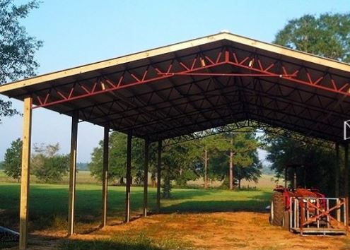

I haven't checked on my posting in while - so to finish up, I will assure you that these trusses are engineered.
I have stamped engineering drawings and those meet the Florida Building code (probably other States too).
When I say i am "assembling" the trusses, I mean I bolt the two sections together (each section is about 19 feet long). It would be difficult to ship a 38ft steel truss in one piece.
then the builder (me) has to set the trusses on the Posts and ties everything together.
Note the "steel trusses" in the photo. They bolt together at center. But the actual truss is built/welded in a jig by the manufacturer.
