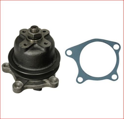

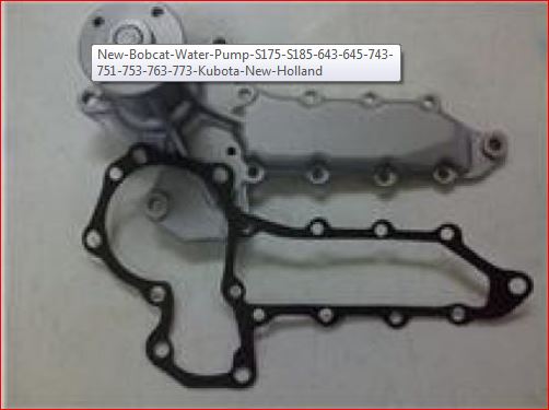

I am surprised at the cost of either of those pumps that NIW pulled up....
I thought they would be twice or three times that !!!!
I would jump on and "get 'er done" ..........bad things and $$$$ things happen to overheated diesels......
