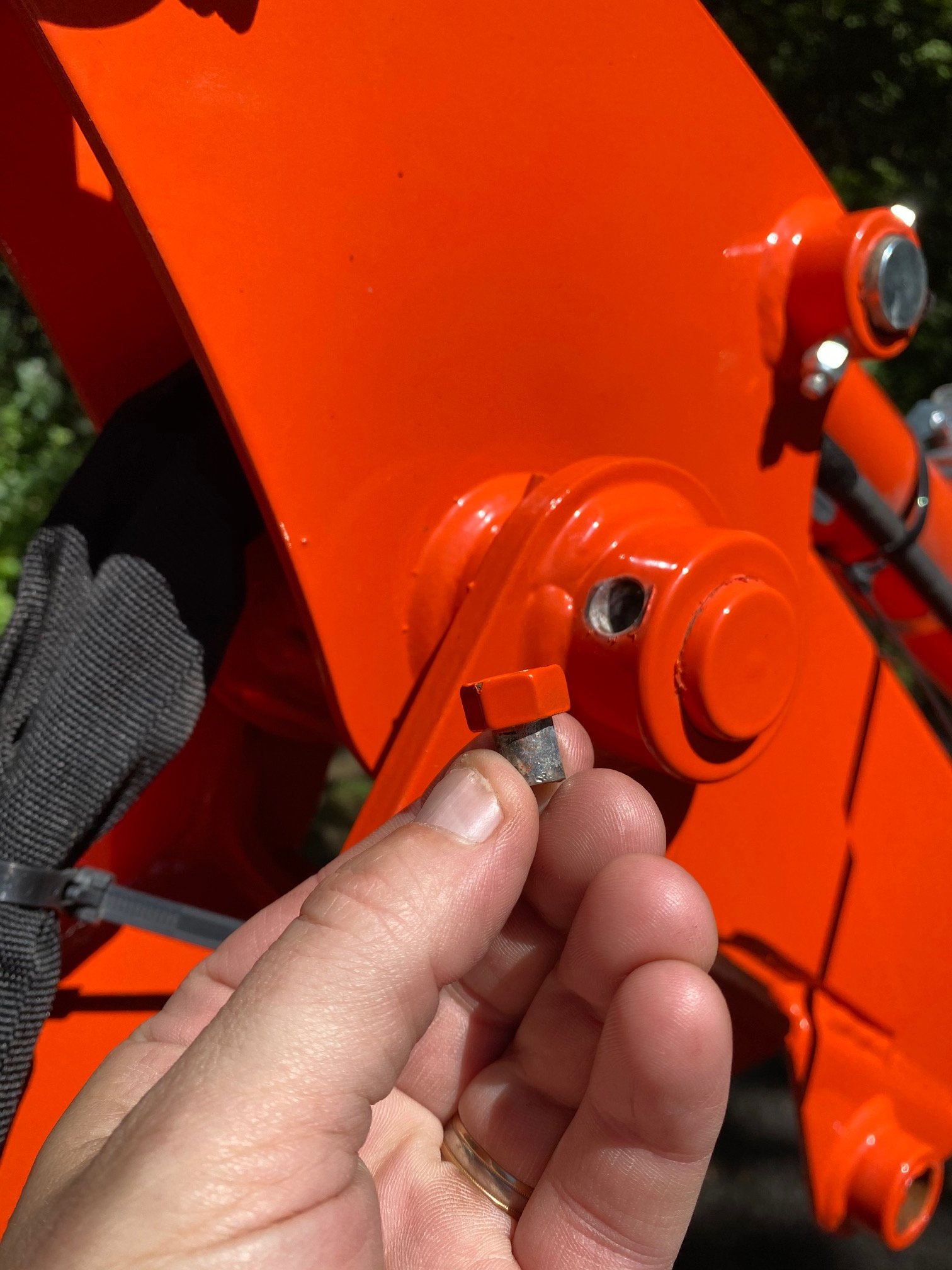

I was all excited to know that the o-ring issue was not a big deal so I went out and was playing around getting used to the backhoe. I was letting my son run the controls for a bit and I notice an orange piece on the ground. Low and behold its a bolt head and for sure from the new unit. I was able to find the spot where it came from. There is no way that should have happened from what little i have done with the back hoe.
I was looking and it seems they may have forgot to grease that pin. All the other grease fittings were new and the one on this pin was solid orange, no way grease is getting through that. I noticed that i cannot see any grease coming out anywhere on that pin like the others. The arm seems to be all the way to the left so much that the square spacer wont turn.
I went and purchased some fittings and replaced it, and a new bolt. Now when I test it, there is a noticeable spot where it makes a click noise and seems to hang up on something.
Am I on the right track here or should I be looking for something else? I am thinking it needs to go back to the dealer to be looked at.

Maybe. You did grease it until grease came out both sides? Book says grease every 8 - 10 hours, right?
11,060
2,976
First thing I see .....there is NO grease on the zerk as you mentioned .
Lack of grease would and could bind the two pieces of metal and caused the pin to pivot.
I have a friend that bought a used Kubota .....about 500 hours and one of the pins in the FEL had NEVER been greased - rather the grease never got to the pin..... it took an hour to get THAT pin to move and to take grease! And that awful noise went away too! ;)
Looking at the bolt - is seems that it was sheared, snapped at the depth of the pin where meeting the boss. I would look down that hole and see if the hole is STILL lined up with the two holes on the outside of the boss.
And as you mentioned.... take it to the dealer - IF they forgot the grease....then THEY can replace the bolt...and the pin... and anything else!
I would really press the dealer on the fact that IT HAS NOT BEEN greased..... and do not let them say it has ........ once that pin is tapped out, it will be clear that it does not have grease on it. AND if the pin spun - IT too needs to be replaced, and well as .... the whole assembly if need be ( that click noise!!!)
DO NOT let this deter you.... one small overlook happens sometimes, but you will find this machine to be a beast and can do almost anything.... even if one small bite at a time!!!!
Let us know how this turns out!

Thanks for the response. I already replaced the bolt and fitting and greased it, but the pin still binds and I still hear the noise so I am going to stop tinkering and have words with the dealer.
Looking it over a bit more, there are multiple fittings with all of the powder coating still on them. the very lower part of the main arm appears to not have grease either.
@ potreeboy - I did grease it after replacing the fitting. The tractor was NEW, although it did have 1 hr on it when delivered, so I did not think I had to grease it. I could also see grease on many spots so "assumed" it was good.

Seems odd to me that the pin, zerk and retaining bolt/nut appear to be painted over. I’ve never seen that on a new machine.
Yeah, I noticed that. Seems like an error at the factory.
Regardless, I agree it needs to go to the dealer. It's never a good idea to repair something on a brand new item. You may have voided any warranty. At the very least, you have clouded the issue of who is responsible for what.
But at least you have the photos. I'd get that thing back to the dealer right away.

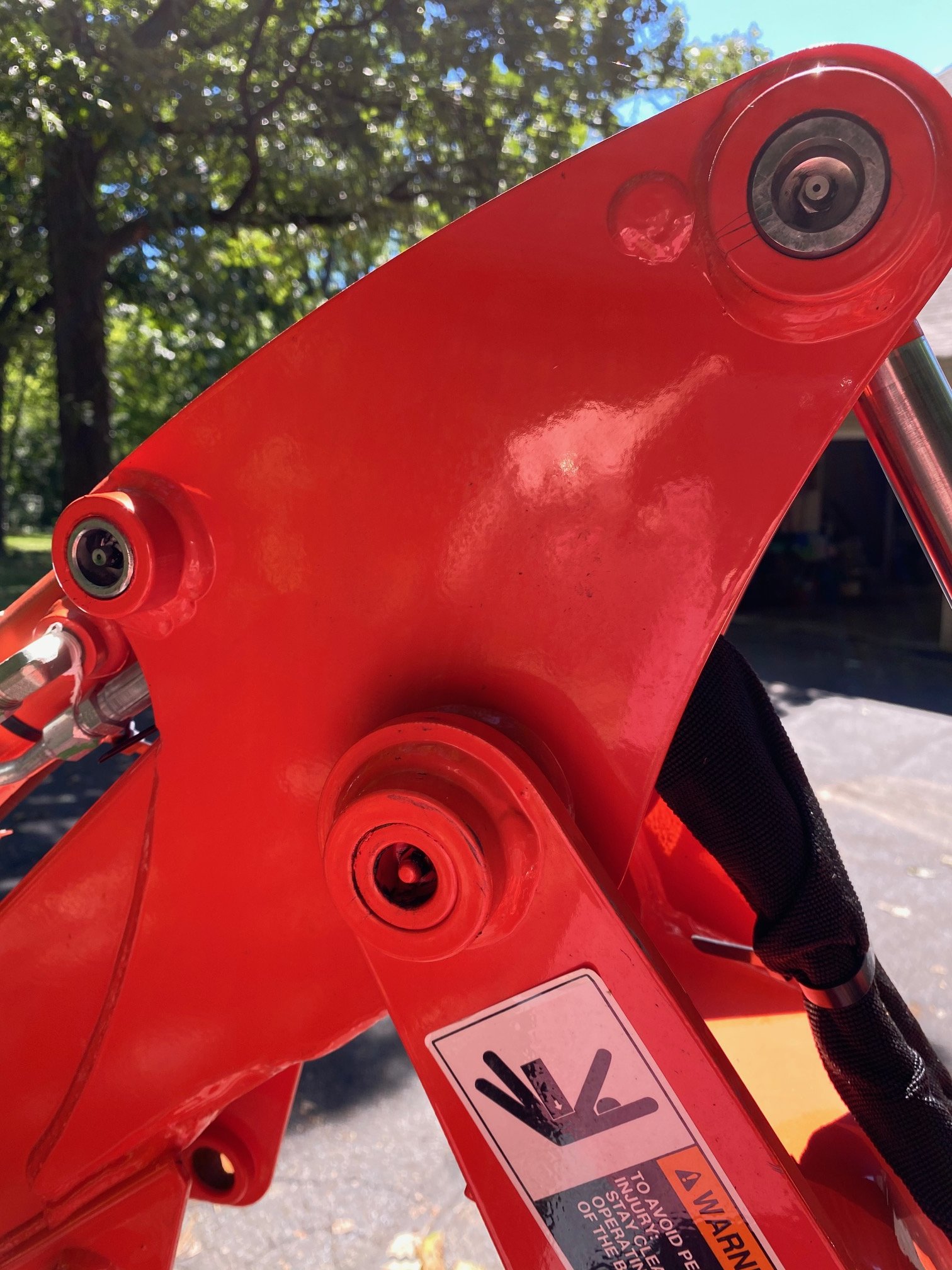

heck I don't see ANY grease on the 2 clean zerks/pins in the first picture ! I ALWAYS leave some grease on them from the gun,even after putting a cloth in there, SOME grease remains. As others have said , grease should 'ooze' out of BOTH sides of the pin and between the 'moving parts'.
I'd carefully inspect ALL the zerks INCLUDING the one under the floorpan mat. Be sure to scrape off all paint on the zerk surface, wipe with clean cloth, then 5-10 squirts of grease and SEE that it 'comes out the void'. Use a rag to remove the old grease.
The painted zerk probably means the plastic cap used to cover it during the painting process fell out,sadly never caught during inspection. It SHOULD have been caught at the dealer, during 'prep' as that's WHEN grease is added. From the factory, I suspect there's NO grease in any of them.

Ok this is my second time addressing this. Greased everything the first time and seemed to get the noise to stop. Second grease attempt today was only able to get grease to come out the far side of the pivot pin. Can't get any grease to come out of the zerk side of the pin. Dealer said I needed to have the arm under load as I moved it around while applying grease. Did that, 150lb rock No change.
Without the bolt in place you can see the pivot pin bind and actually close the hole off. Seems like you'd need to push the pivot pin out enough to clear the first channel but I don't know how far you could go without risking pushing the pin out. I imagine it would be a major PIA to get it lined up if you pushed it all the way out.
Anybody really know how this zerk system works? I thought it was a simple channel groove with holes to let the grease push out where needed. Clearly something is plugged up somewhere.

I had the same issue with trying to get the grease into that pin after the bolt sheared. It took a small amount then I couldn't get anymore to go in.
The dealer called me back yesterday, they did seem concerned and did not question me (probably because i included pictures) and came out and picked the unit up. I included the parts I replaced, and luckily I still have a ton of pictures of everything prior to me trying to get it greased. I also explained the noise/stutter issue, so we will see if that is fixed as well.
I will update this thread and let you know what happens. I already miss it as I look at this pile of rocks that were delivered yesterday afternoon...
After this happened, I looked over the entire machine and there are a NUMBER of those zerks still in..... I took pics of all of them to prove there was no grease coming out as well as to show the nipple was clearly clogged.
They have the unit back as I type this, so I will update everyone once I hear what they are going to do. The only thing I thought about after it left, was mark the parts somehow to "know" they were changed...
