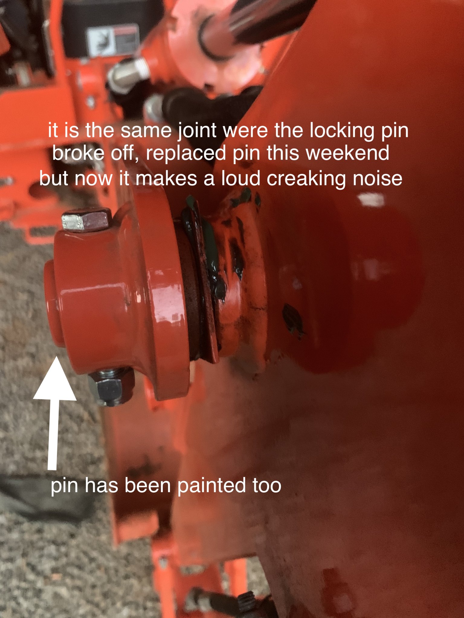

I was all excited to know that the o-ring issue was not a big deal so I went out and was playing around getting used to the backhoe. I was letting my son run the controls for a bit and I notice an orange piece on the ground. Low and behold its a bolt head and for sure from the new unit. I was able to find the spot where it came from. There is no way that should have happened from what little i have done with the back hoe.
I was looking and it seems they may have forgot to grease that pin. All the other grease fittings were new and the one on this pin was solid orange, no way grease is getting through that. I noticed that i cannot see any grease coming out anywhere on that pin like the others. The arm seems to be all the way to the left so much that the square spacer wont turn.
I went and purchased some fittings and replaced it, and a new bolt. Now when I test it, there is a noticeable spot where it makes a click noise and seems to hang up on something.
Am I on the right track here or should I be looking for something else? I am thinking it needs to go back to the dealer to be looked at.

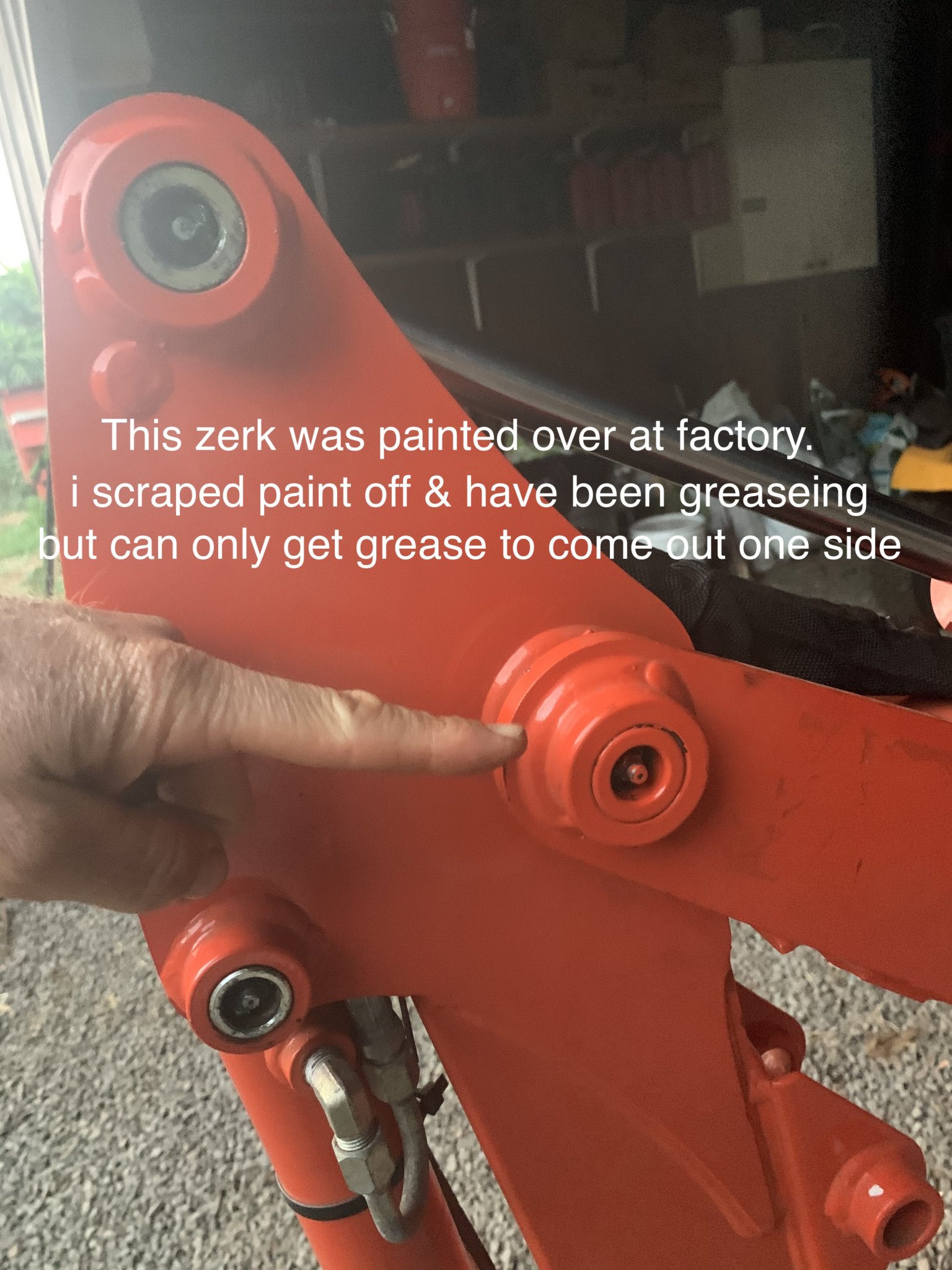

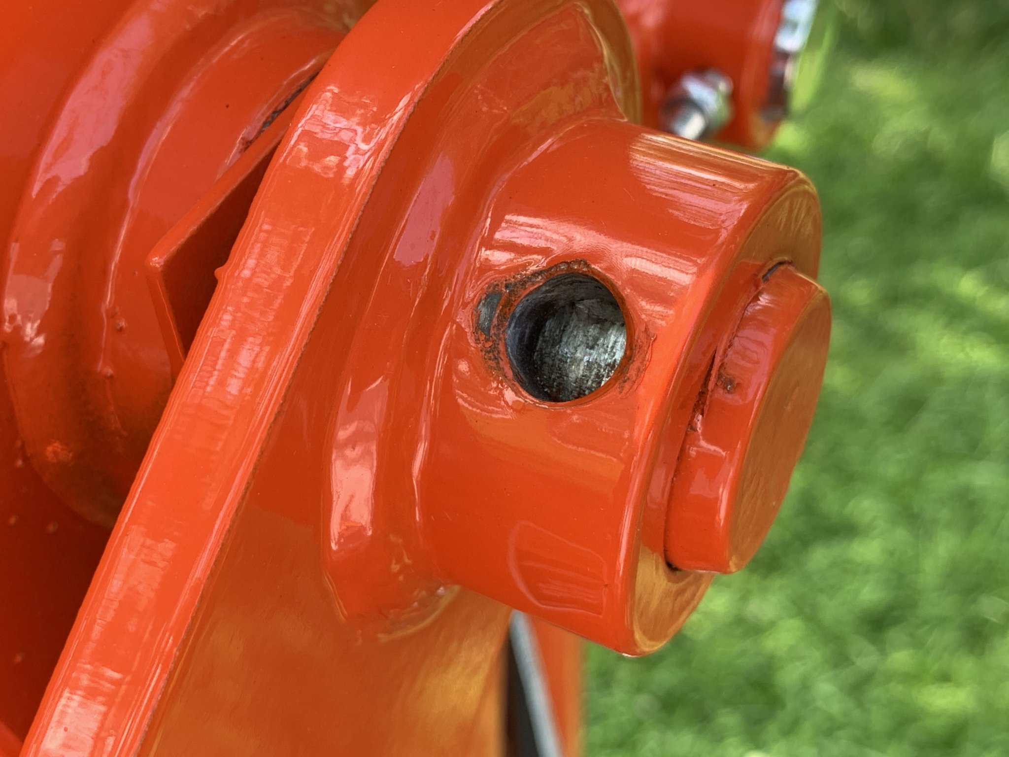

Many zerks were painted over upon delivery. Scraped paint off but that particular pin/joint on backhoe where your bolt sheared, that zerk did not want to take grease. Figured it was a bad zerk, but after pushing grease with gun while arm in different positions, I finally got it to accept grease, but like yours - only to one side (zerk side is dry).
2 weeks later my rep from dealer dropped by my farm to drop off some gear and he noticed a missing bolt - SAME SPOT AS YOURS. Same pivot point where the zerk didn't wanna accept grease. It musta sheared off. Embarrassed to admit it but I probably never woulda noticed it as it's my 1st tractor & am just learning.

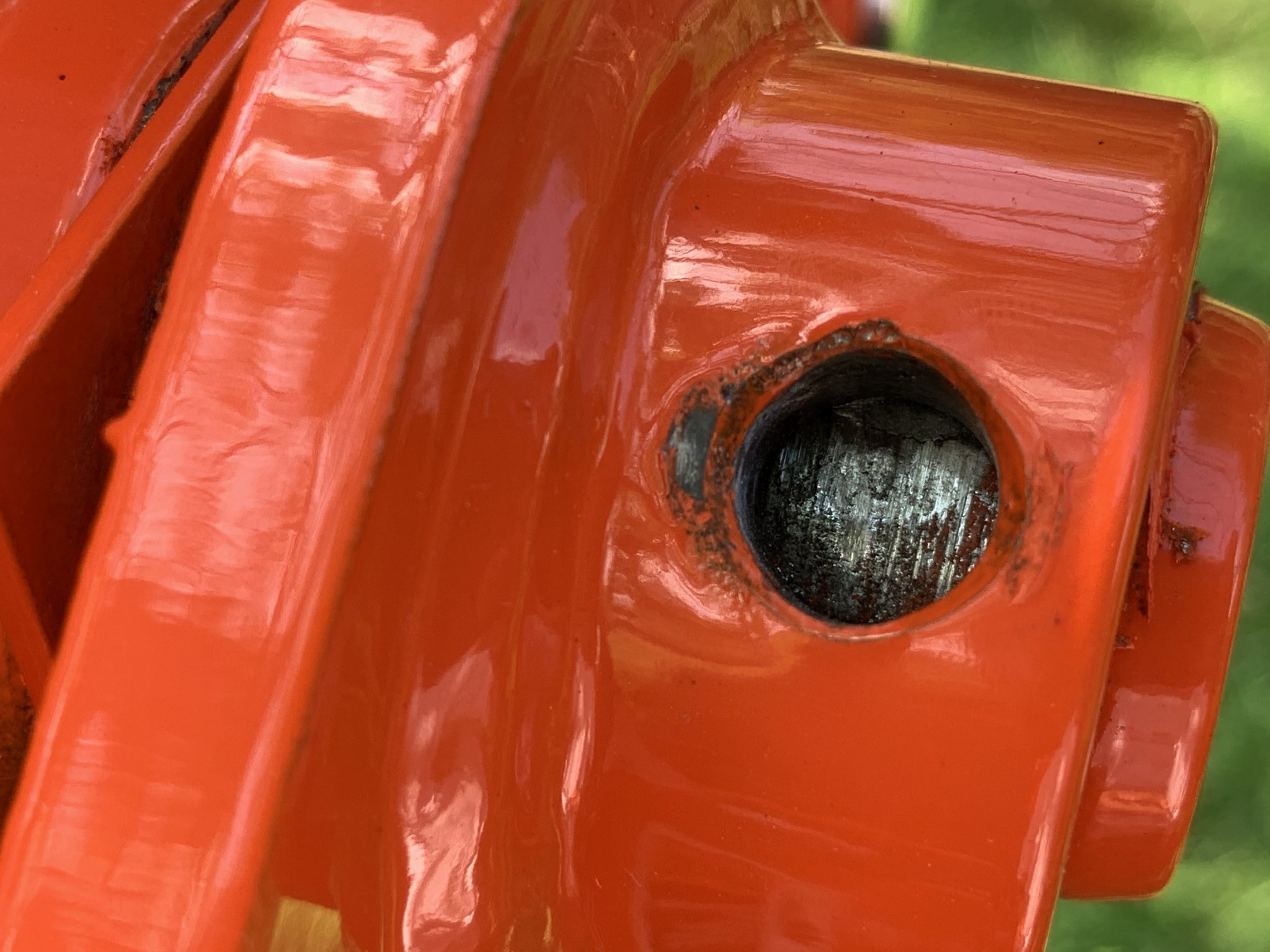

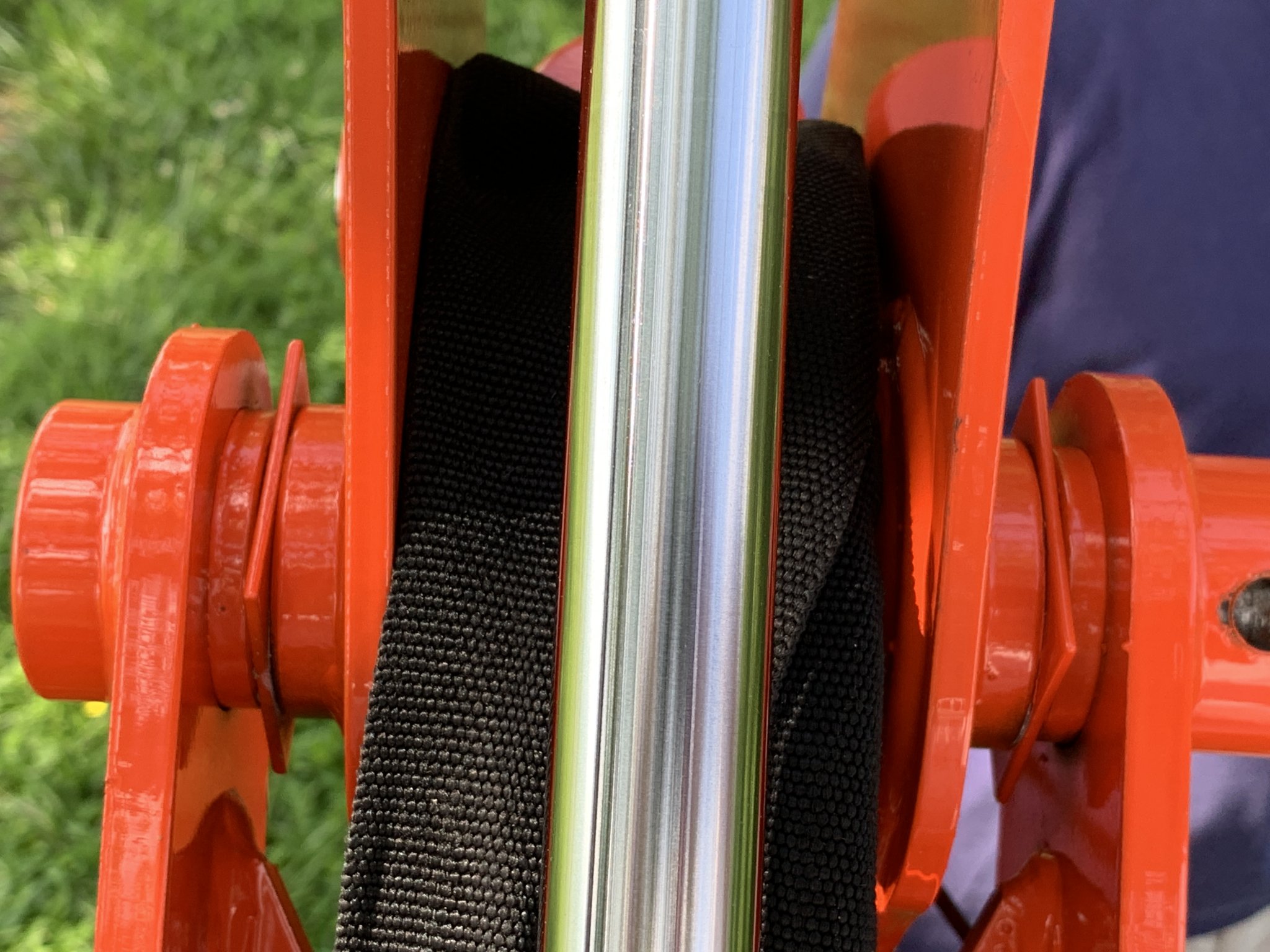

Hightailed it to hardware store, bought bolt/locking nut which matched missing one. Extended the backhoe arm out to point where holes line up, dropped in my new bolt. Man! Upon operating that joint it made a loud creaking noise, not good! Musta been pivot attempting to spin for first time ever, but DRY! Put grease gun to work, it took (but again only on one side). Zerk side still dry, half of the pivot has probably never had a drop of grease in it. Fail on Kubota, dealer and myself.
Took these photos & sent to dealer. Their advise - WD40 into joint, keep greasing & using, that it should in time work itself out. If not I'll order a new pivot & replace.

Hightailed it to hardware store, bought bolt/locking nut which matched missing one. Extended the backhoe arm out to point where holes line up, dropped in my new bolt. Man! Upon operating that joint it made a creaking noise. Must have been that pivot spinning for first time ever. I remembered that was where grease was needed. Put grease gun to work, voila! It took :) Apparently the position where the locking pins go "loose" are the best position to apply grease. Makes sense. Made 2-3 passes through position where it creaked and noise went away. Poor pivot probably never had a drop of grease in it.
[/QUOTE]
Just make sure grease is coming out of both sides of the pivot. Those square things on the pivot arm are spacers and grease should exude from the pivot pins there. My problem was on the zerk side of the pivot. Grease was pushing through on the opposite side but somehow plugged on the zerk side. I did grease it while move the arm but not in in the free position. Have to try that next. Even bought one of those fancy zerk locking tips for the grease gun. Freed me up to move the arm and apply grease. Still having a problem getting grease to come out of the zerk side. I'm not sheering bolts anymore after a trip to the dealer.

Took a closer look at my machine today, no grease coming from my zerk side either. Apparently we are having exact same problem. Only joint on whole machine having this problem. Took these pictures & sent them to my dealer.
My dealer tech had to pound out the pivot pin with a small sledge hammer. It was really tight. Replacement pin was so hard to get in he had to take a grinder to loosen the fit. Then still really had to bang the pin to get it in. I probably should have had him take pics of the inside but I was trusting him to know what he was doing. This is not a Lexus precision machine and this approach didn't seem out of place. Probably a wrong assumption. Lower arm didn't fall off the machine without the pin in. Not sure why. It did seem to let grease through at the dealership at the time of replacement. Not so much now. BUT no noise, no bolt shearing and seems to work fine.
Did you say you had scraping noise when the arm moved? I did until it sheared the bolt (both ends). Oh yea, when it was shearing bolts my pivot pin seemed frozen on the non zerk side. Strange because that side was getting greased properly. It was the zerk side that was grease starved.
I doubt it will be fixed by simply replacing the pin. I couldn't see into the cavity but the tech had said something was "pinched" and needed to be ground out. Old pin showed much more wear on the zerk side. See my pic on previous post. I really don't think the pin needed replacement. It was not the problem. Zerk fitting worked fine once the paint was scrapped off and the pin is so hard that it will probably outlast the joint itself. In the end I got a new pivot pin installed and no noise. The scraping noise was pretty loud, hard to not notice.

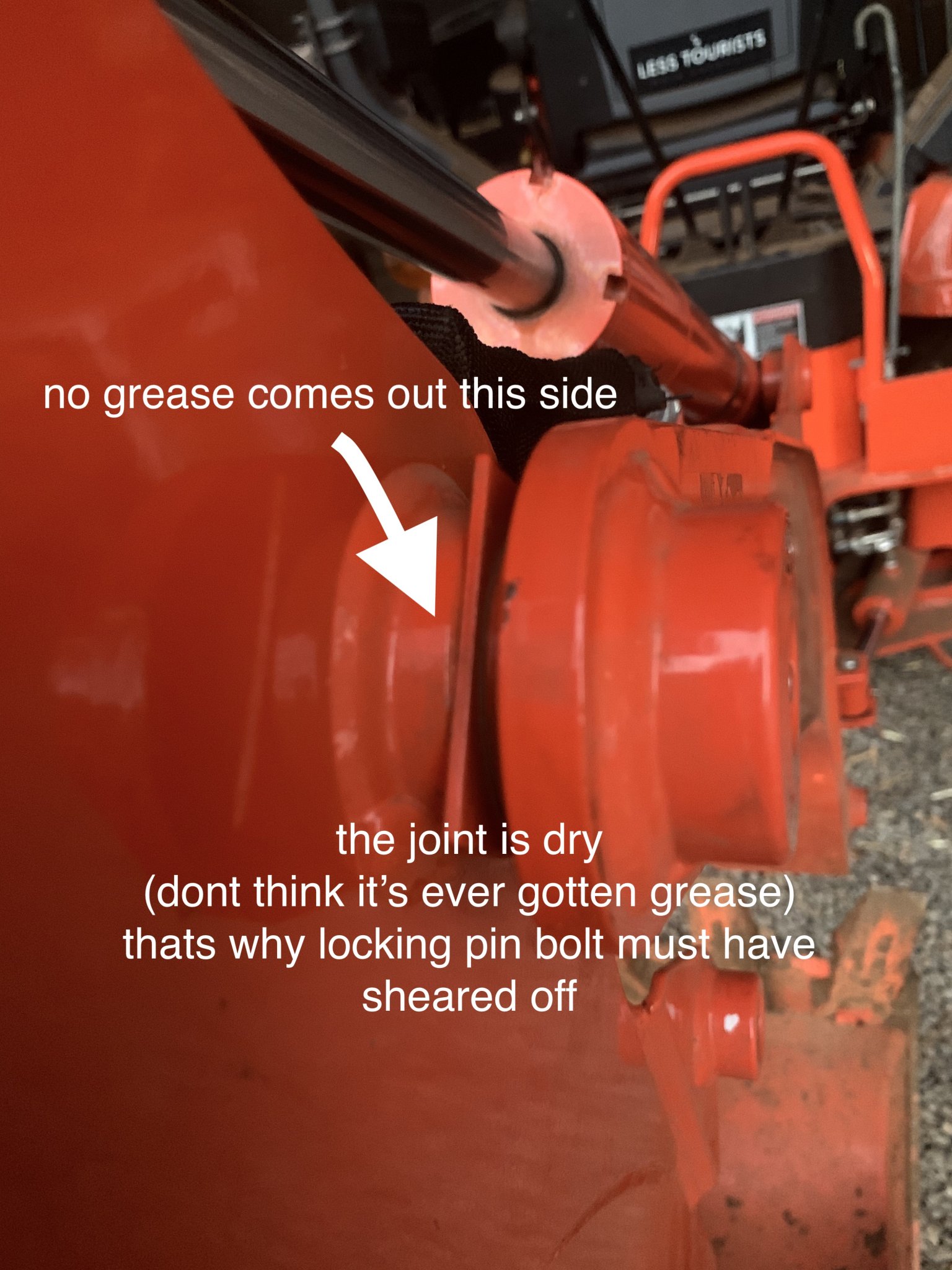

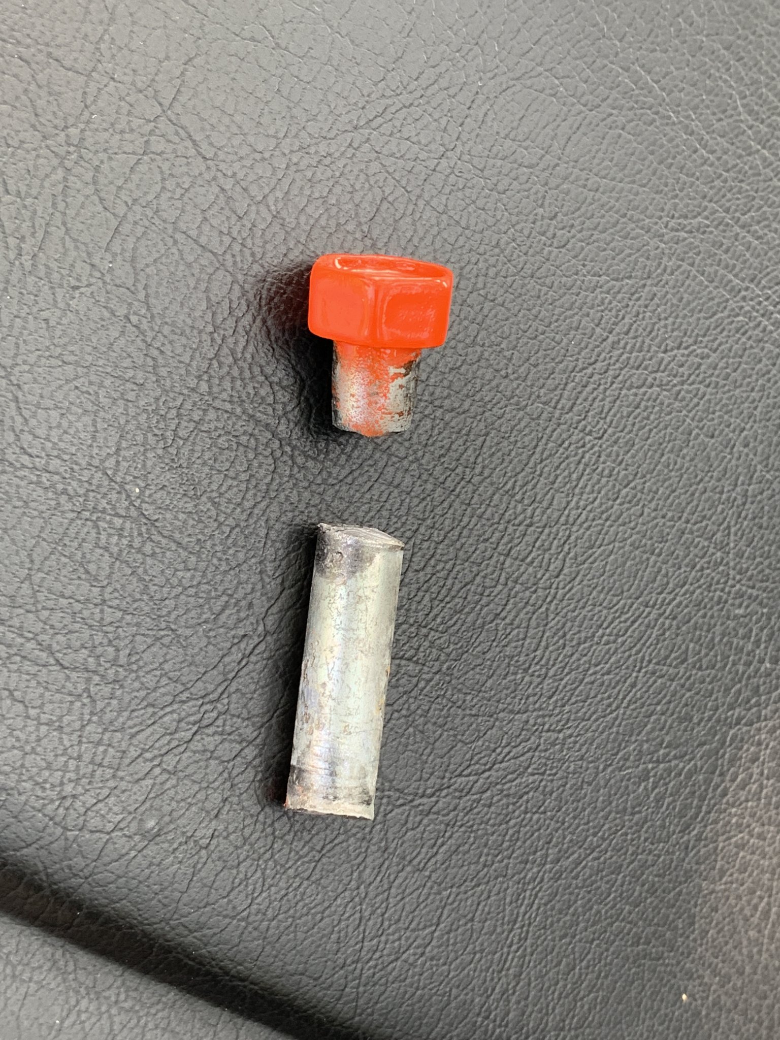

I just got my first tractor ever, decided on a BX23S because I just don't need a bigger tractor, but do need the ability to do some light trenching and digging, so it's a good fit. Waited three months for it to arrive and I was finally able to pick it up Tuesday, July 6, 2021.

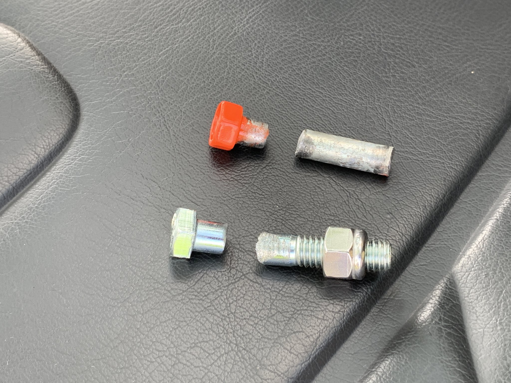

Fast forward to today when I was actually able to do some work with it. I was digging around a couple of stumps from some small bushes I had previously chopped down. As I pulled the backhoe in I saw something orange pop off and land under the tractor. Seeing that there was a fresh hole where there hadn't been before I shut everything down to investigate.
Just like others I found the pin was seized up and sheared the bolt off. Thinking at the time that it must have been a faulty bolt, I got another one and dropped it in. As soon as I moved the backhoe out, it popped the new bolt. When I looked in the hole I could see that the pin was scored.
A little disappointed that at just 4.5 hours this thing let me down. I hope it isn't a sign of things to come.

I don't see ANY grease around those square shims !!!! There should, no NEEDS to be grease 'oozing' out from there,BOTH sides. Buy a new grease gun, 6 pack of tubes,locate every Zerk, put 6-10 shots in everyone, then to 'full extension-retracts SEVERAL times for every function. Be sure to add 2-3 shots to the SSQA latch lever Zerks as well.
I have a dedicated 'Kubota only' shelf..filters, grease, gun, etc. ONLY Kubota stuff..

Make sure that you guys are not fully tightening those keeper bolts holding the pins. They are meant to be slightly loose with like a 2-3mm gap between the bolt and the backhoe pin boss. They should spin freely by hand.
Thanks for the tip. This is my first tractor and I read the manual from cover to cover, but the grease coming out near the zerk fitting made me think there was enough grease. The dealer is picking it up on Thursday to fix everything. I'm thinking that they are going to find some of those other pins aren't properly lubed either. I have a ton of work lined up so I hope things aren't too screwed up.

Maybe. You did grease it until grease came out both sides? Book says grease every 8 - 10 hours, right?
The zerk for the dipper pin on mine was painted over. Removed fitting and then the paint on the fitting. Put the grease gun coupler on it and gave a few squirts to make sure it was working, and it was. Reinstalled the zerk, but it wont accept grease. No oozing out on either side. Still clean factory orange. HELP!
Try moving the dipper to different positions, and see if you find a position that takes grease. You might even have someone slowly move the dipper as you keep pressure on the grease gun...
Moving things has helped me in the past to get stubborn pins to take grease. Worth a try...
