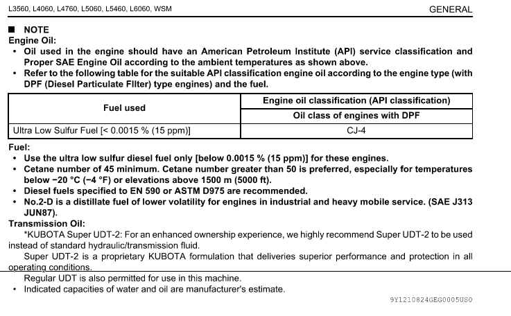

So I'm responding to a previous comment I made regarding fuel. I stated it was in the Operator's Manual but it's actually stated in the Workshop Manual. I know I read it somewhere. Bottom pic clearly states ULSD ONLY. This only applies to tractors that have emissions.
