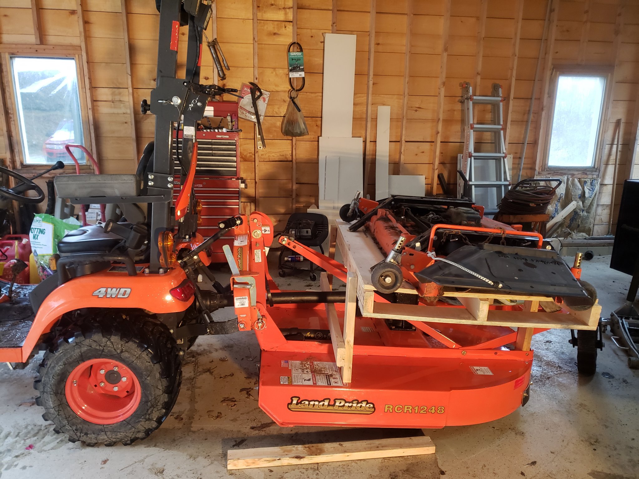

Bigger 60" 478 lbs. wagging around on back of B may require a load of dirt in the bucket ?
I have my loader off hauling firewood with carryall the front end is light. I have tractor ready for new test the MMM deck is off for seeing how will behave. My gut says I won't be hauling much with no weight.
10,339
7,383
Just for what it’s worth.... my carry-all weighs about 175 or so.
With my BX, I figure I can carry a little less than 300 pounds of cargo, tops, without the FEL and the MMM on....no front weight otherwise. So that puts me at almost 475, all pretty close to the lift arms.
That is tops for cargo without fronts pointing skyward...again, that’s a BX without FEL on.
That rotary cutter would hang back a ways, but the lift capacity is much better on the B, and it’s a heavier and longer tractor.
