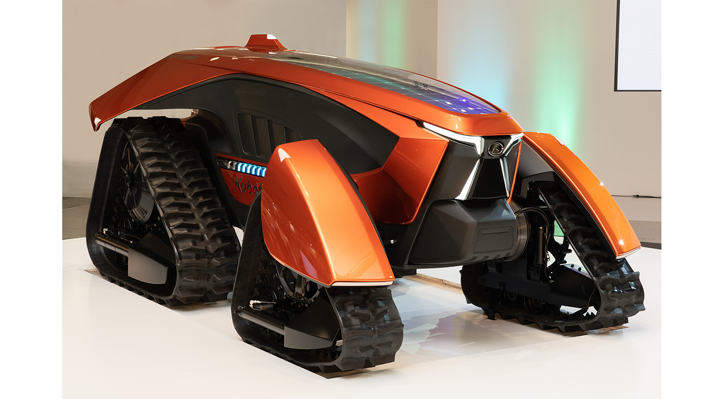

Kubota Corporation demonstrated a concept tractor at a new product exhibition held in Kyoto City on January 15-16, 2020. Half century after exhibiting its first-ever concept tractor at the Japan World Exposition held in Osaka in 1970 (Expo ’70), Kubota unveiled concept tractor to commemorate the 130th anniversary of its founding. Equipped with artificial intelligence (AI) and electrification technology, this “dream tractor” is a completely autonomous tractor that represents the future of farming drawn by Kubota. Kubota will continue developing products to realize smart agriculture with cutting-edge technology to address the challenges facing Japanese farmers. I would love to have autonomous lawn mowing.
I don’t think I would like that at all, I enjoy my tractor time to much,
6,988
4,320
Oh Boy!... more automation/technology that the mfr’r will “License” to you ...not SELL to you. That way you must take it to a DEALER if it breaks. :unsure:

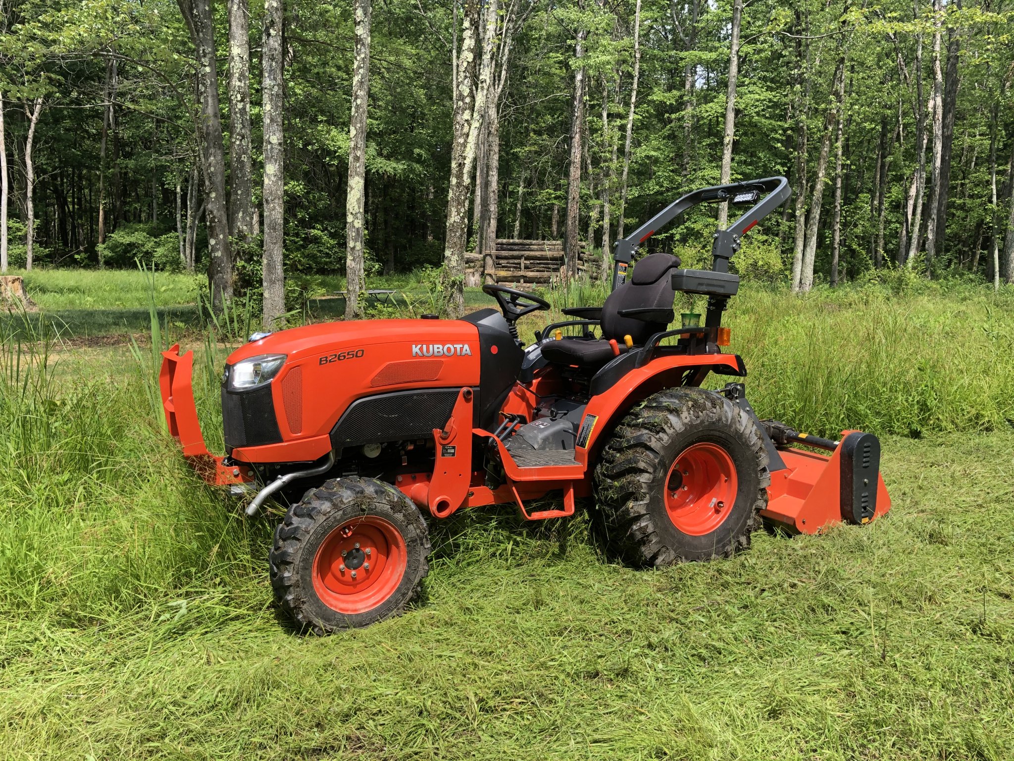

Tom- congrats on your decision. Sounds like your pasture is in decent shape, so a finish mower should work just fine. Last weekend was "weed-fest" at my place.
