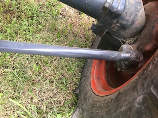

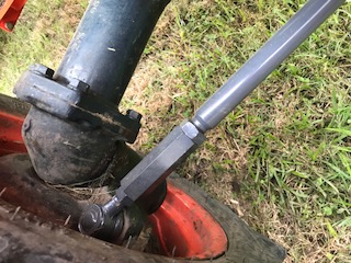

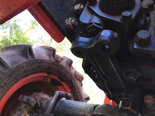

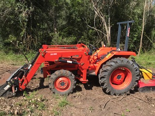

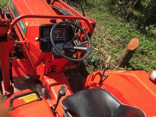

This tractor does not exist with out pictures ... :D ... :p ... lets us see the upside down tractor (land down under and all right) :eek:

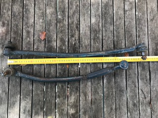

OK here's some American help. Take the broken pieces to a shop and have it repaired by welding a coupling onto it over the break. Straighten them first and check that the length is close to right (wheels both pointing straight) - then get them welded up.
Precise wheel alignment is NOT necessary - if it's close it's fine. A temporary splint could be attached with muffler clamps to get by. There's less to tractor steering than meets the eye - no need to spend a ton of money or a lot of time. Take care, Dick B

I'm with Rbargeron..... just heat up..... straighten them..... refit to check alignment...... remove....... brace them. Your good to go.
I like removable brace so if they get tweaked again you can re-heat to straighten..... then replace the tweaked brace. If brace is permanent then on next re-straighten you have lot more metal to heat up and try to bend.
Iff you have clearance for it use Ubolts to clamp on some angle iron to the rods. Makes for a good brace. Otherwise as suggested a lot of quality hose clamps along the angle iron. Ran my Jeep that way for years with angle iron and hose clamps after an in the field Tie rod repair with donated angle iron as the brace.

If the ball ends are good, then I 100% agree with everyone to just have the rods straitened and run with it.
A wood welding shop can fix you right up.
Another option if the ball ends are bad, take the ends to a local Auto parts place and see if the can match just the ends and then have a local welding shop put a new rod on it.
If it was a automobile I would never suggest this, but your tractor is moving slow enough that if it failed it not going to be tragic.

Thanks everyone for the advice - if it was my tractor (and not my sick neighbors) I might try to fix it up and make do until I really needed to replace. The Australian phrase for this is 'Ahh She'll be right, mate'. Since I am actually English an expat I have learnt that this translates to 'I am not going to do a proper job for you, but I will take your money - and lots of it!'.
I managed to get the snapped thread out of the adjustable sleeve at the weekend, so I can definitely re-use this part and the removable ball joint is looking pretty good too - just needs a new rubber boot and some grease. The fixed ball joint with the male threaded rod is 'rooted', so I will replace this. The LH part it more common and I have found in OZ for around twice the price of the us - but it will be here in 3-days, so I get the tractor out of the paddock and the elements. The RH rod snapped because the LH rod was so bent out of shape - putting too much stress on it.

Update on hard to track down tie rods in Oz.
I managed to find a supplier in Australia with the parts - they are the sister/brother company to Worthington AG Parts in the US - Neil's Parts - excellent service and a very reasonable price - if any other Aussies find this thread, hopefully this will help them.
New tie rods went on super easy and the wheels look to be pointing in the same direction. Of course things didn't run that smoothly as the battery is knackered - so I will have to spring for a new one.
