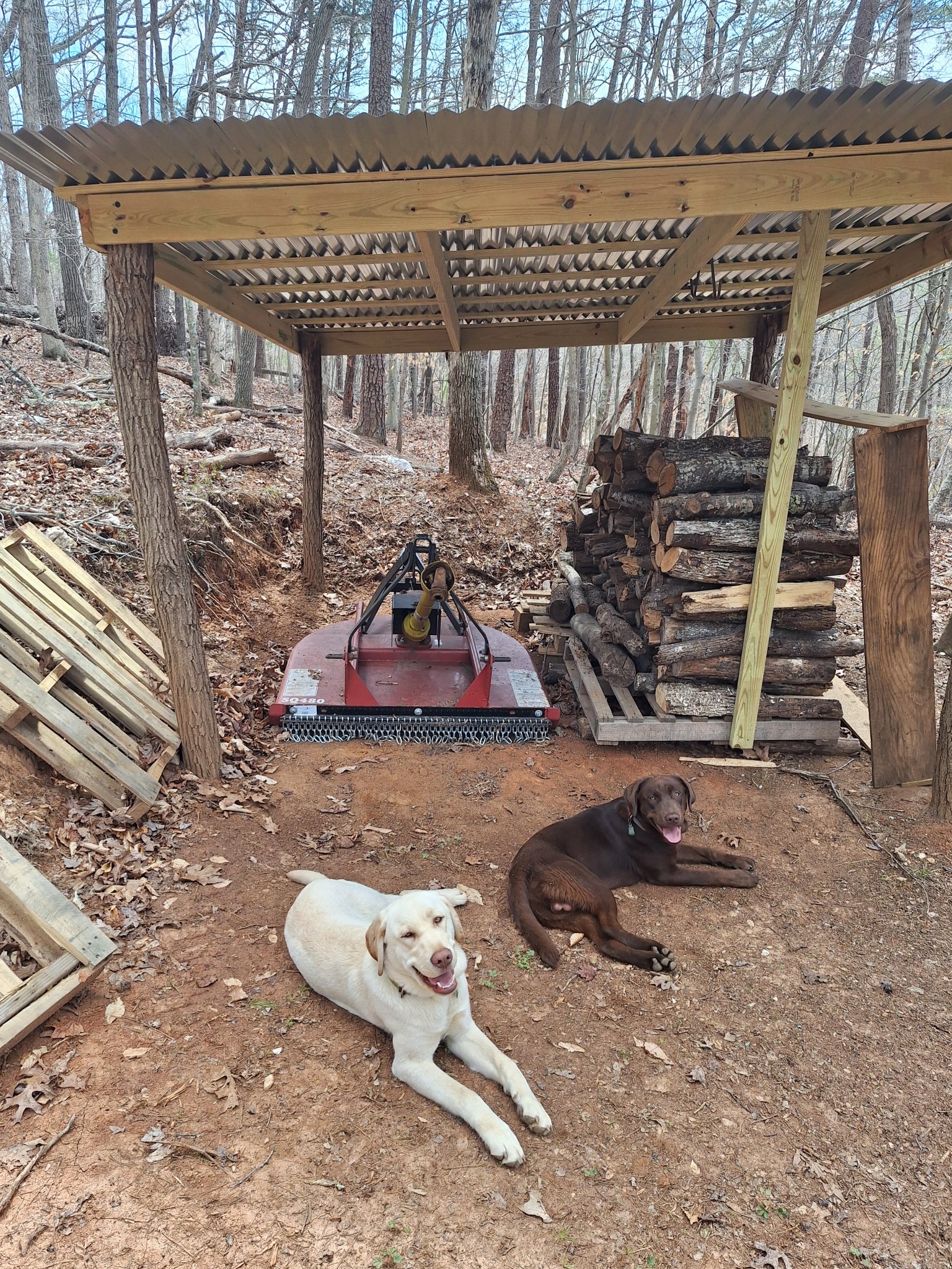

AND...don't leave outside uncovered! At least fabricate some sort of cover you can tie over the gearbox.
It is now undercover. I moved around a bunch of firewood in a shed to make some room for it. I plan to spin it up to get the lube warmer and any particles suspended and then drain and refill. I might do this a few times since gear oil is cheap. Replaced seal is holding with no leaksso I can keep the corn head grease as a backup plan .
Great looking helpers!

I would get it up on a couple of pallets so the air can circulate under it so the steel doesn't rust. Even though the ground appears dry, under the mower it will be damp.

Your "helpers" look great.
I have had both colors, but now have only white.
My Sadie is a sweetheart, as ALL Labs are!

Thanks. Tucker and Jasper are not exactly alot of "help" but they are good pups. They are brothers from the same litter and only 9mos old.
