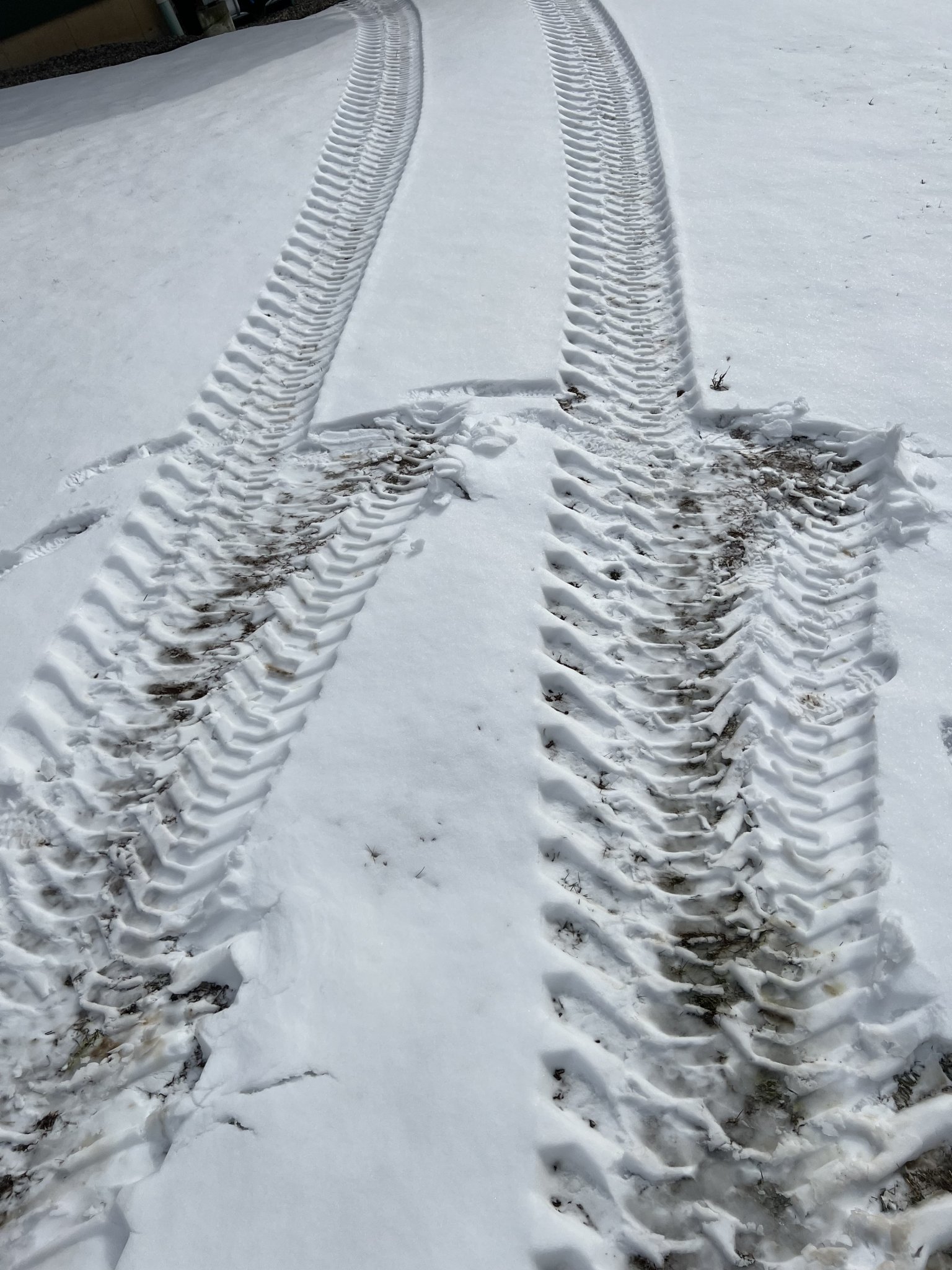

I was going to put away the Kubota after plowing this am and was going downhill that had a slight passenger side lean as well, almost made it to my destination and started the 4 wheel sideways slide. Was not playing that game. I hit the differential lock and was able to reverse out before going sideways down a steep hill. Did I mention i dont like my R4’s?
I did something similar which is why I use chains now.
